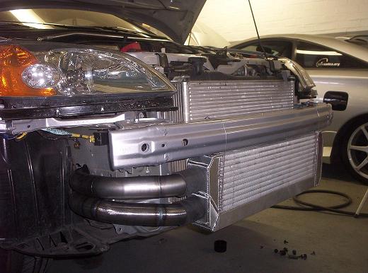

Can you keep your oem fog lights when u put on a intercooler? or do they interfere and need to be removed?
Old Sep 6, 2003
OsOBooSTeD's Avatar
OsOBaNNeD
Posts: 3,959
they have to be removed. i had them and had to remove them

wow you intercooler hangs really low man...did u refuse to hack up your bumper support?
bumper support? what are u talking about? thats how it sits, thats how its supposed to be.... its mounted to the bottom of the radiator support and i cut my bumper itself to fit it... but it doesnt matter cause i have a kaminari kit.. and the front lip covers it.

i hope it covers it, i think by bumper support he means that big a$$ piece of metal behind the plastic bumper thats curved and about as wide as the whole car, if u take the bumper off u cant miss it, it also had the 5mph foam piece on it, if u still have that on there

wuuttt.. i didnt realize the intercooler hangs outside the bottom of the stock bumper like that.. looks like if u were to hit a slightly big rock, it would fuq that **** up
lol u cant be serious? even if a rock hit it .. its metal.. and there arent 'fins' down there.. but where the f uck do you drive that there are fist size rocks on the road? if one hit ur car... id be more worried about the bumper
Yes its called bumper support.... like c2civic said if cut some of that out u can mount it higher which makes not hang low at all.
and just to FYI.. its a crumple zone.. the air bag a sensors are located where that support is mounted.. i aint f ucking with it at all.. personally it doesnt bother me.
AND YOU CANT cut the bumper support .. thats just not the way that the intercooler mounts.... i understand what u saying.. but you dont HAVE an SF kit... so you really cant comment on the install. lease: and btw.. theres like a half inch between the bumper support and the IC...just to rub it in more that it cant be done...
