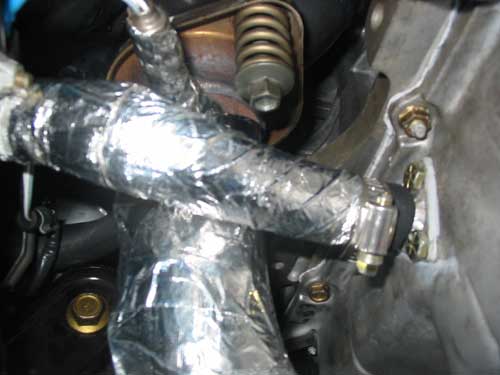

RoBBUsaF's Avatar
Posts: 662
From: Fairfax, VA (703)
RoBBUsaF is an unknown quantity at this point
more pix
oil pan plug in wrong spot so i had to wrap it... im moving it to the right spot this weekend
