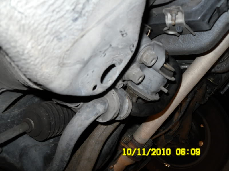

Okay, so I don't have a hydraulic floor jack. I use the OEM floor jack that came with the car.
Here's the issue: Where can I jack the car up so I can place the jack stands at the 4 jack points?
I've tried jacking it next to the jack points so I can squeeze the jack stands next to the points but the problem with this is the metal spots bend because they're soft(er). I've tried other spots but they bend too. The metal is too soft. The only part that's not soft are the jack points but I need those for the jack stands.
Check out pics of points I've used that I've managed to bend:
It doesn't look bent but it is:
I didn't take a pic of the spot next to jack point but trust me it's worse.
Any suggestions?

I've known people using it on the axel, you could try that

I just thought of something...I think I'll just use that jack point in the pic above and place a 4x4 wood between the floor jack & jack point. This way the soft metal won't bend.

Why dont you just use the jack point on the subframe below the rad...?

i always put the jack on those bolts by the jack point then put the jack stand on the real part. mine dont bend?

Corners are stronger than flat spots. But yeah, I bend my **** up too. I did get it one time from the middle around the engine somewhere that was nice and strong.but I had to stick a large jack all of the way underneath the front end.

y not jack it up by the frame

Awhile back when I did my timing belt kit change I borrowed a hydraulic floor jack from my friend. It was one of those cheap Harbor Freight floor jacks. The problem with this was that at its highest point I still couldn't get the jack stand under the jack point. And it still bent the soft metal.
Seems like there's no other way other than what I suggested in post #6.

OMG guys! I took pics for ya.
In the center of the car in the front:
In the center in the rear:
Jack it up in the center where I showed ya then put it on stands from there. It'll work, I use them all the time.

Come on guys there are 6 jack points. There is 1 in front of the car and 1 in the back of the car. Then there are the other 4 between the tires. There is 1 on the left and 1 on the right on each side of the car. There are also more jack points than this but those are the main ones.

The plastic piece under the bumper in the front even have an arrow to point where to place the jack.
The rears i use the frame for the control arms (where the sway bar is attached to the chassis).

Yes this is also a jack point as well. You can also jack up right where the knuckle and control arm meet at. There is also jack points towards the center of the car on each side. They usually use these points on lifts. Its behind the regular jack points, its the very long part that extends down and goes from the front wheel to the rear wheel. And yes you can jack up on the sub frame. The sub frame is a very sturdy and very durable, hell the thing weighs bout 100 lbs. Usually the front jack point is on the subframe anyway.

Put a 2 foot long 2x4 on a soft spot and jack that. It'll go right up and distribute the weight better.
