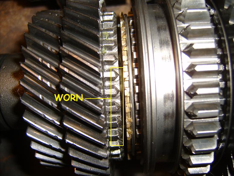

I wish I diddn't need to sell the stuff but the cash will come in handy more then the turbo will. OOh hey and you know whats funny... You know how you blew up your trans (at least I think it was you) with the stg 4 clutch ... Well mine is now done haha. It likes to pop out of 2nd when cruising. Now I just hold it in gear haha. I guess only cause ive been beating the crap out of it...

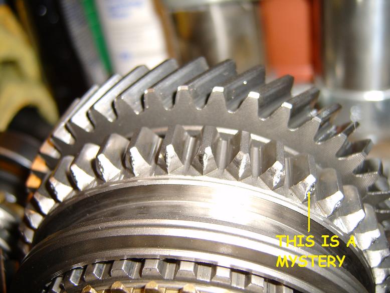

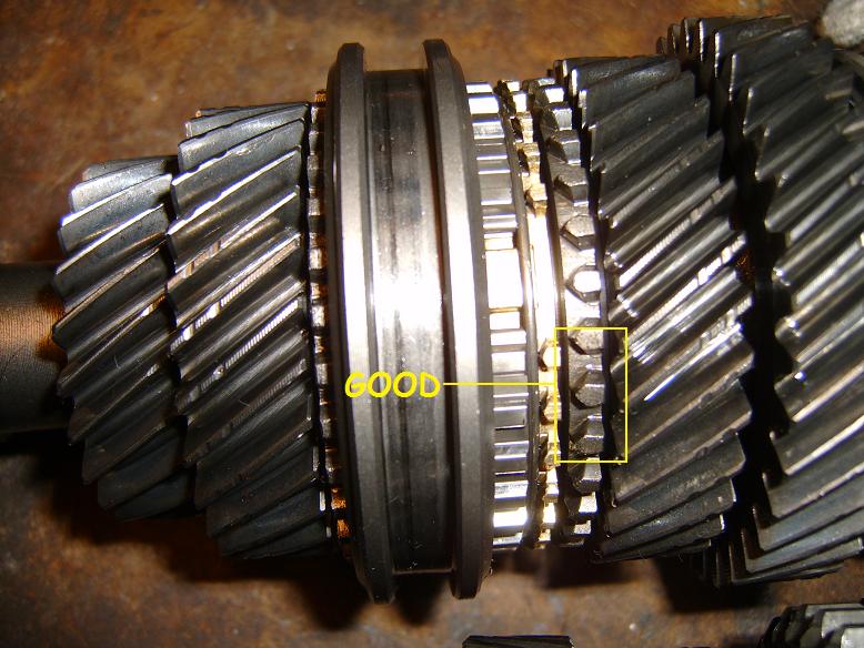

I should have the parts sometime next week to do the rebuild The teeth on the synchro rings look good but on the actual 2nd gear they are nice and rounded off. Also the real big mystery is why the reverse gear teeth look so bad. Owell thats getting replaced as well haha.
