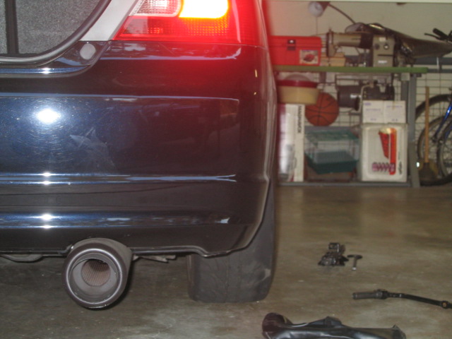

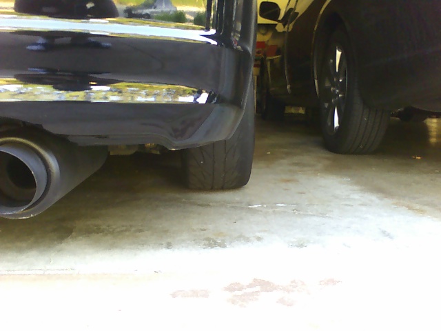

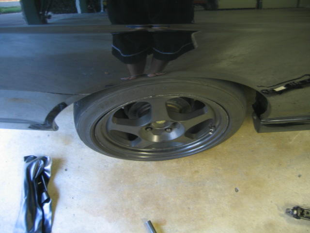

I have decided to post in here because I trust you guys more than the entire forum. Anyways, here is my problem. My passenger rear wheel looks like its to the left. What the crap is going on? Here are some pictures attached. Could it be my blown shock, camber?
Thank you

omg u got some toe issues going on there...get a re-alignment quickly otherwise ur tires are gonna go to hell

youre rim looks pretty badly curbed. Do you hit things alot? Im not talking ****....dont get me wrong. But, if you hit things alot, chances are youve bent something. It could be as simple as an alignment, but I would DEFINITELY have it checked out. It looks like your tires are just about shot too....so something is definitely going on under there. You have more than just camber wear. My suggestion....get some camber kits front and rear, and take its somewhere that does good alignments and have it aligned. If something is more serious than an alignment, theyll know immediately once they get it on the rack.

Also . . . . Im guessing you recently rotated the tires. But the thing is, you have uni-directional tires. So . . . they are backwards, or on the wrong side of the car, or at least your rear right is.

make sure all the bolts are all tight
This wheel was already curbed when I bought it. I had never injured these wheels in any way.
Already done that yesturday, notice the tools to the side. Didn't solve my problem.
Cuz I had my wheels flipped due to camber. So the right rear was assed out and got the wrong directional tire. hahah
I guess I'll have to visit an alignment shop soon. And to think I went canyon running with this. hhahahah
