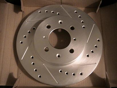

well with all the high speed braking and canyon runs my rotors and brake pads went out and it got warp. i just got some rotors and pads for $143.

yo jon take thoes rotors back drilled rotors crack real quick. get the AEM kit or Powerstops

umm lets see bermbo among other companys that use to use drilled rotors to race, wich they dont any more. if u look at race cars u dont see drilled rotors anymore, reason being is that, they would crack when the would get to hot and overtime to much stress on the holes. thats why drilled rotors sucks ***, chad and its not cuzz u get cheap ones its any rotor that is drilled. and if u did alot more raceing and canyon carveing you would know what im talking about im also talking from experience ive used drilled rotors on my last 3 cars and after raceing, auto-x and canyon carveing they have all cracked ive used brembo, bear, and powerslot to name a few and all my friends have had the same experience.

and can u remind me what kind of rotors are on the rsx type R???? slottled or drilled?>

#1 BIGGER blank rotors
#2 BIGGER Slotted rotors
#3 Only slotted rotors
Drilled does look cool though

slotted is the way to go... the holes make the rotor less sturdy
