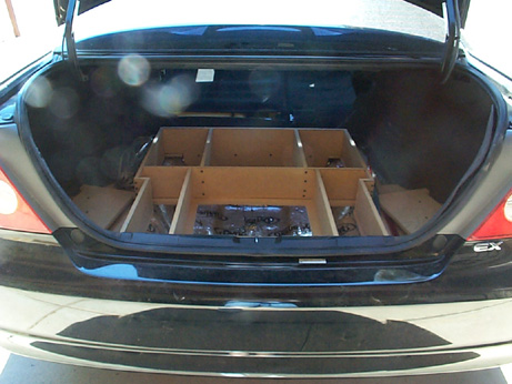

Here are some pics. All that is left is fiberglassing the bottom tub to the sides and my lid! You can use Dynamat as the floor but it becomes a pain if you ever need to take the box out and put it back in. O Gauge is ran, speaker wires are almost done, and RCA are run. The sub will be one Diamond TDX 12 ported.

Nice...what amp you pushing the Diamond with?

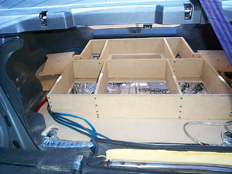

pic 2

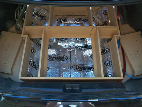

Pic 3

Sub will get a JL 500/1. The kicks (Diamond HEX 6.5's) will get a 300/2 (No door speakers) and the rear deck will be run off of the RAF output of the HEX crossovers. The deck will be Diamond M6's. One set of Silk Diamond tweets in the kicks, and Aluminum ones on the A-Pillars and rear deck. Tweets in the pods by the mirrors are going bye-bye.

nice speaker wire..lol....better put that resin down on a friday nite or you will die trying to drive that thing around....how far you think you will be on that project when the meet comes??

hmnn... If I haul *** I could have the trunk finished. I remember the molds for my kickpanels all too well. It smells like fiberglass for days after the glass is out of the car.

I've got dynamat all over and it helps alot, especially when it gets warmer. Your setup is looking so good. Can't wait to see the final product.
