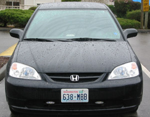

This is what it looks like...my car

No I didn't paint anything...I just have an amber bulb in there. It just looks amber like that cuz the color of the bulb is being reflected by the chrome inside the housing.
