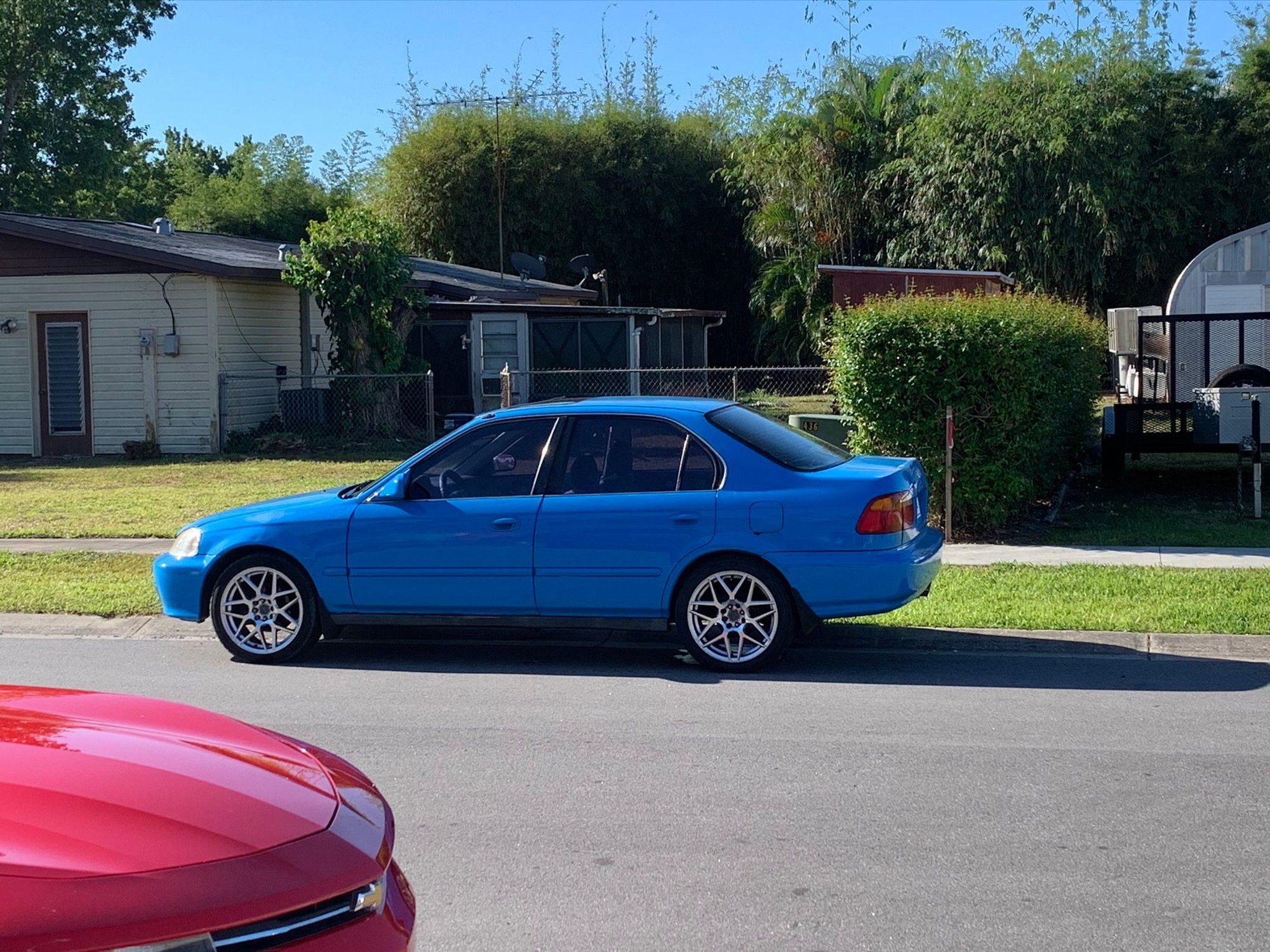

Hello!

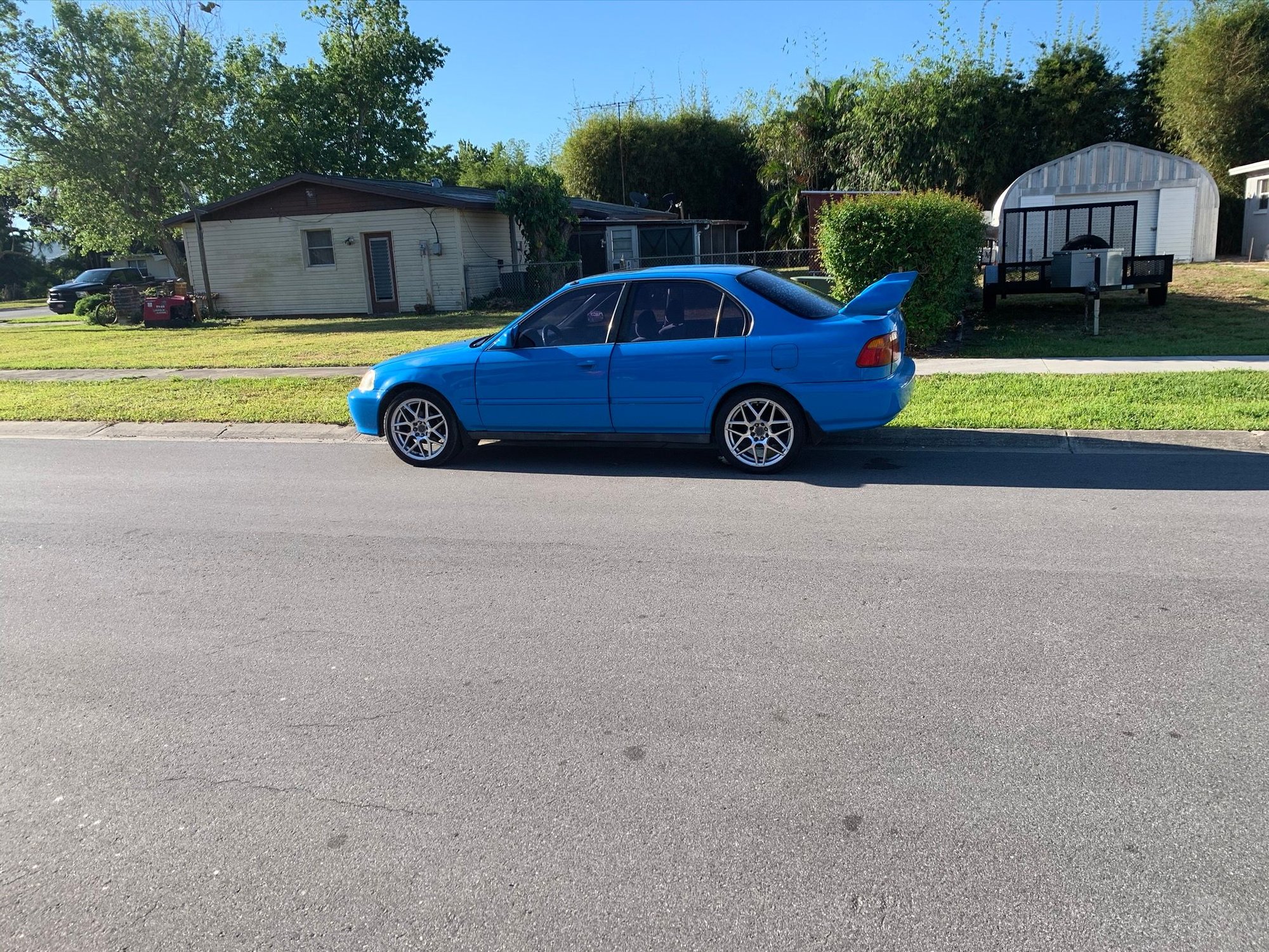

I'm SE7ENZEROTWO and I'm an auto enthusiast. Currently a no-name youtuber who just mainly posted some odd and end clips from Mexico. I was a street racer battling others on Gandy Internatonal Speedway in my Camaro, but on a whim I experienced my first Rally in November of last year. It really opened my eyes to what car culture is really about, and it really was a perspective changing experience. I ended up battling GTR's, 305 Swapped 240's, LS Swapped turbo S2K's, and a bunch of others on some crazy backroads, and cruising while making a bunch of new friends along the way. Among nearly 70 drivers in the poker run rally, I won 2nd Prize and it was awesome. Shortly after that, I gave up street racing mainly because it's not the same. I've been attending some meets and cruises here and there and it was pretty cool. This past weekend, I ran my Camaro in the Corsa Rally (Corona Virus Rally) from Tampa to Lamborghini of Sarasota and back. This time I met even more friends who check up and encourage eachother to keep going. One of my friends from the Poker Run was my co-pilot and it really was a blast. Around 2 weeks ago, I've decided that It's time for a project car. Something to take the stress off of my Camaro and something to build and grow with. I've never taken the youtube thing seriously, nor have I really challenged myself in this kind of way.
As of last Wednesday 4/1/2020, I bought my project car. Something that runs and drives, but is rough and really needs love.
This project car is a 1996 Civic DX D16y7 5 speed manual. The only time I ever drove a Manual was when I was 12 or 13 in my dad's crappy 1980's trans am. So I basically showed up not knowing how to drive a Manual to learning how to drive it in 5 minutes to shifting from 1st to 5th in the test drive. I'm still sloppy and miss gears now and then. I can avoid stalling out, but I'm really trying to work on getting into 1st smoothly since the engine revs at the weight of a feather.
The purpose of this car is to become a cool but tame event/rally car. Something to challenge myself, to be recognized at car shows, and to drive in rallies. This is a very budget oriented build.
The work done on this car so far was removal of the big **** and removal of the rear window tinting.
The car looks much better without the rice burner. It's currently in for a new gas tank since a leak spilled gas all over the asphalt and started breaking it down. If you look hard enough in the pics above, you'll be able to see it.
I get the car back on Tuesday and the work will continue then.
But for now, this concludes the creation of this thread and my first post here. I have no talent when it comes to this. This is the start of not only a new chapter for myself, but also a new chapter in the story of this Civic. I hope you stick around and follow me through my Adventures.
-Steve (SE7ENZEROTWO)

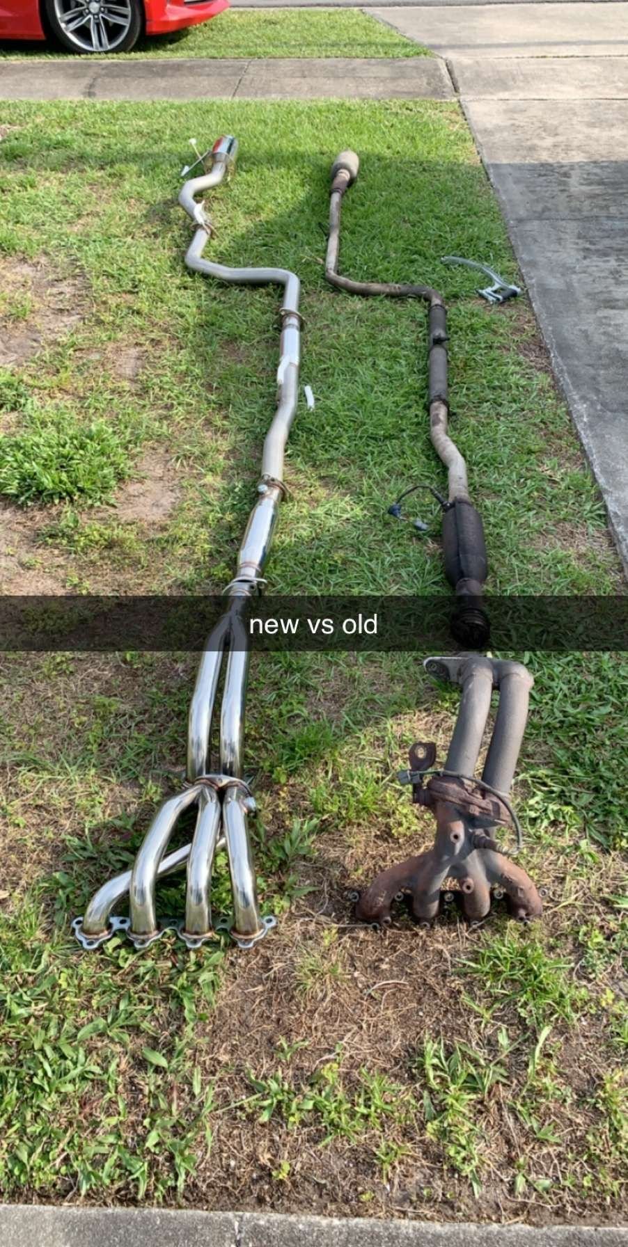

I've been working on the exhaust and it's kind of turned into quite the Ordeal. As you know, I ordered a complete exhaust for $214. Getting the old exhaust has been the biggest pain in the dick for me in a long time and I ended up having to hacksaw parts of it just to remove it. However once it was out, the new one just went right in. However, it looks like even if you specify the year, make, model, and sub model, you still may not get the correct exhaust. For me, it looks like I got the wrong test pipe (catalytic converter replacement) and it ended up not only being a wrong pattern, but it was 3" too short and there was no way to close the gap other than fabrication. The wrong pattern resulted in an o2 sensor pointing towards the ground, unfortunately. I tried to get the car to the exhaust shop asap hoping it wouldn't kill the sensor, but the sensor was destroyed by a bump.
Once the car was fabricated and such, I had an issue with the wheel and it turns out the lugnuts weren't tight enough. I wasn't able to make it home, so I had to pull it into the closest auto shop and they diagnosed it as a bad wheel bearing and wanted to charge $460 to replace. I said hell no and went on a recommendation of a friend to another shop. There I met a fun english man and he only charged me $100 to fix my issue, give it a look around, diagnose a few other things, and then change the brake pads.
Heres a sorta in-depth vid for the exhaust. Due to the circumstances, the video may seem like it's done at the ending, but this is actually turning into a 2 part saga.

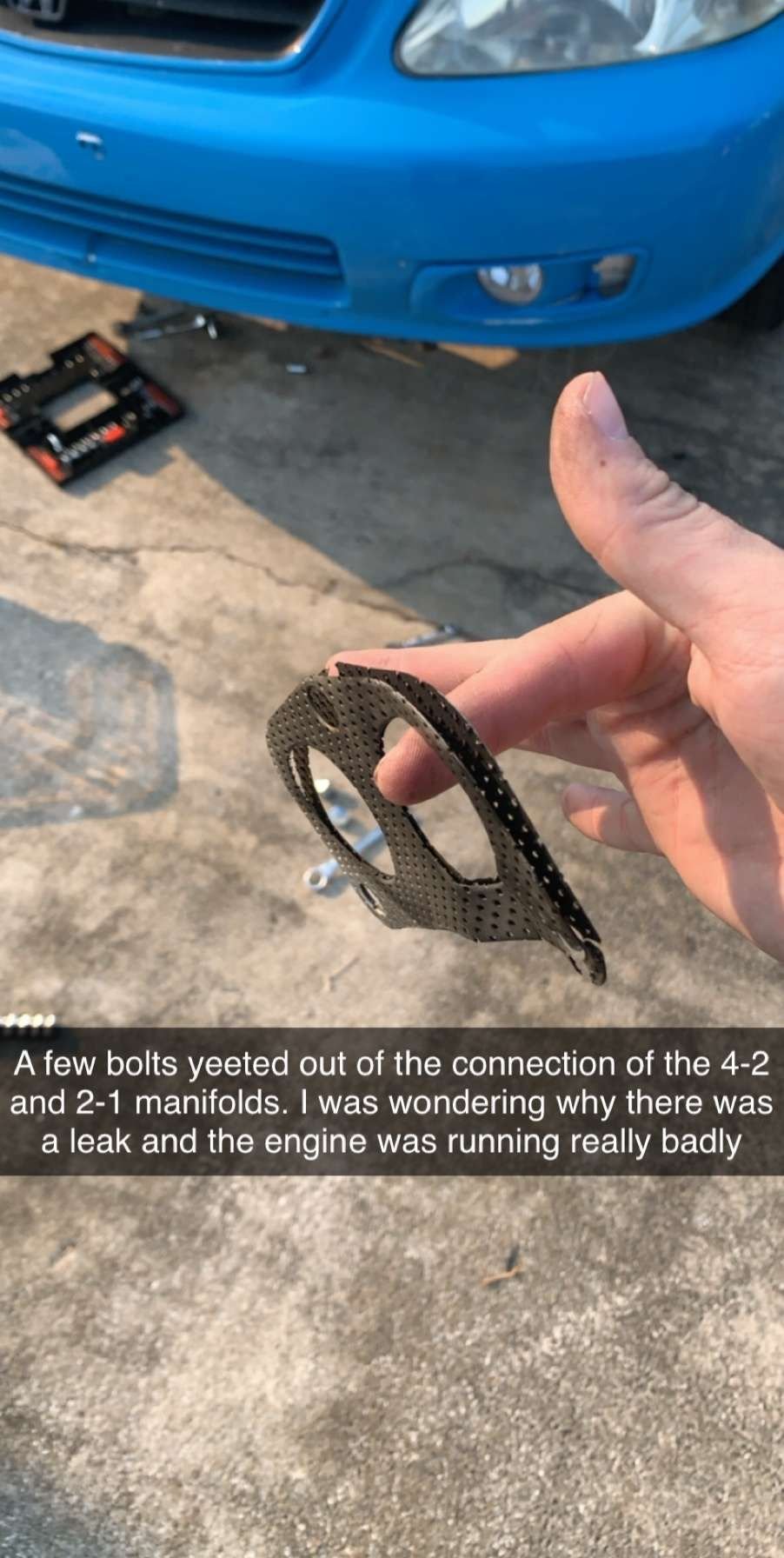

The exhaust was in fine and dandy, however a few bolts that were holding the 4-2 and 2-1 manifolds together somehow fell out, causing the gasket to come loose and basically melt. This caused the engine to run terribly and feel/sound like it was running on 2 cylinders. Ordered a new gasket and hardware for $20 on amazon, got my replacement o2 sensor for $26 on amazon, and got both parts in. The check engine light is gone and the car finally runs and sounds decently. Lots of crackles, pops, and the occasional loud bang when decelerating/shifting gears. It sounds good in person, if you don't mind the fart too much.
The video goes over everything in detail and gives you an idea on the sound in the end. The serious, more in depth driving won't be for a few weeks since I got other things to work on before I get to that.
