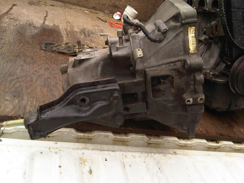

spare dx hydro trans

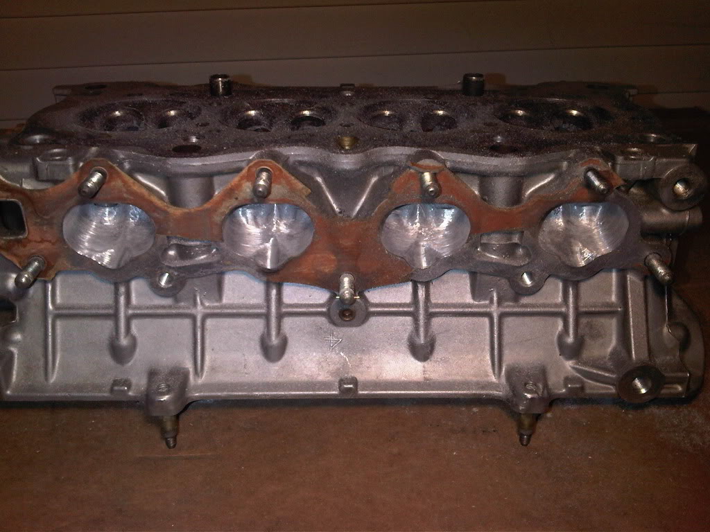

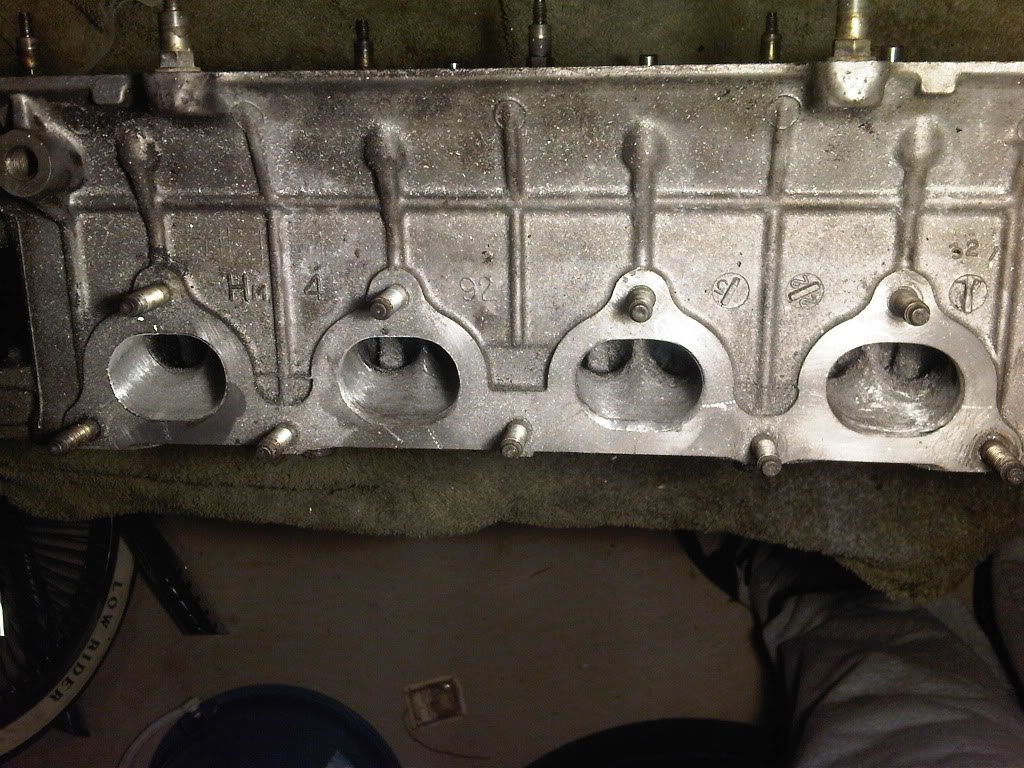

started gasket matching the exhaust ports
got the intake side pretty much done, just have to pull the valves and finish there

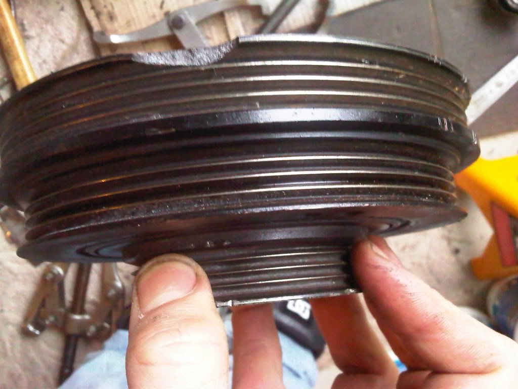

got the crankshaft nut off and my friend who gave me the motor started tapping it with a hammer..bent the pulley inwards then pushed it and it broke off lol. oh well, i had wanted to buy a lighter pulley anyways...
showed him the underneath of the belt and he said he would still run it lmao...

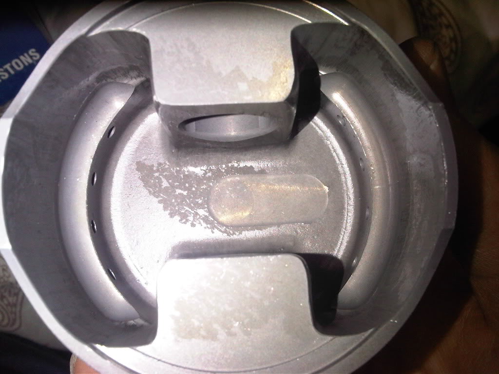

picked my pistons up today!!

pretty much done the intake ports, just have to finish the bowls

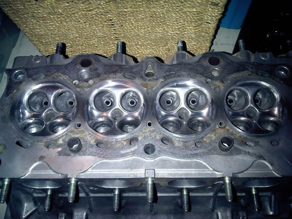

Finished polishing the exhaust ports. Started with 100 and continued with, 150, 220, 320, 400,600, 800, 1000, 1200, 1500, 2000, and finished with 2500 grits.
couldnt get any good pictures last night but heres a couple

cleaned up and polished the cumbustion chamber a little bit

today i finished porting the bowls, blended the valve seat with the bowls and opened them up ever so slightly.
was gonna get a friend to help me with the guides and valve grinds but hes a little busy building a wicked h/f motor..dropped the head back off at the machine shop with the oversized valves for new exhaust guides/seals and and their "performance" valve grind. will be done tomorrow afternoon they say. $200 for valve grind 9 bucks a guide installed. so roughly another $300.

i ordered a water pump from honda parts unlimited, got a new ex. valve from thmotorsports, those should be here around the time my intake manifold gasket gets in.
the machine shop put shorter valve guides than the stock ones that were in there IIRC.
the valve seats look really nice, and they cleaned the valves, they look brand new! i'll take pictures and post soon!

heres some pictures of the head with valves, bowls and ports. when pulling a valve from both intake and exhaust, now i almost wish i had gotten new intake valve guides, even though they are in spec. the exhaust guides are so snug, and the machine shop cut them down nicely.
