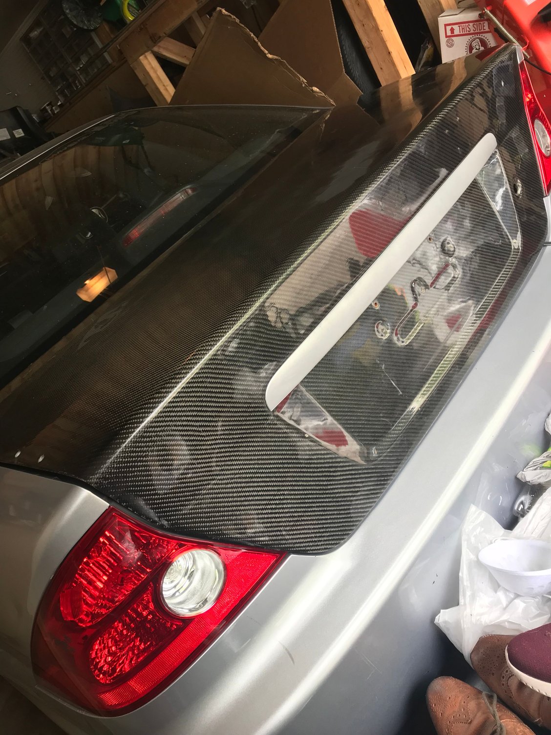

bryan.0831 is an unknown quantity at this point
Re: Bryan's 05 em2

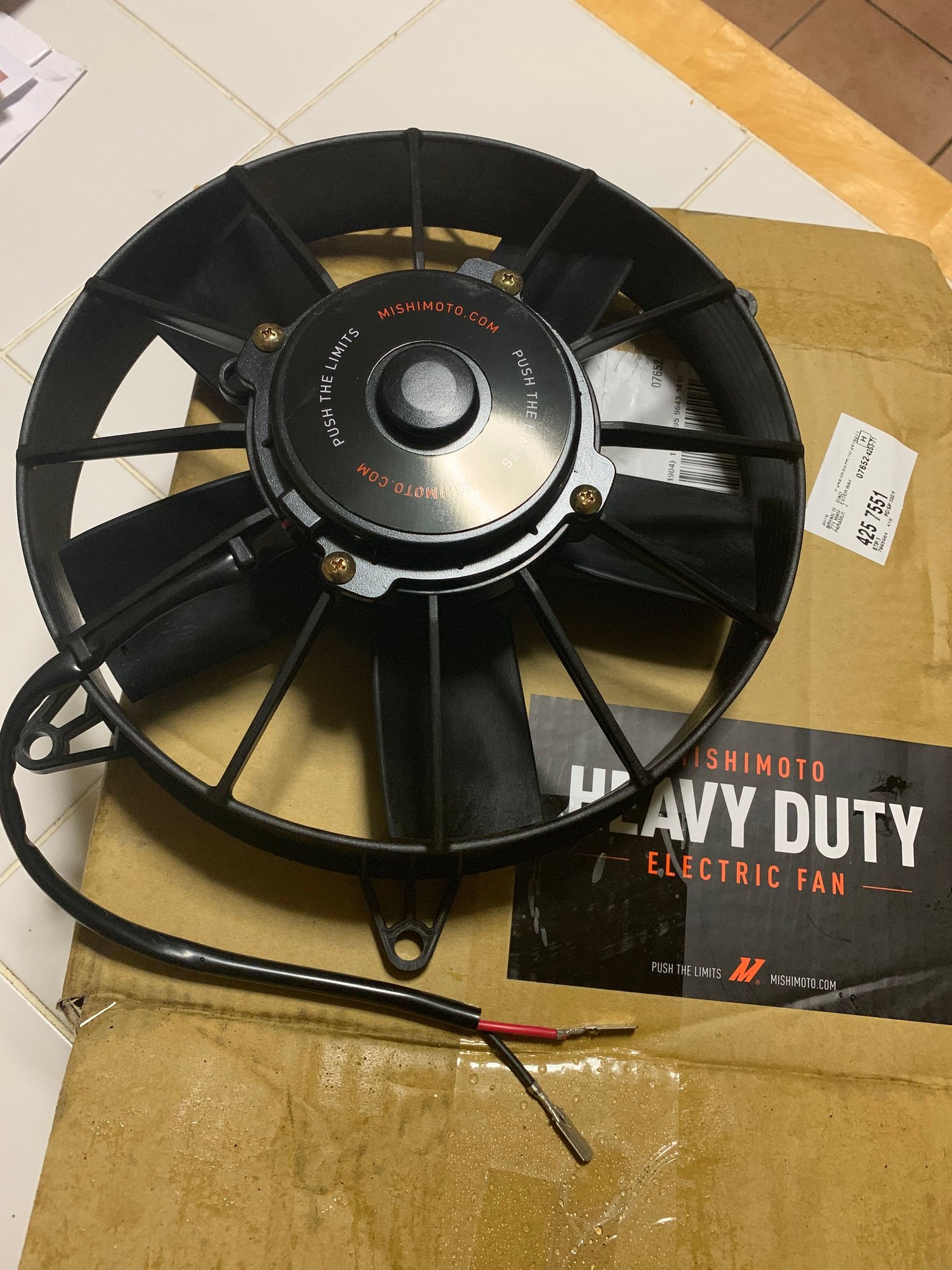

I got a 10” Mishimoto Heavy Duty Fan to replace my Mishimoto Slim Fan. It’s a bit heavy, 5-6lbs, and thick but suppose to be 1600CFM and gives me a piece of mind. The slim fan I have is old.

If you have the space It would be interesting to test if two fans would work; like a cpu cooler for overclocking. One fan before the radio, one after.

Yea it’s interesting but I heard it just restricts the airflow to the other fan. Not sure the science behind it. I don’t have the space to try it.
And I need to buy a new rad now, I just poked a small hole on it by accident. It sucks. I cried a little bit.
I was thinking about running a half size one but I’ve been back and forth about it since I’m gonna drive this car a lot. I have read different opinions.

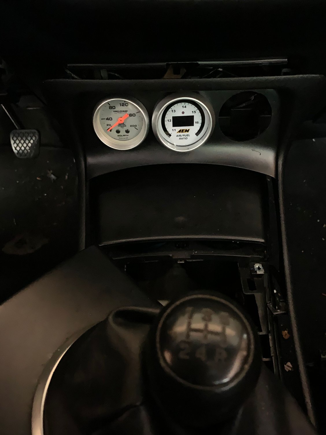

I have my gauges down at the lower center console, but I’m tired of looking down and now being able to have a charger. So I bought a gauge cluster.
Nothing special. It does the job. Fits nicely

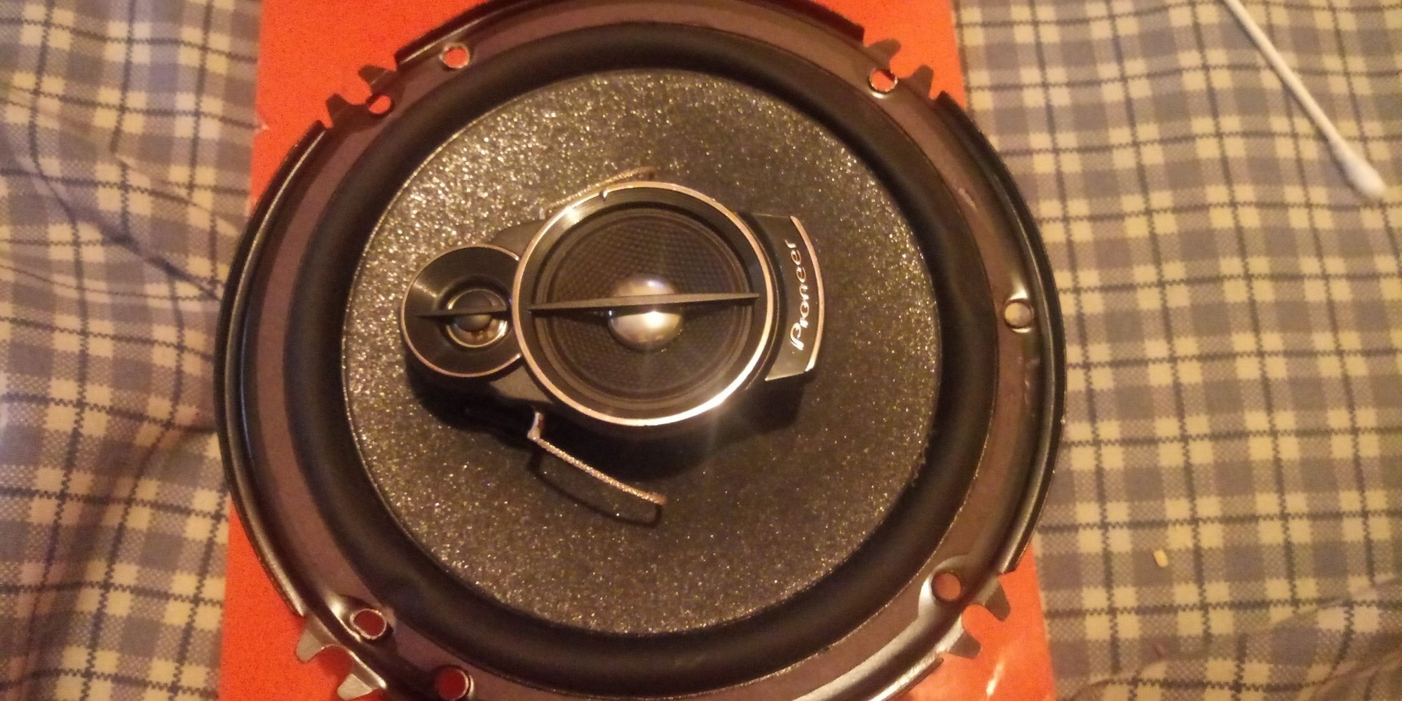

hey bud im selling my 04 civic ex coupe 5sp cleanimside ...and im pulling my stereo for someone witha civic b\cits complete Pioneer AVH2300nex dbl din Pioneer 3wdoors window tweets with built in cross pioneer 6\9 rears all ts pro series have pics willing to sell whole center console so it will slide right in has bluetooth andriod auto its unlockwd so ucan watch movies while driving or music vids . mic . navigation ..rear cam dash cam built in OBD2 system with optional guage display on radio vintage Amp 2 12s vintage 5 fared capacitor 4g wire ..also have a ton of parts panels seats 2 headers Dc 421 and skunk..skunk vtec2.0 jdm body full chrome resenated exhaust. optional silencer and morestuffim forgetting hmu im in mobile alabama 2519302702
Old Sep 11, 2019

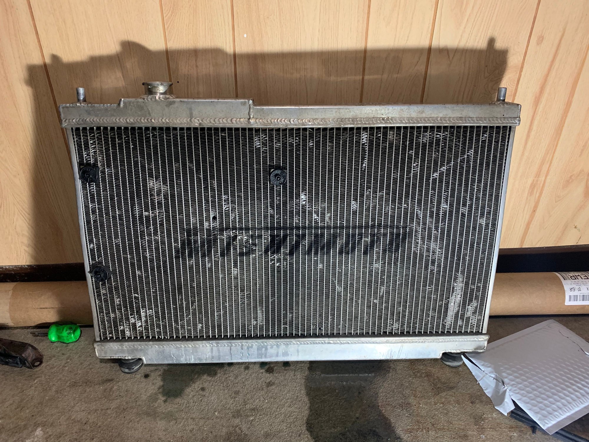

Old and beat up radiator off.

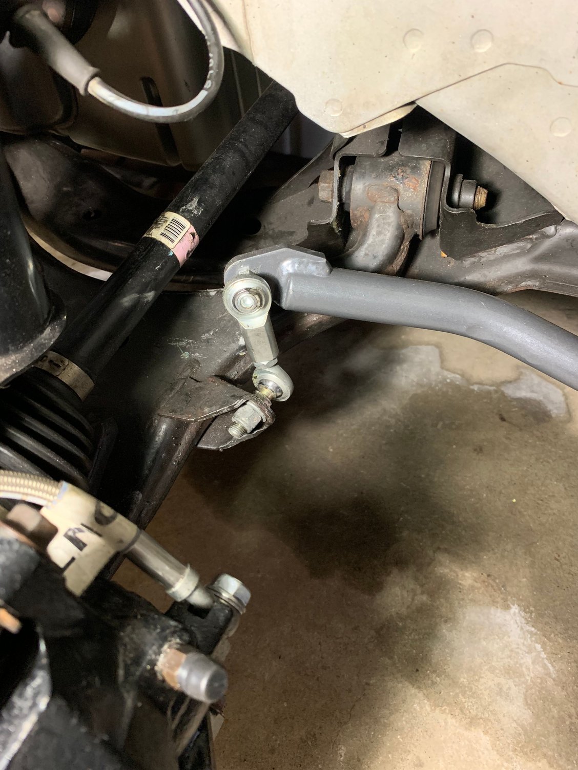

While I’m waiting for the rad to arrive. I decided to change all the rotors and brakes. I completely forgot that I made my own swaybar endlinks.
Front and rear. I forgot where I ordered the pieces from. They are ball joint ends with high load ratings. I have driven with no problems even on fast turning.

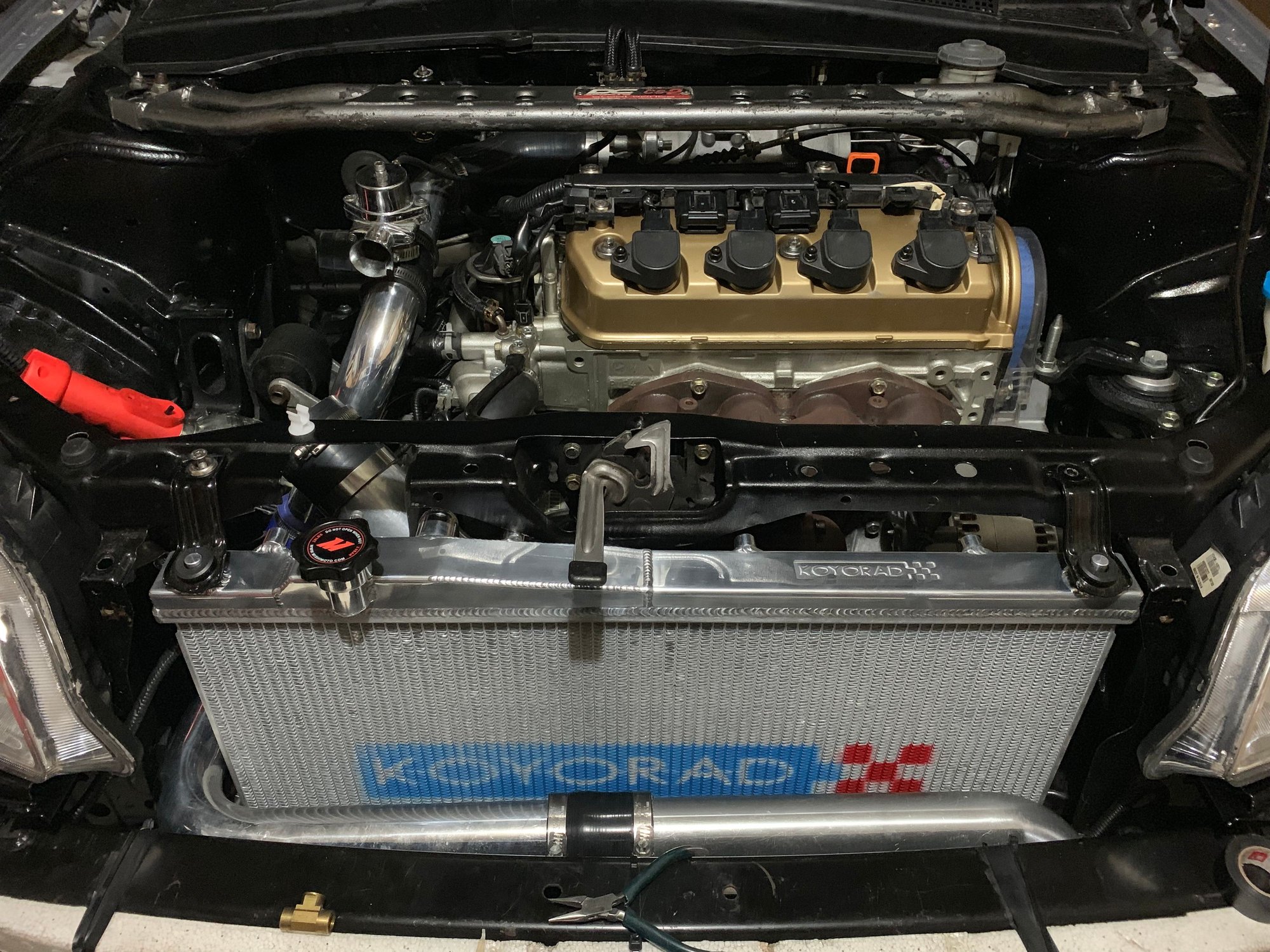

Koyo Rad fits well and I haven’t tested it while driving. Only idling to prime and take out the air from it. It wouldn’t go pass 180 when it was idling. Gotta check it on driving conditions, specially on traffic
I realize I could’ve gotten a bigger fan so I will purchase a 12” one later on. I just used the oem fan shroud and fitted the fan there nicely. I could fit the 12” there better.
