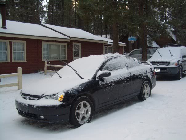

Been a great week, got lots of presents left at my door. Finally in my house (took way too long)and...well...most of the way settled in so I figure its time to start giving the Vic more attention. Have a blown head gasket, so I figure I'll upgrade at the same time. So picked up an extra A2 head for $78 at one of my local salvage yards (came with the vtec solenoid , water tunnel, and egr valve both of which I'm gonna clean and put up for sale). I just dropped that off along with the crower stage 1 can and valve seals at the machine shop for a valve job and slight mill and cam install a few hours ago. Virtually every gasket and seal in the top end will be replaced.
Current mods:
Energy front lca bushings
Custom painted interior trim
Eagle alloy rims - need to go...
And yes those are advance brakes, ran the budget a little high before I got to the and mine are warped. S2000 oil filters, spec-d euro headlights, a em sri,block heater, both o2 sensors, arp head studs. I will be installing all this the last weekend of this month. In February I'm planning on HP Blues, Eibachs, 17" Kong Backbones and a decent set if treads.

dear God those rims are hideous...reminds me of my car when i first bought it
jk jk

Sl33py: the rims have grown on me a bit, but im not a huge fan of them. The previous owner effed them up though...put the oem acorns on the conical rims a chewed the royal crap out of the mating serfice, had so many little stupid projects cause he didnt do anything right, its also the cause of the head gasket issue. He cracked the ac condensor and radiator, and unfortunitly I didnt find out bout the radiator until it was too late. The konig backbones or feathers look pretty decent to me and I can get either one from a shop for round100 to 120 each. But ill look more at whats availible when the time comes for that, want to spend less than a grand on rims, tires, and lugs if possible.
