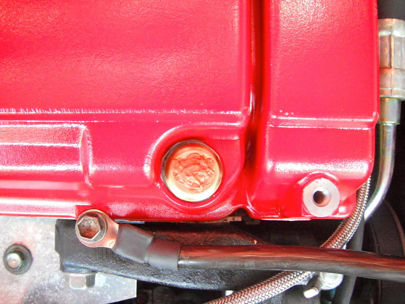

Since I had the valve cover off, I thought it would be a great time to paint it too. It was black before and I wanted it to be red, so i went out and got some prep stuff and some VHT paint.
After stripping and pressure washing most of the paint off, I took it to the bath tub to wet sand and degrease some more. Yes I use my bath tub...
BTW dont get aircraft grade paint stripper on your bare skin. It sucks...
I was running out of daylight and wanted to paint soon, so I stuck it in the oven at 200 degrees for ten mins.
Masking off all the holes and the only letter I wanted to remain silver. Then prepping surface.
About six coats later... I havent decided if I want to paint the lettering black or not yet. It has to dry over night and then I can stick it in the oven once again at 200 degrees for 30 mins to cure it for final finish and then I am going to throw it back on the car and start her up. Hopefully it is a lot quieter now after the valve adjustment...

Well today started off great. I put the cover in the oven and cured the paint and then took it up to the garage to put back on the Si. Got it all on and started it up. Valves were definitely looser. I didnt double check my work. Pissed at myself because I dont like doing things a second time, I took it all back off again and readjusted all the valves again... this time double checking. Well I put the cover back on and as I was torquing my bolts the lower right bolt snapped off the stud. FML
Luckily the valve cover is seated enough that it wasnt leaking. Good enough for me until I pull it again to replace the studs. Luckily they are the type that have the bolt attachment so I dont have to drill. So I just put some RTV around the little gasket/washer and put it back on. No leaks. Good enough for now.
