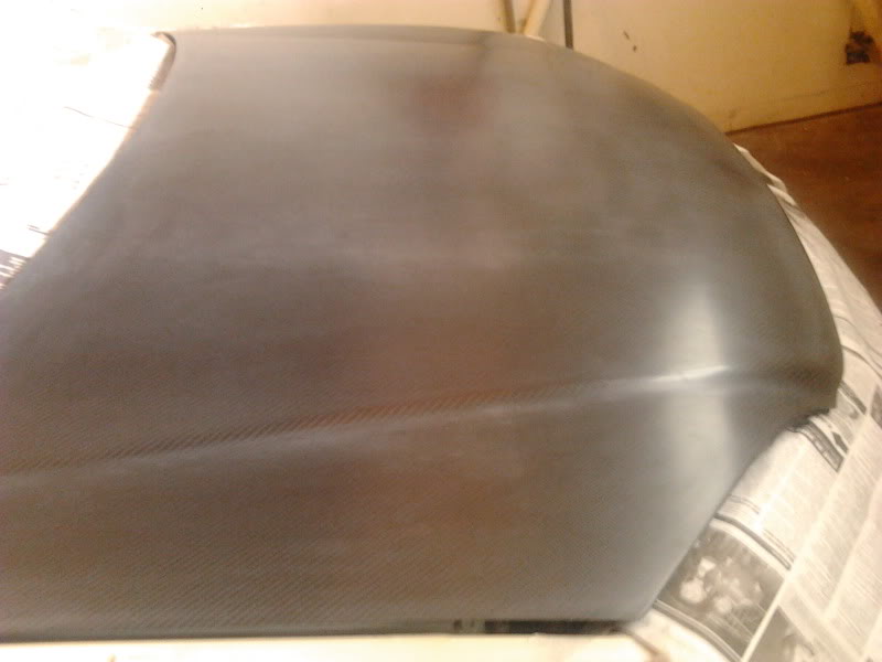

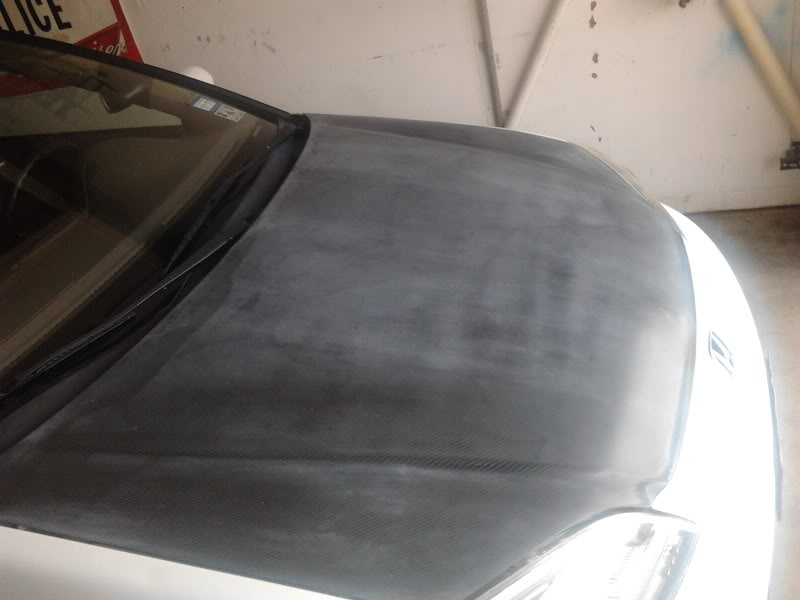

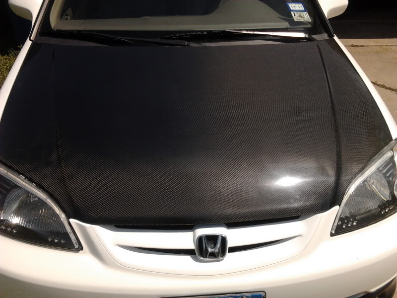

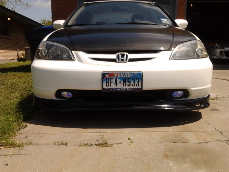

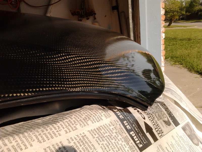

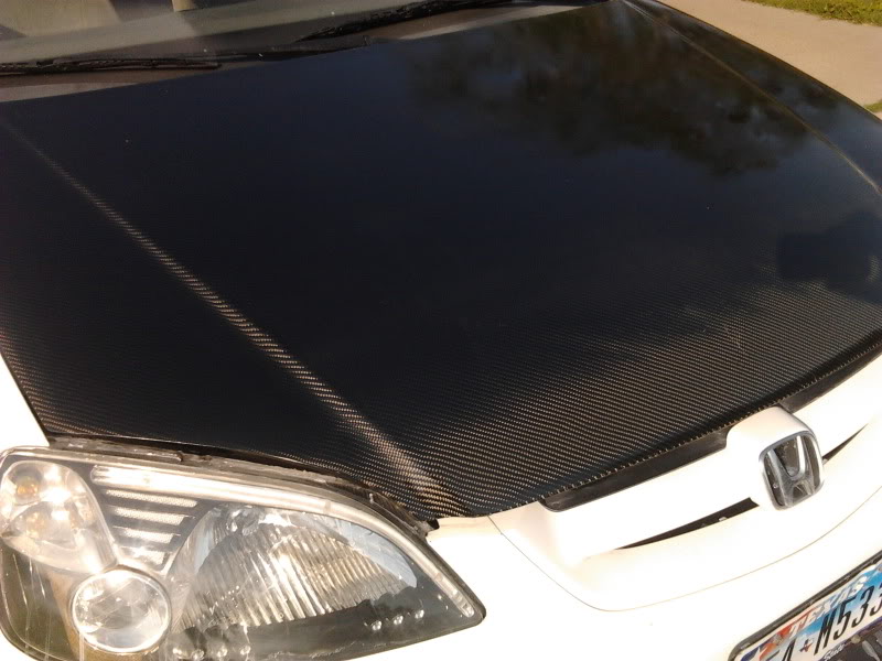

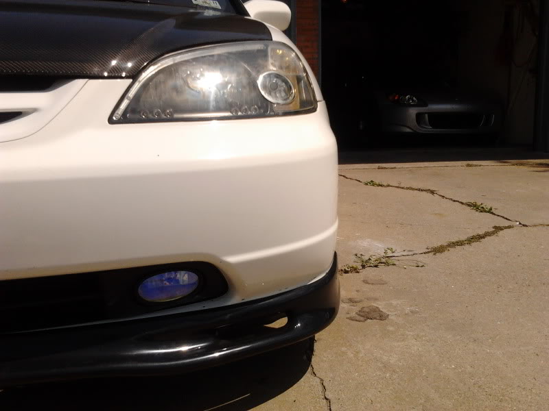

Needed to re-clear the carbon fiber hood..not a diy, but just took pics of the progress and have a couple extra pics of my weekend mustang eater...ENJOY!
BEFORE: Looking all nasty and ****... UGH!

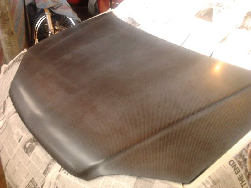

Wet sanded...

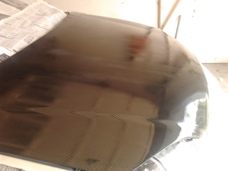

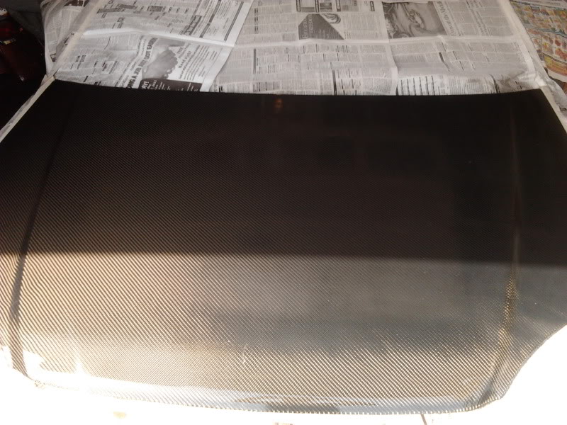

First two coats of clear...
Fourth coat..
Final coat..
Notice the over spray..

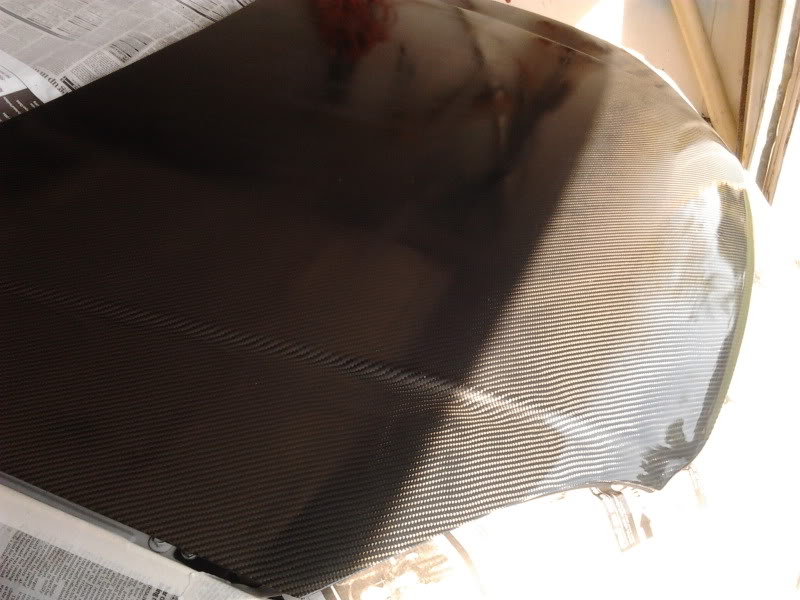

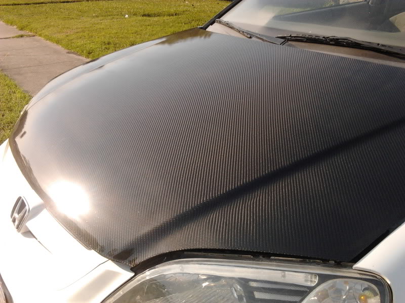

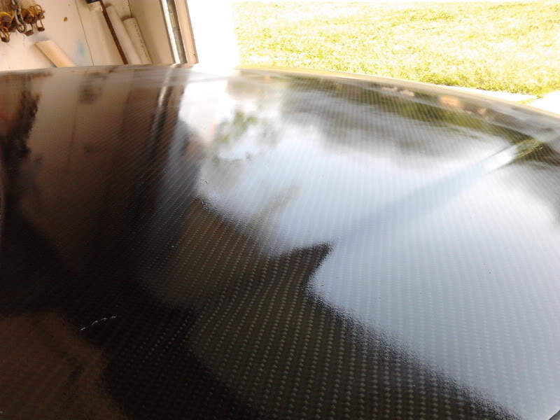

3M Rubbing compound and some wax..

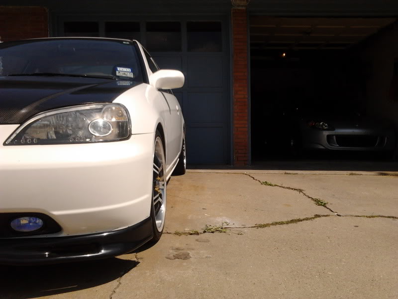

THANKS FOR LOOKING!! Leave comments GOOD AND BAD! HA!

what kinda clear coat did you use on the hood?
duplicolor clear coat acrylic lacquer

Hell ya...the acrylic laquer doesnt have a ball in the can.. im pretty good with spray can..

thanks bro....its really easy, just alot of work and prep, gotta have alot of patience... Shoot me a pm and ill send you all the info you need and what materials u need to get.. thanks again

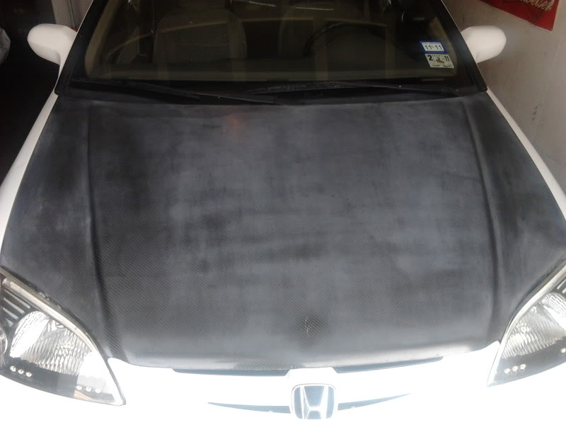

Question: My hood looks worse than yours when you started. And I have cracks all around the hood pins and a crack right in the center. Is it worth it to do this or will my hood just keep cracking? I mean, I know it'll look way better but I don't know how fast the cracks spread and what not.
(Don't know much about CF and bought my car for cheap in this condition)
EDIT: is there a way to delete my post? I figured I'd start a topic instead of thread jacking the OP.

yes sir...thats why there was so much overspray.. but 3m rubbing compound took all the overspray away and made it shine..

did you let it completely dry before you polished it? how much time?

Wet sanded and cleared it on monday and finished about 3pm... let it dry in garage for about an hour then let it sit out side for the rest of the day in the 90 degree sun.. then tuesday bout 6pm (24hrs) later after the car sat outside all day for the clear to harden up.. wet sanded it again with a ultra fine scuff pad and 3m rubbing compound it.. and BAM! brand new looking hood..

Looks good but it wont last (ive done a few evo wings), the paint will turn right to garbage again if it doesnt have some kind of UV protection in it. But if you dont mind doing it once a year then it looks good!

Itll last.. i have five coats of clear on the hood, not paint. i just have to keep up with a good wax on the hood at least once a month. That will keep it from oxidizing again.

It doesnt matter how many coats you put on cf, if the clear doesnt have uv protection itll happen well within a year again.

Its all about maintenance with keeping up with your car. Keeping WAX on your car keeps the UV from oxidizing your paint and clear. May have happened to you, paint and forget about it and hope its gonna last without proper up keep. Look at stock cars, they dont have a UV protection in all the paint because when people dont mind there cars it starts to oxidize. Maintenace.....

Maintanance isnt going to help with poor quality products is what im saying. Wax wears off and can only do so much; if the paint cant provide uv protection to its underlaying suface its not going to last; its as simple as that.
FTW 99% of cars do have uv protection in the clear, thats why older cars (mostly red) do not have a clear coat and thats why they fade/oxidize.
anyway post some pictures in a year from now and we will see
