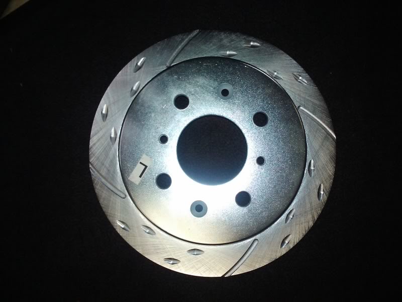

Close up Shots

What do you guys think should I go with the rotors and just get slotted?

Those are not vented rotors. I'm fairly certain you are going to run into heat issues running those on the front, even if they do fit, which I doubt they do.
Sorry to tell you man, but those are DEFINITELY REAR ROTORS, either do a rear disk swap, or send them back to summit and ask for front rotors, you may have ordered the wrong ones by accident or they may have even sent you the wrong ones, your front pads wont even cover that whole rotor.
