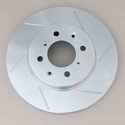

What would you guys suggest for the front?
What would you think if I got slotted only rotors with EBC green pads?

crossfire, i would go with a decent brand name rotor like powerslots, brembo or something.
if i had to get modded rotors, i would get slotted over drilled, they do provide some advantages. they act as little razor blades and clean off ur pad with every swipe...but remember, as a result of that, u pads will be eaten up much faster than if u did not have them. the choice is yours.
as far as pads go, ive used axxis, EBC green stuff, HAWK HPS and HAWK HPS+
the HPS+ are by far the hardest biting but take a little time to heat up and they are loud as hell when you brake...i later found out that these pads are more geared towards race useage.
my fav and personal pick is the HAWKs HPS pads. they dont need that initial warm up to perform at its best, they bite hard and i have never had brake fade problems with it (w/ 2 track days), they are quiet, and they last quite a while.
ive used EBC green and the axxis metal masters and were not impressed with them very much.
also, remember that slotted rotors will eat up the pads

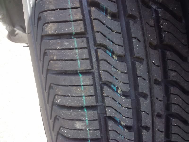

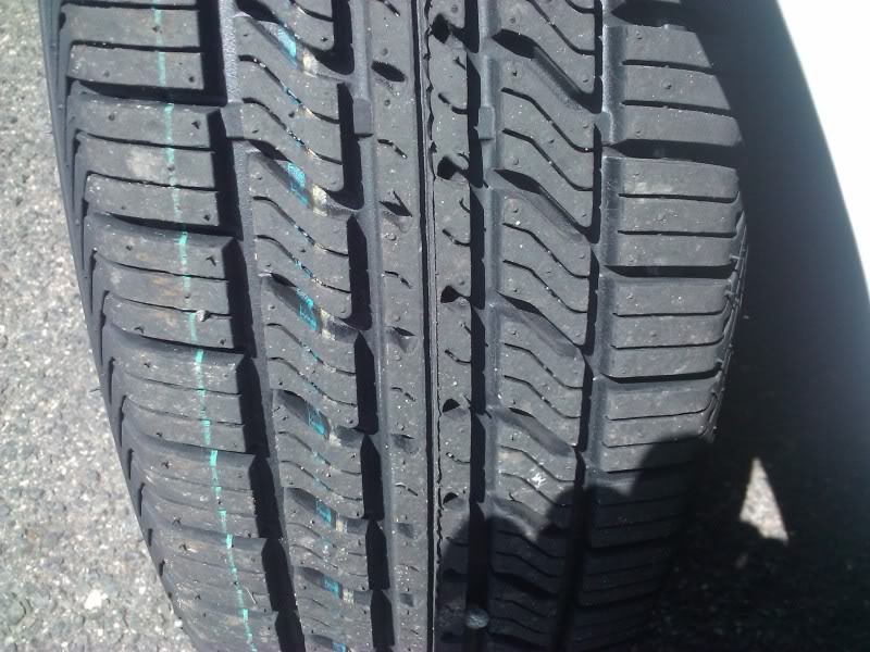

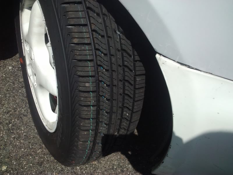

Well guys! I just got the car back from the shop that done some work to it and found out some bad news. I had the car in the shop for 4 New Tires, Alignment, and A/C charge this morning. I got a call from the guy stating that the A/C system didn't want to charge due to being clogged somewhere. He told me that the low side being charged wouldn't go and stayed at 90 PSI without filling the system.
To me it sounds to be the expansion valve that might be stuck closed and that's why it's not charging enough to kick the A/C on. What do you guys think?
When I got the car I though the tires had some decent meat on them and didn't think I would need tires but after taking them off I noticed huge negative chamber wear to a point where the tires were bold on the inner side. This happened due to the kid dropping the car 2 - 2 1/2 inches using those crappy eBay coils. I'm telling you some people shouldn't be working / moding cars if they don't know what they're doing. The tires were so bad that as soon as I hit 65 mph and up man did the front SHAKE!. And now after everything nice and smooth cruising around 85 mpg.
So new fresh tires 185/65/14, valves, balance on all sides. Wee!

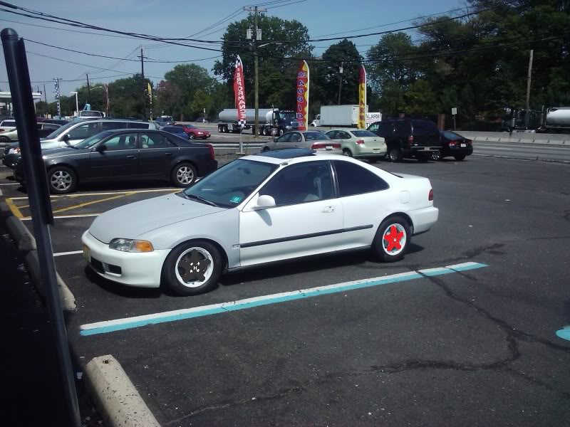

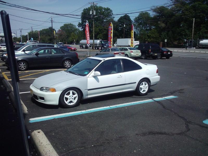

What color would you guys think would be better...
Black spokes with white lip. . . . Or . . . . Maybe... Red spokes with white lip.

I say Poilished with a black lip. Unique to say the least If you have a good Hi-res pic, I can photoshop it for you.

If you download this same pic from page 1 you should be able to chop it. This is my first eva so here it is.
