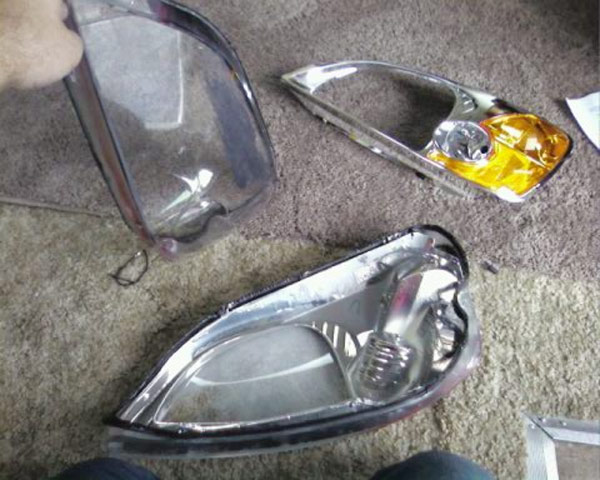

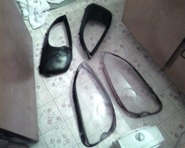

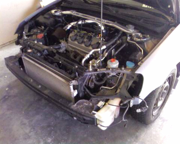

pulled them out.

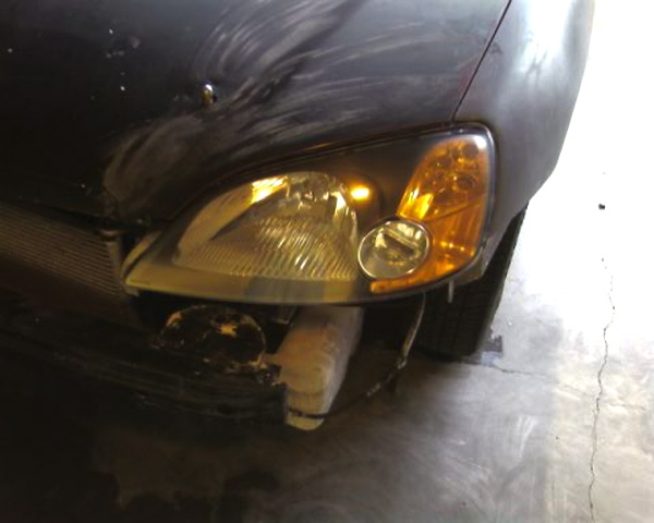

Here is what the headlights looked like. A couple years ago I decided (this was back when I knew less....way less...) to paint an "eyelid" on my headlights. And well, it worked perfectly fine for a long while, until about a year ago the paint started to chip off, because the plastic under it wasn't prepped correctly. Learn as you go right!
They came apart pretty easy, granted I did it gently and such. Lowest setting on my oven was 170, so I put in in there for 7 minutes. Worked perfect.

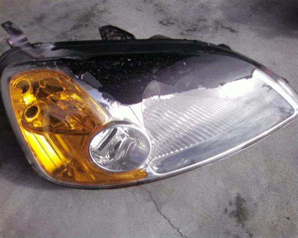

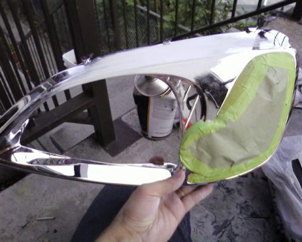

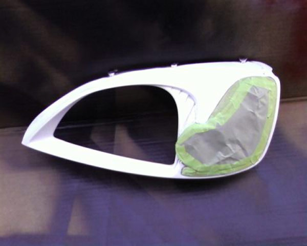

Here I started sanding it, top middle is sanded, the rest is still chrome. I was surprised how easy the chrome came off...
And of course, completed sanding.

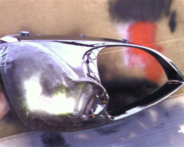

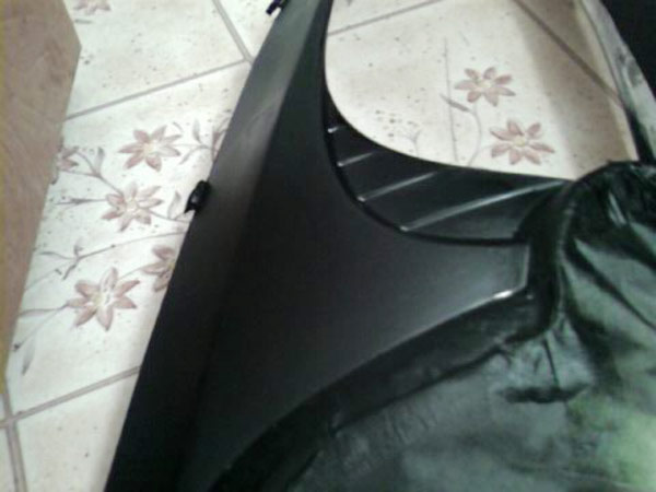

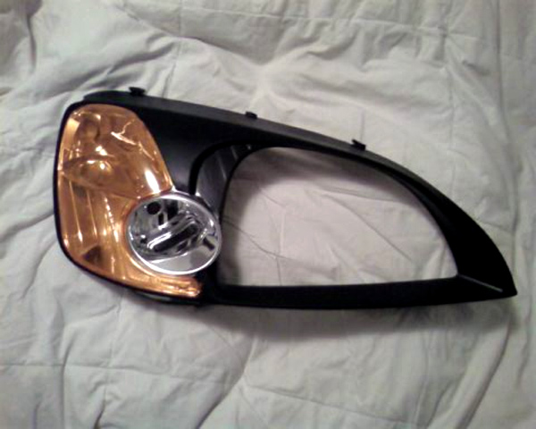

This is just after the black paint. I used Alsa Jet black basecoat, so it's flat when it dries.
After I finished it up I moved it into the bathroom to keep junk from getting in the paint and switched the fan on. To keep the fumes moving out.

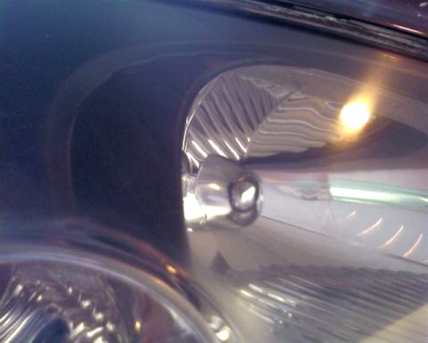

Here is a closeup of the clear I did, it looks ok in the picture, but in person you can see scratches. I'm going to wetsand and polish that out at a later time.
And a closeup of the black part. I taped over some chrome, so I hope I can get it off without peeling. The next question would be, if you can't tape on top of the chrome, how do you mask of the small tube area for the running lights?

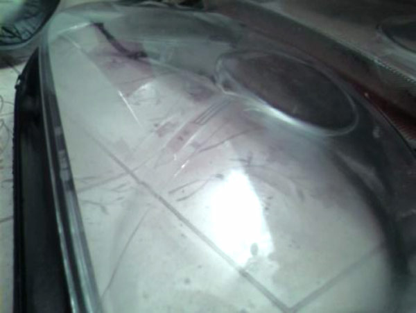

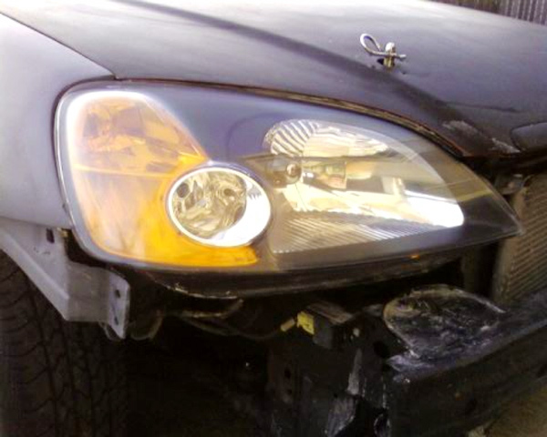

After I did the whole thing the lenses were kinda hazey, which I know no is because I didn't have the right grit sandpaper. Today I bought 600, 800, 1000 and I had 1500 at home. So I sanded the lights with all those grits, then used a rubbing compound with my craftsman orbital buffer, then after that I used the Meguiars Plast-x to get the final shine. Here are some of the pictures. It's like 98 percent perfect, but looks really good. So Im happy with it. Maybe another day down the road I'll buff it out more, but for now im cool.

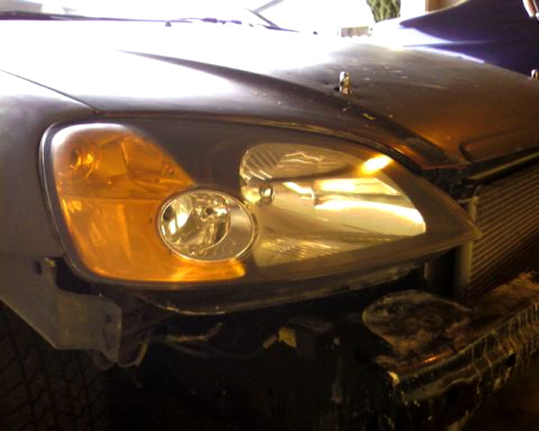

Here's a shot of the final product.
In this last one, it looks kinda hazy on the top, but it's just the reflection of the sky.

preheat all the tape before you remove it from the chrome. use blue painters tape.
do it slowly. if you're gonna remove your amber clips do it slowly. be extra careful. use an oven, not a hair dryer, goodluck

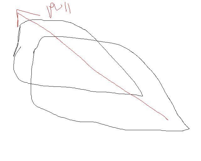

post it notes are good but they peeled on me too giving me a little overspray in some areas. oh well.
Be careful taking the silver housing out of the light, don't let it touch the glue. In fact you can even bend the glue back or remove the glue on the clear cover because chances are it'll get on your housing. Insert and remove the silver housing by pulling up and out on the turn signal corner.

Cool, thanks for all the tips, Im finished now, and I think Im going to sand a spot or two on the black, because I got a bit of a drip.
Now as for the clear lens on top, I had to sand the whole thing down with various grits then spray clear coat on it, you'll see it in the pictures. Unfortunately you can see some scratch marks on the plastic. I think I might wet sand when dry, then polish it good. I think that'll take care of it.

So I put everything back together and installed it. It looks good, but the plastic is hazey because I reconditioned them.
I also looked up Falkens "recondition your headlights" DIY thread. I used a rubbing compound and I got the plast-x and used a Detailing buffer, and it stiil came out hazey. I think next weekend Im going to get some more sand paper and do it again, because Im not happy with the hazey ness of the final outcome.
Anyone have tips on polishing the headlights to get them back to clear again?

Thanks dudes, it looks a ton better after the right grits and more compounding and the plast-x polish. I can't see any more scratches during the day.
But, later that night I flipped on the headlights and looked into the light, and you could see scratch marks, kinda like swirl marks. I'm wondering if I should get another rubbing compound that's more aggressive to cut through the scratches....not sure.

here some of my pics as info....
I putted them in the oven so all the MTF glue is like rubber so you can remove
the plastic front in 1 time.It was a pain in the butt removing the rest in the
groves.You need to clean them out verry well so wen you put them back that
it seal verry well.
