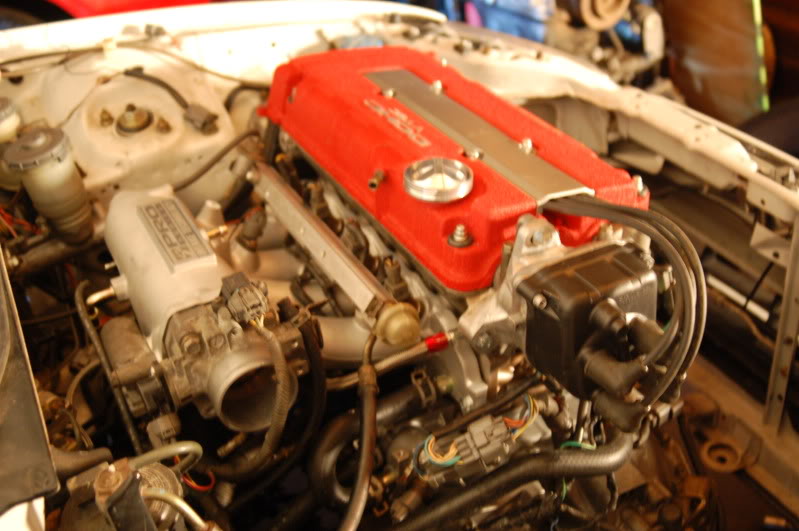

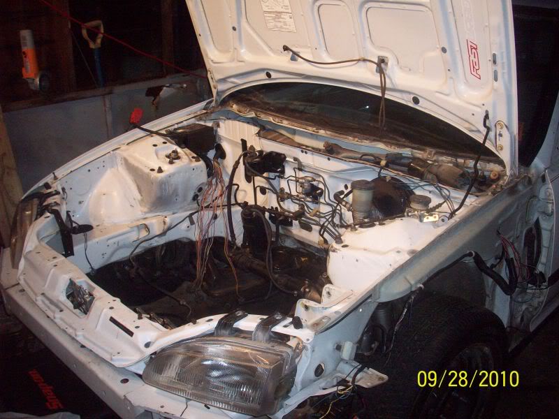

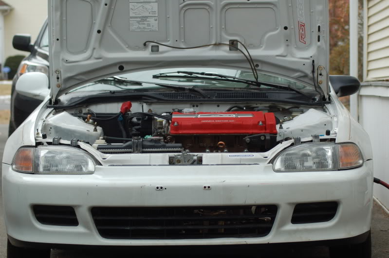

So I worked on the Coupe today! After Work I started to remove the D16z6 from the White EJ1!
The Engine Bay is a little Dirty so I am gonna really Clean it up and Possibly do a Wire Tuck and maybe one or 2 other things.
This is all for Now I have to save up the money to get the Motor Mounts and Pay Billy Back so I dont know when the next Update will be.

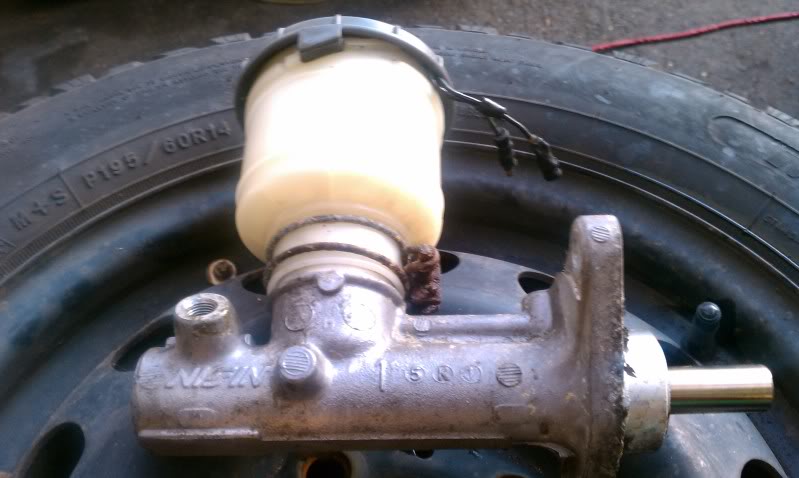

Brake Booster painted and Master Cylinder installed!

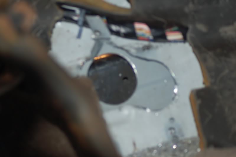

Automatic shifter hole plate made and welded still need to finish welding it!

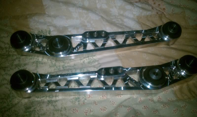

This is what will go on now! PIC FTW! OEM Bolts FTW!!
4 of these will be needed 2 for each side!
2 of these for the rear shocks!
Bam here it is!
PIC FTW is all I got to say!

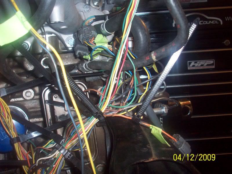

So today I figured I would finish the front suspension and start my wire tuck!

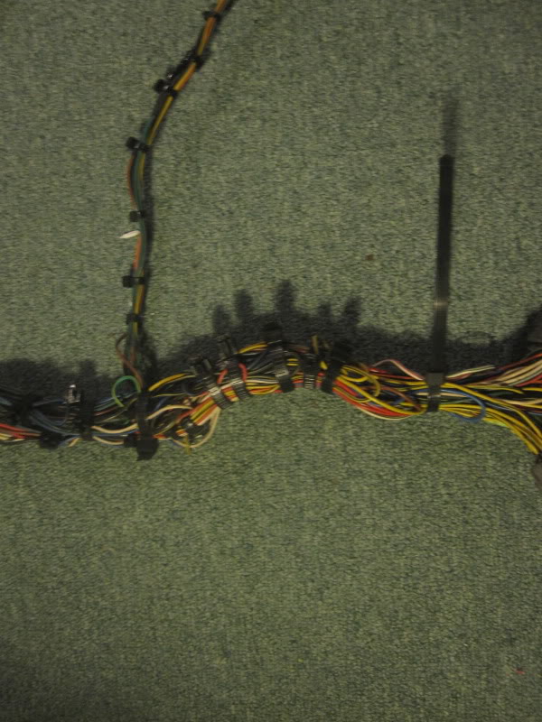

So since I have big fat hands I had my Girl do the wire tuck! Nothing was cut I depinned the connectors one by one and ran them thru the hole under the fuse box!

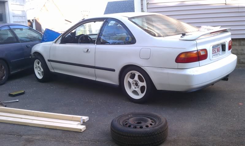

So here he is on his own suspension and its own wheels
So this is how he looks right now due to the rain coming this week!

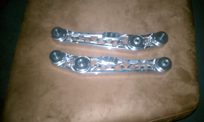

Technafit Brake lines for a Ej with DC rear trailing arms!!
I also got OEM 95 Civic EJ1 with rear abs e brake cables they bolted right up to the Integra trailing arms and the chassis of my EJ1!

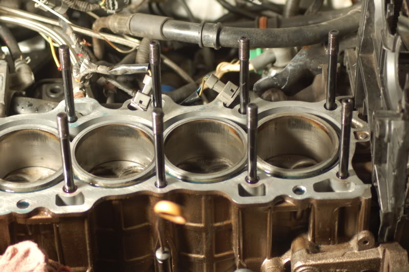

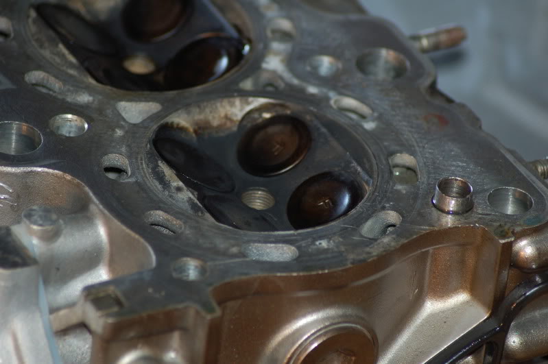

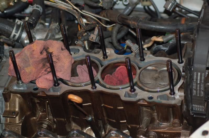

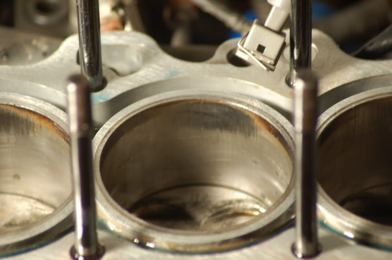

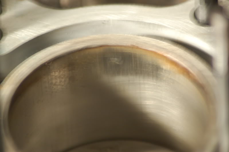

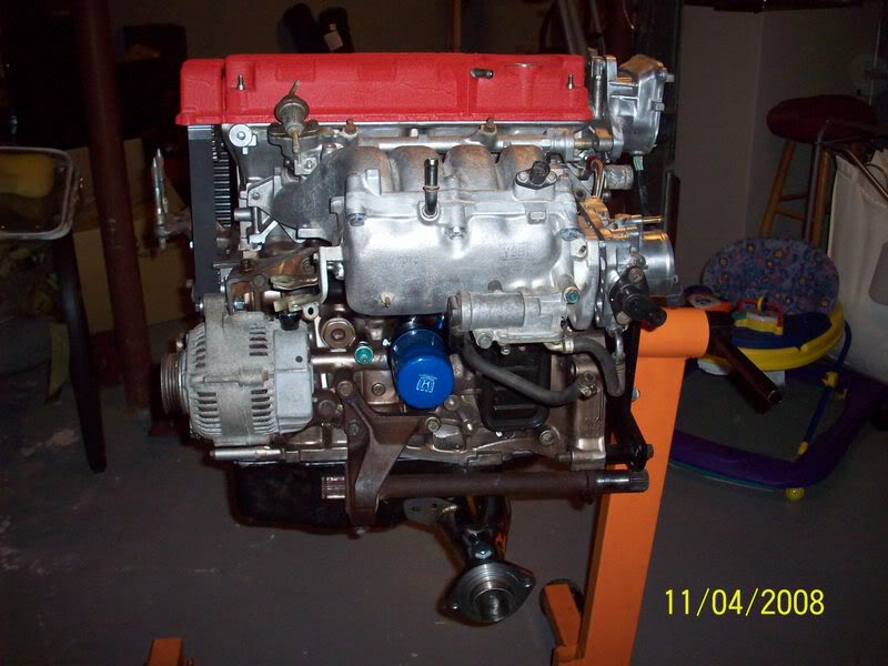

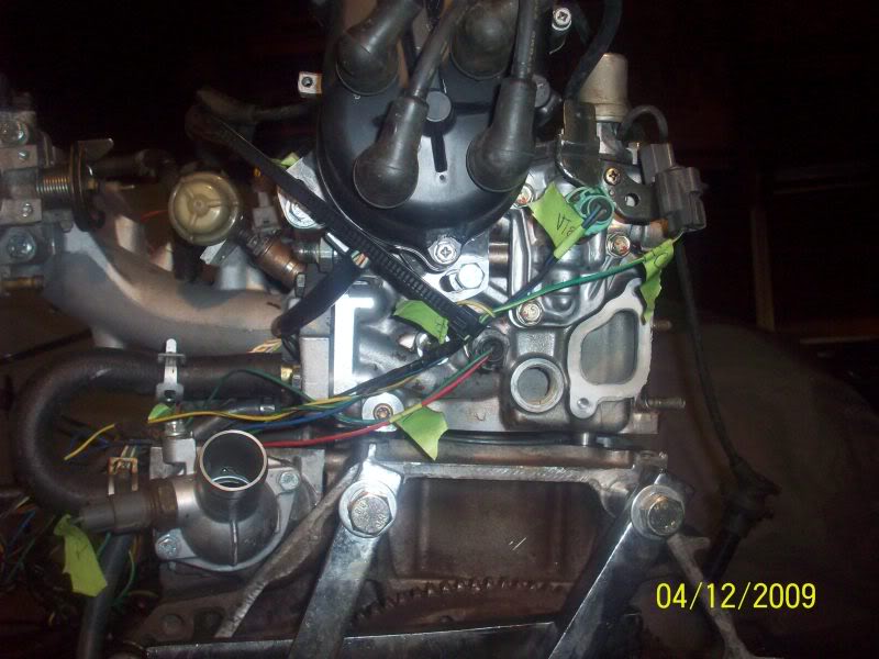

ok not too many updates except that the motor is now a short block in my basement and some serious engine plans are now in the works! I dont think it will be done this year but who knows!
broken bolt thats gonna be a pain to fix!!
just a mess
head
Stay Tuned!

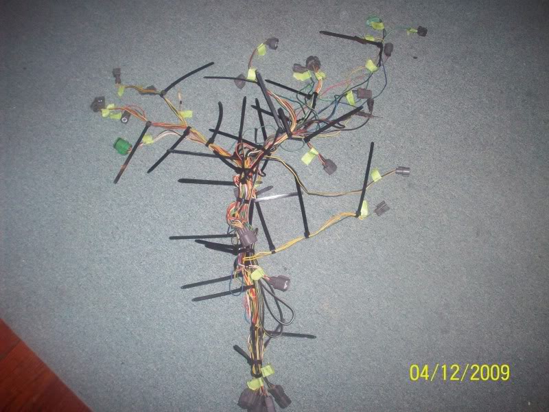

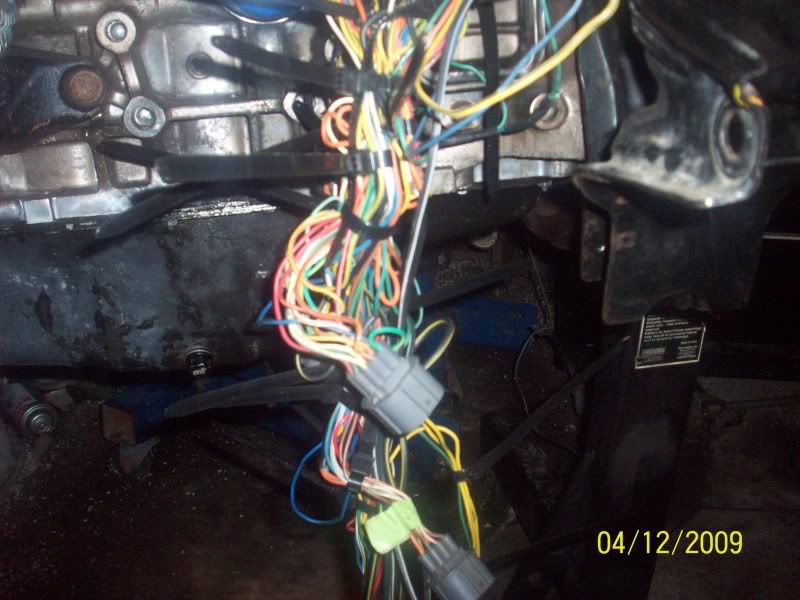

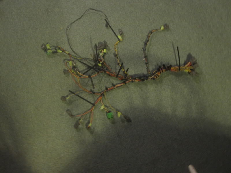

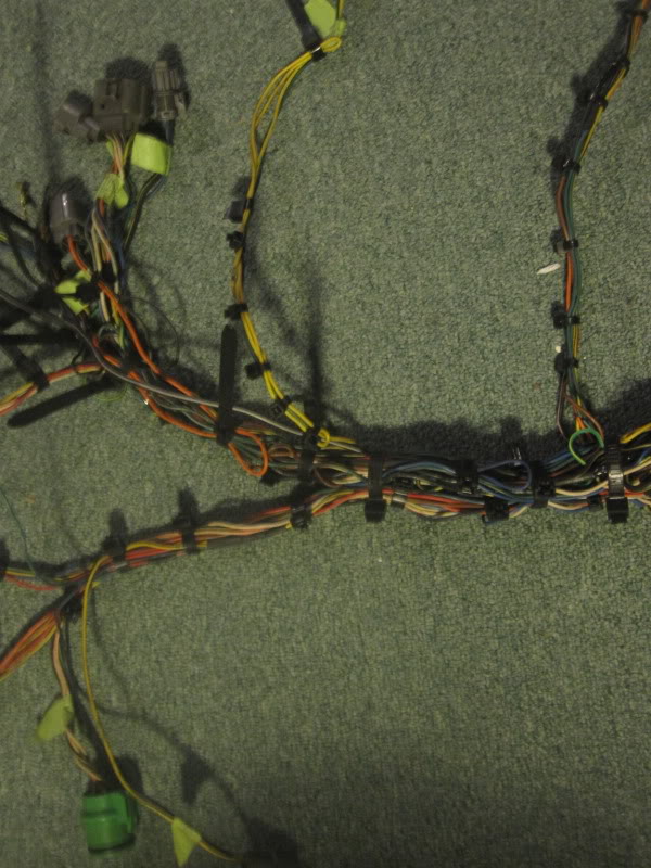

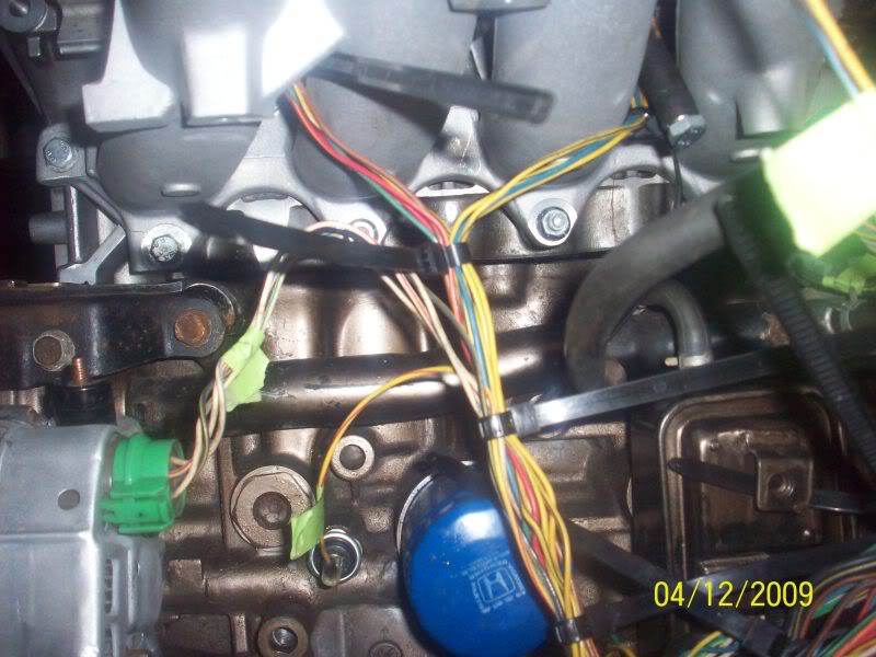

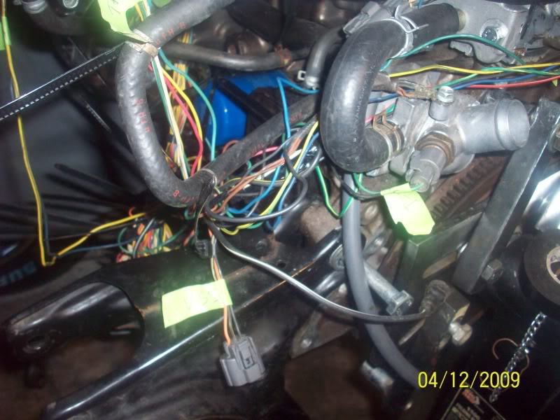

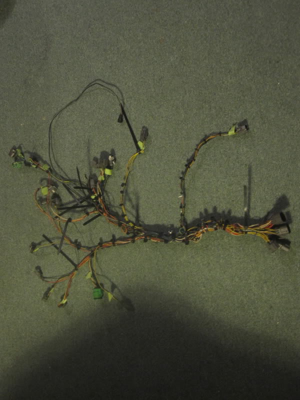

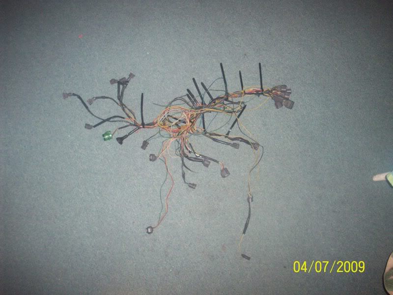

Ok so yesterday I pulled the dash back out so I can install the manual main wiring harness to make my auto to manual easier for me.
Now I need to get the gaskets for the airbox cause I am so **** about this kind of things.

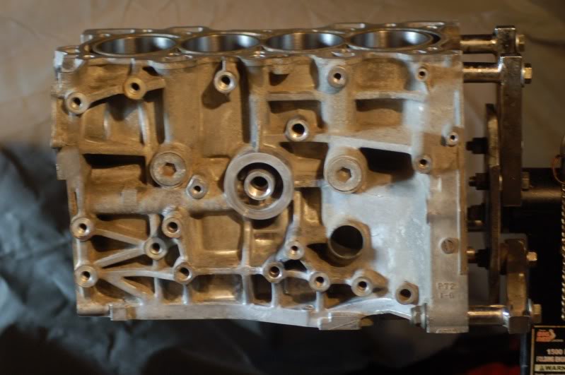

Today Fred and Lionel helped me take the Short block to the machine shop. I will prob get it back in about 2 weeks having it cleaned and inspected and doing some other things to it for the build I am doing now!

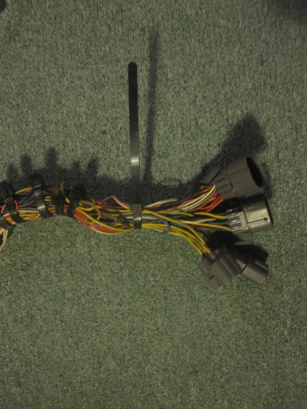

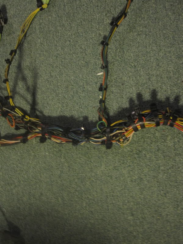

Installed the main wiring harness to a manual one!

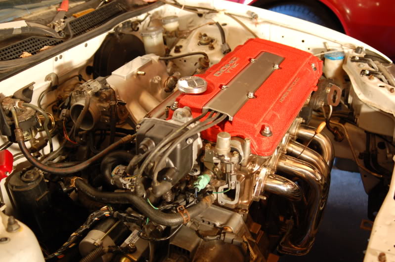

Ok here it is!

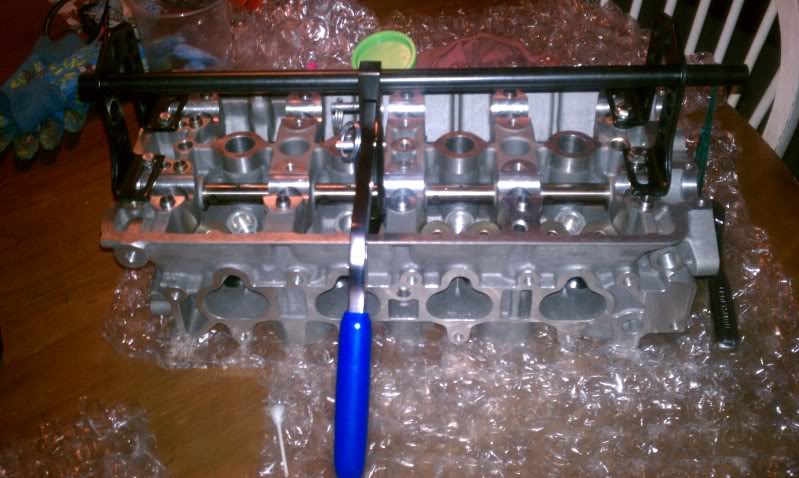

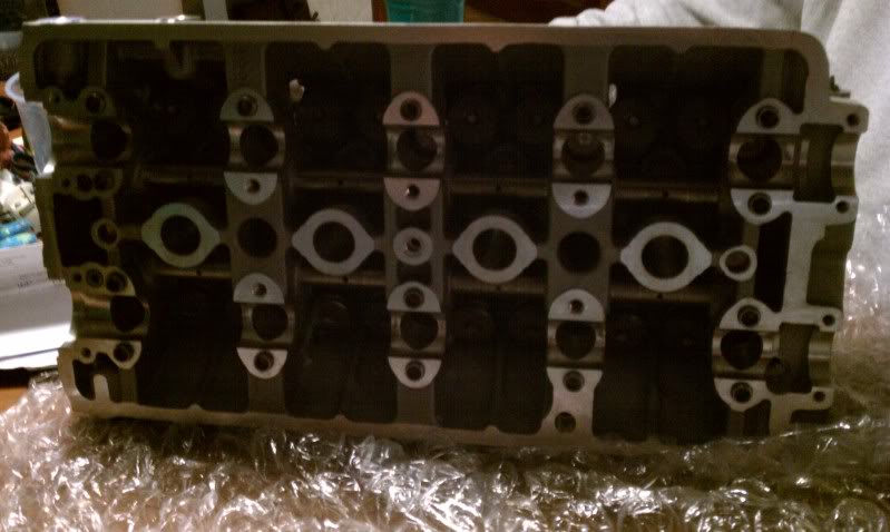

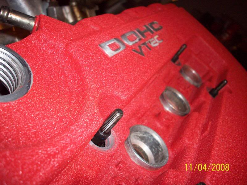

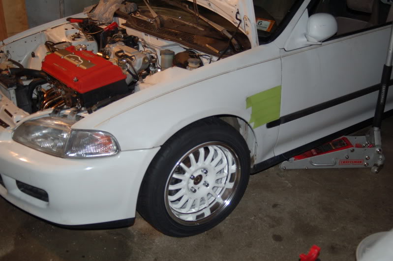

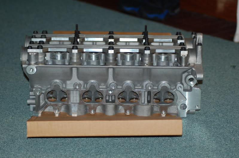

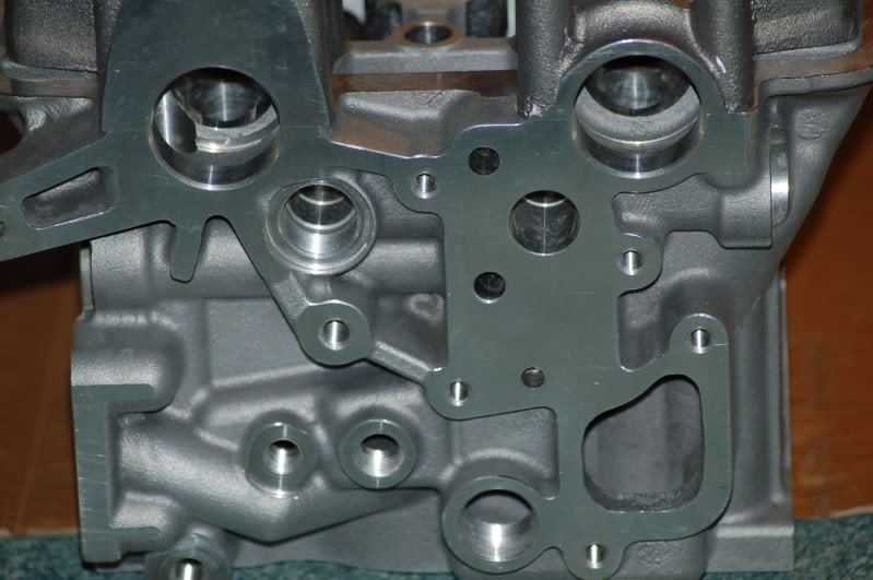

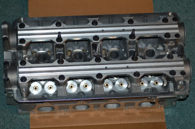

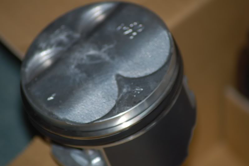

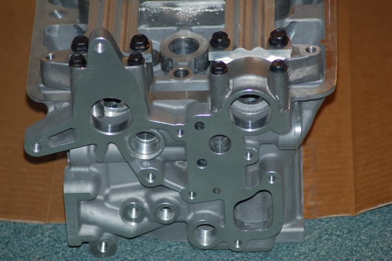

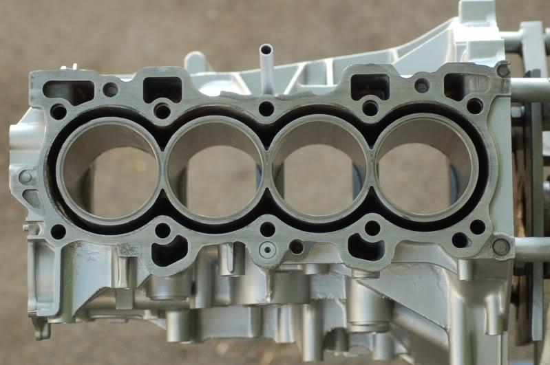

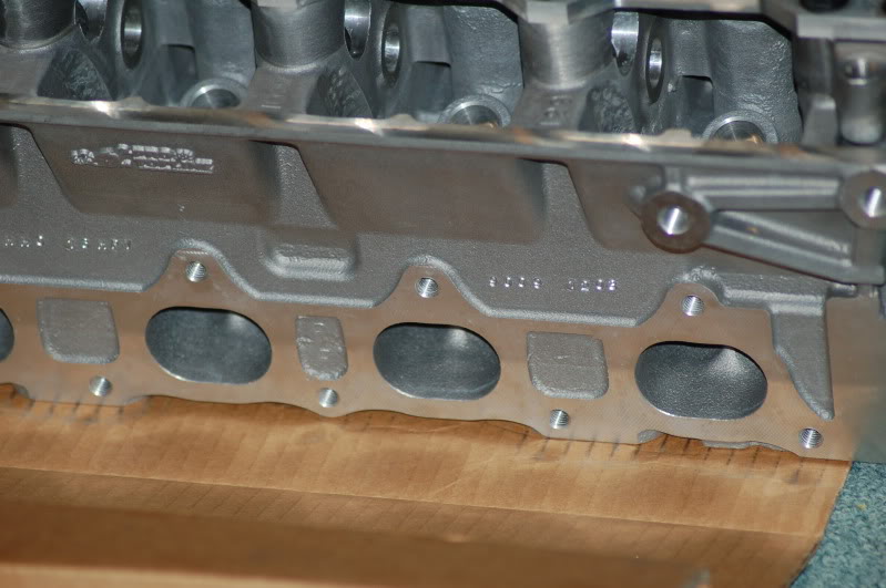

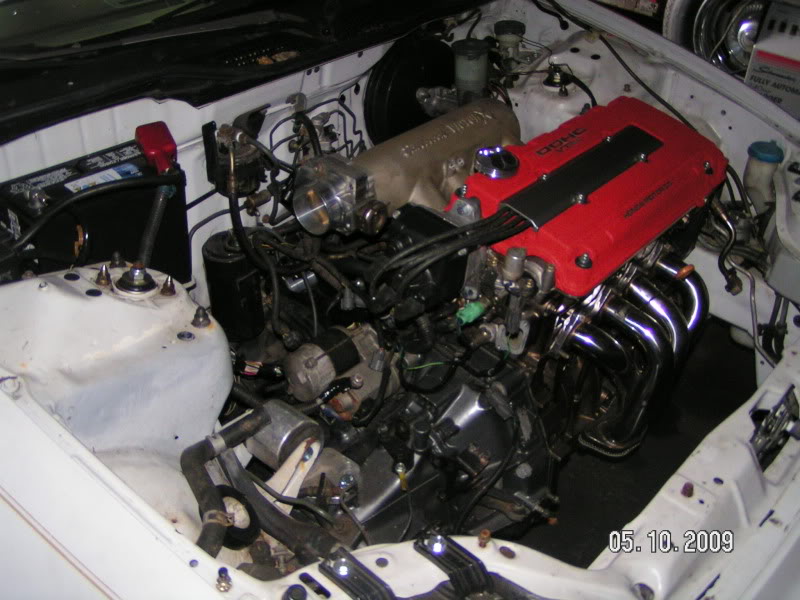

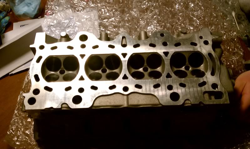

My plan as some of you may know is to go LS/Vtec! I have a 95 GSR head I purchased from Ryan aka 2Coupes! Thanks brotha for a great deal!
I bought a Vtec DOHC valve cover from a guy on HT.
So Now I am slowed down to making this work because of the money it will take to get the block done.

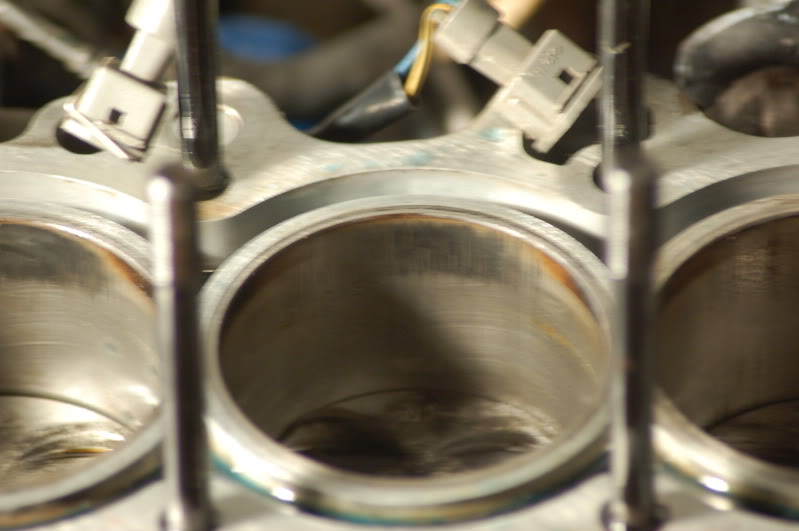

I owe the machine shop
345.00 for the work they have done plus new main bearings and connecting rod bearings
They want 200.00 more to bore the block 0.25 and rehone it

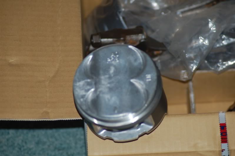

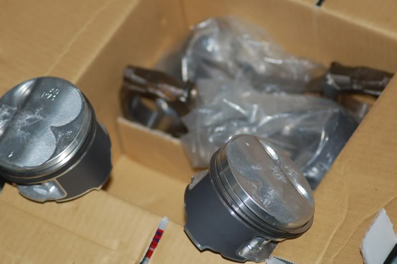

The GSR Pistons will cost me 226.96
That totals out to 771.96
I still need:
Unless I can find all these parts at a really great price or deal I dont see it done.:frown:

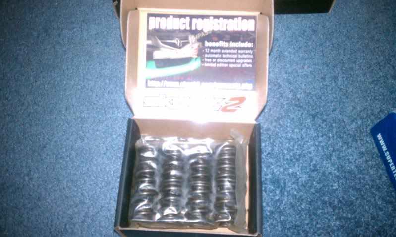

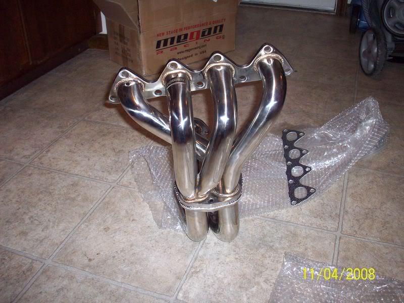

As promised here are the pics of the parts I have been accumulating
Thanks to Naman AKA Adam for these parts!

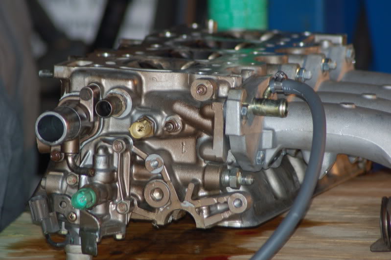

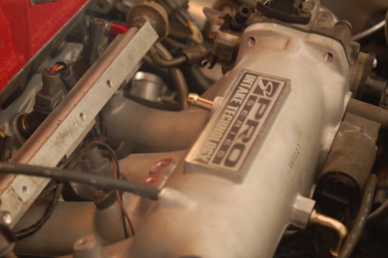

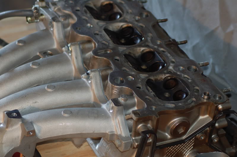

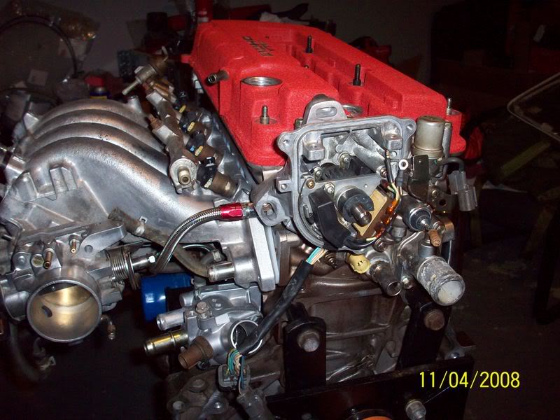

GSR Intake Manifold

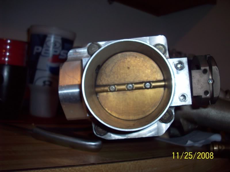

So I decieded that I dont want the butterflies in the manifold
Finished Product!
GSR T-belt Thanks again Adam!
B16 Valve Cover Gasket Thanks to CTB16 AKA Manny

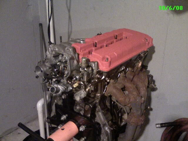

My Ls/Vtec Conversion
My Password JDM Intake Manifold Gasket
My GSR/B16 Valve Cover
Now some misc parts
Stay Tuned

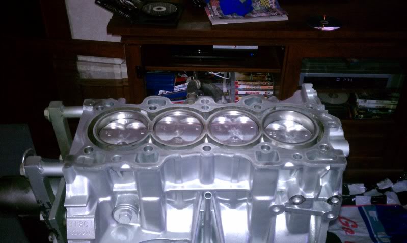

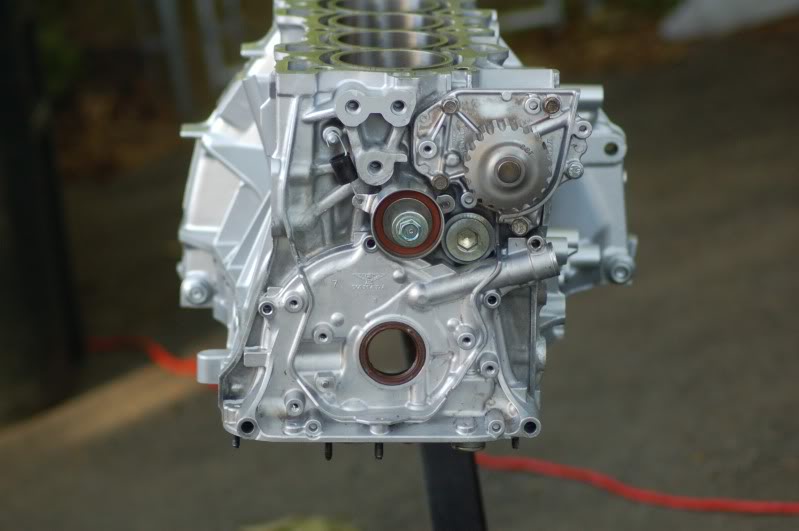

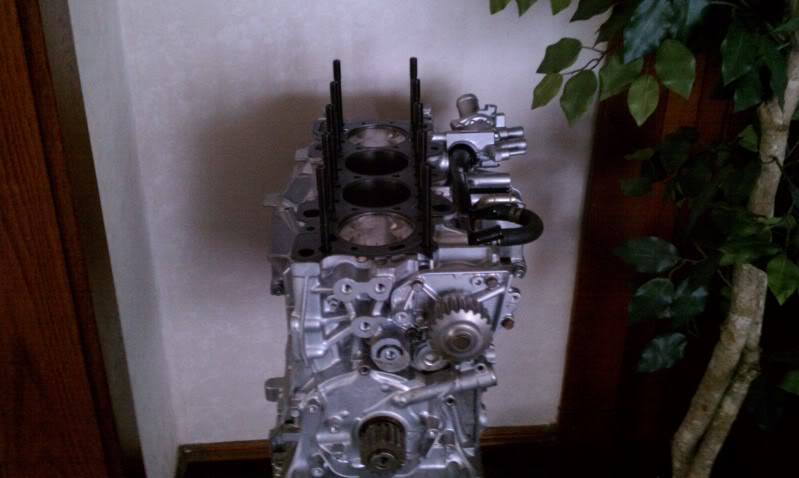

UPDATED 2 JULY 08

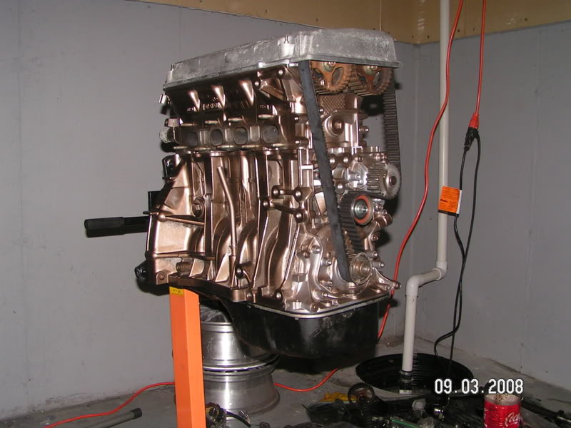

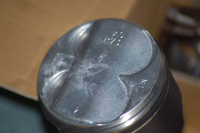

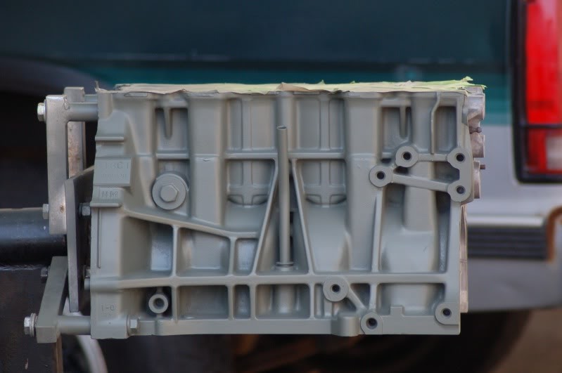

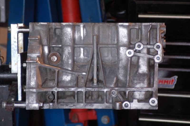

So today I am off from work and this is what I did!

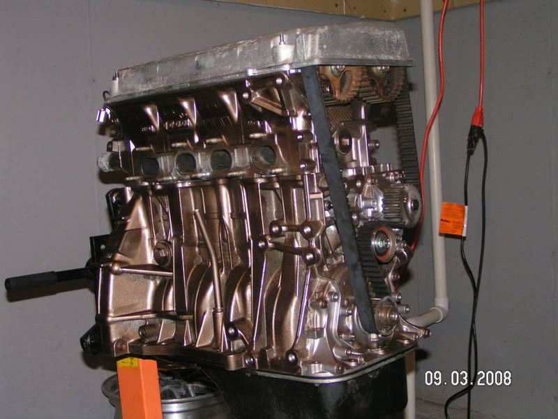

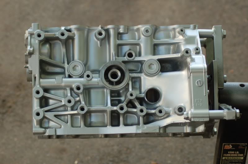

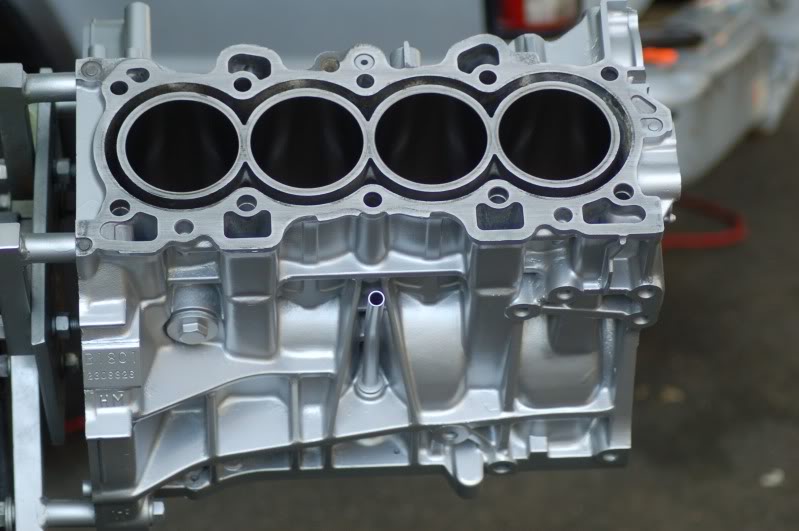

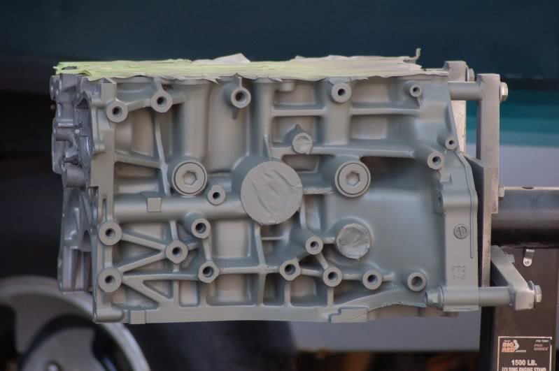

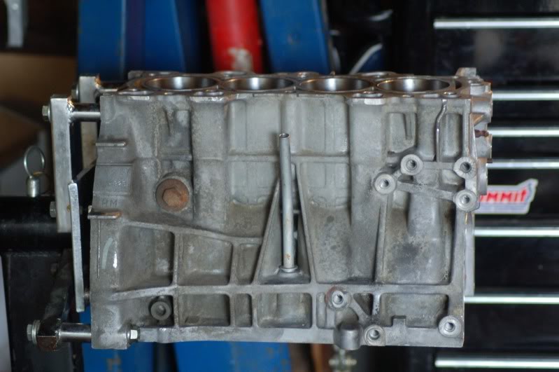

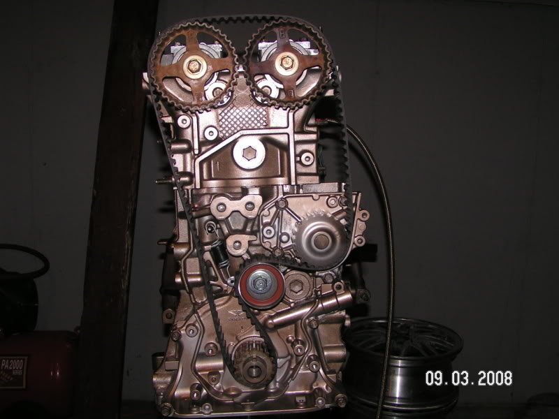

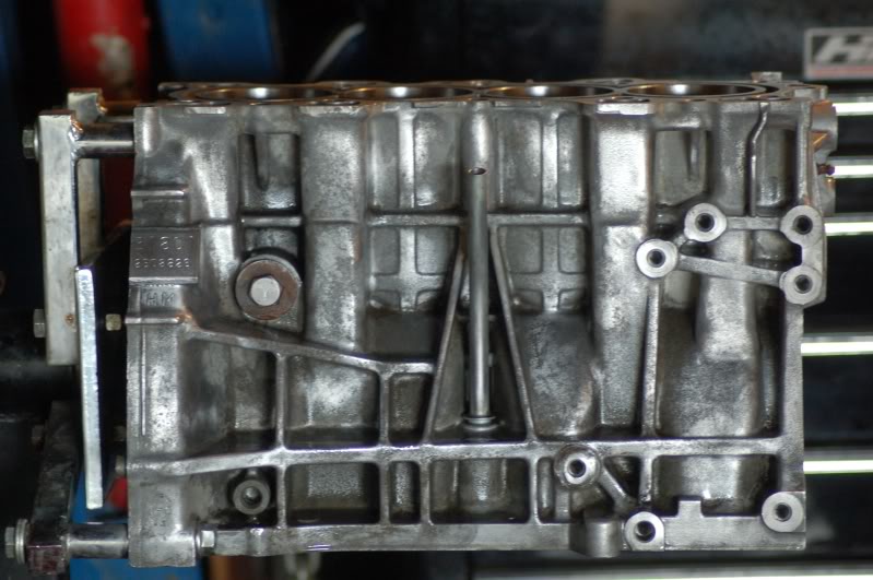

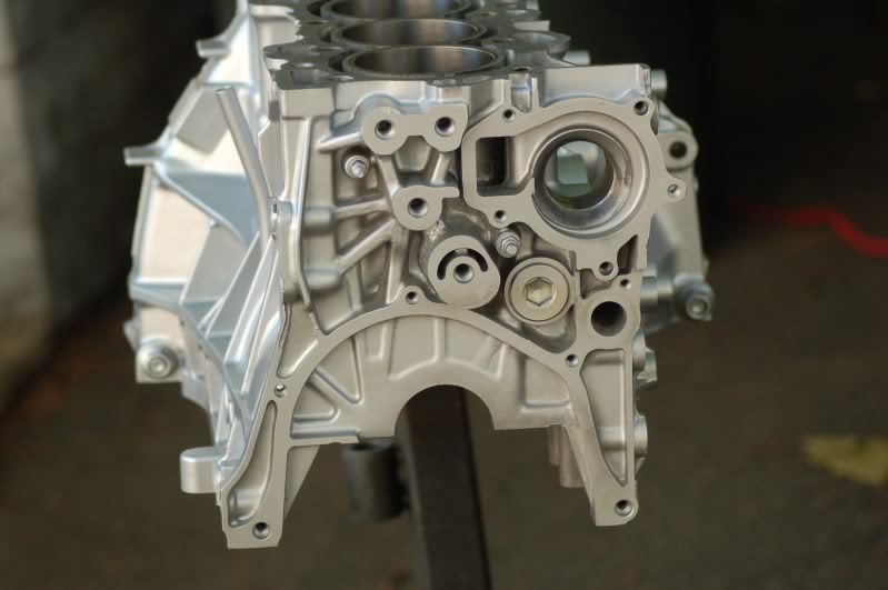

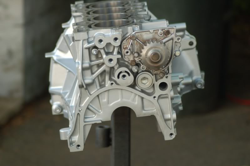

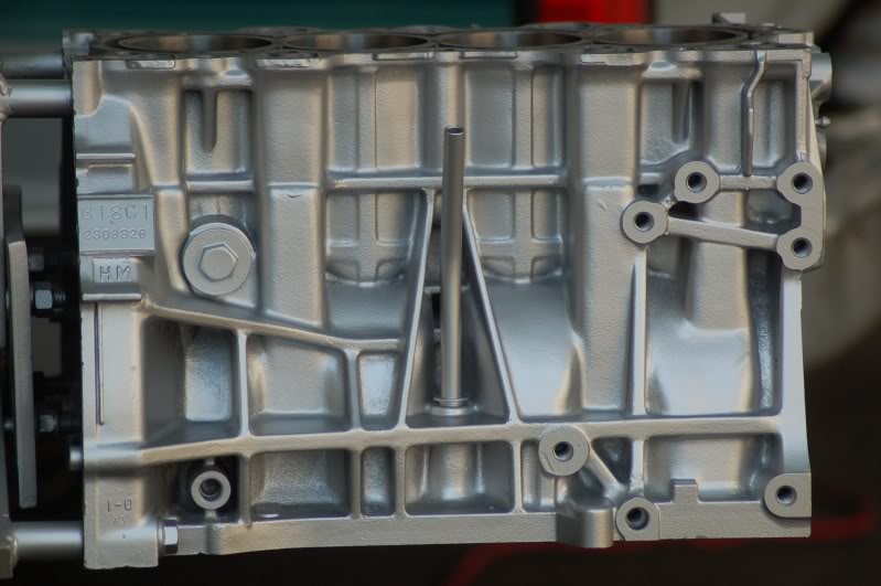

Block back home with me!

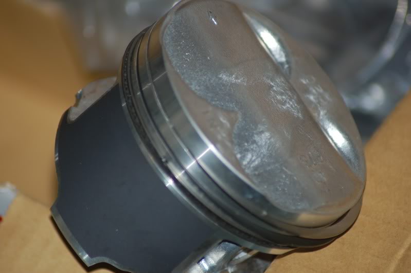

LS Rods on GSR Pistons had to get the small end of the rods machined to fit the pistons.
Painted the Block Bronze just my choice!

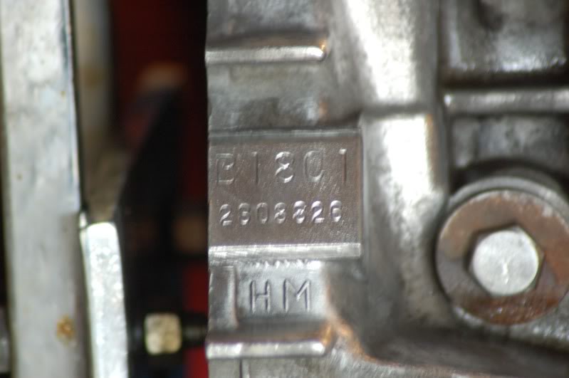

93 automatic D16z6
95 Integra 5 Speed B18B1 with exedy racing clutch and tricks to the trans!

Pedals are in
Booster and brake master Cylinder is out and getting painted
Clutch slave Cylinder line is in
Cleaned this up but did not get a pic of it cleaned

GoodBye Automatic Shifter!
This is the Hole that will have to be patched up since the manual car does not use it I will make a plate and weld it in.

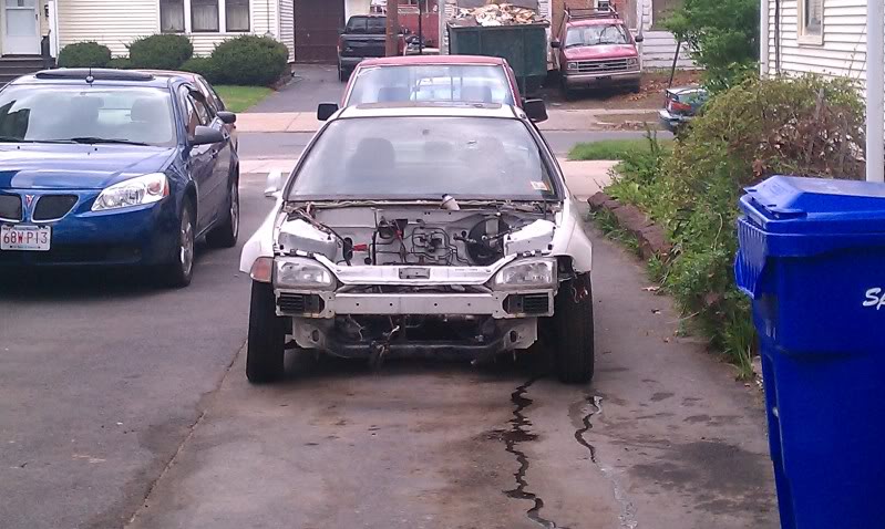

Stay Tuned!
Thanks to 2Coupes for this info on the steering wheel and parts!
These are my Fat Fives! They were painted black when I got them I have only been able to finish one of them due to the fact that I have been really busy with the Wedding plans and workin my tail off at work for the wedding!
just a mess
head
Stay Tuned!

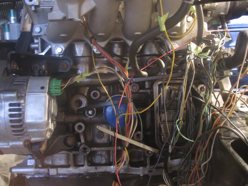

Be ready for some updates here soon again!
STAY TUNED
UPDATED 13 MARCH 08
Here's a piece of the puzzle
STAY TUNED
UPDATED 16 MARCH 08
Recent parts bought.
The wheels
Paint Stripper applied to start the process of fixing them how I want them!
after stripped and after I started to remove some light curb rash
How He still stands!
STAY TUNED
bump for this updated first post check out the progress or lack there of!
UPDATED 19 MARCH 2008
Got these in today!
STAY TUNED
UPDATED 21 MARCH 08
Ok here it is!

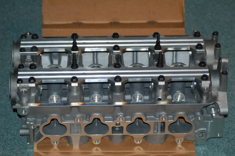

Updated 04 June 08
I got some cash recently from some parts I had here that I sold. So I am off from work today and instead of keeping the money and spending it on other things I headed straight to the machine shop and Dropped off 300 bucks to them I ended taking my crank my connecting rods with new bearings and the rest of the parts that were removed from the block here are the pics!

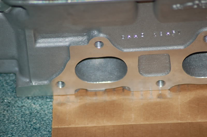

GSR Intake Manifold
Finished Product!

UPDATED 2 JULY 08

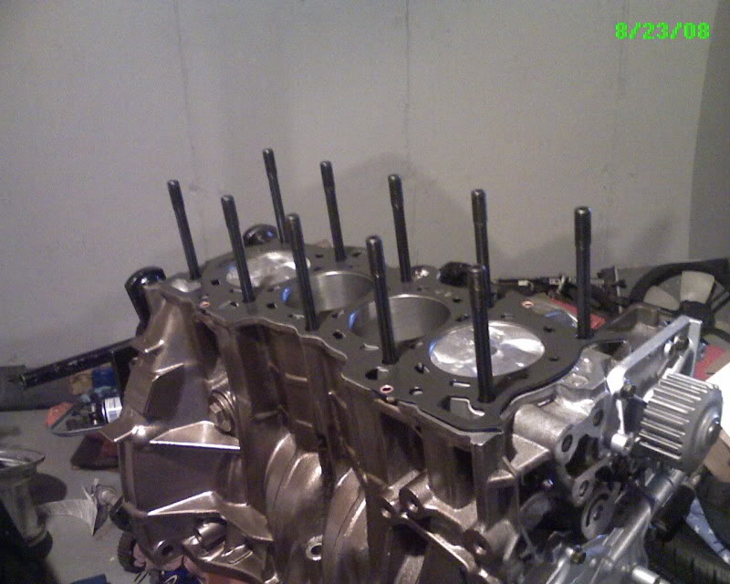

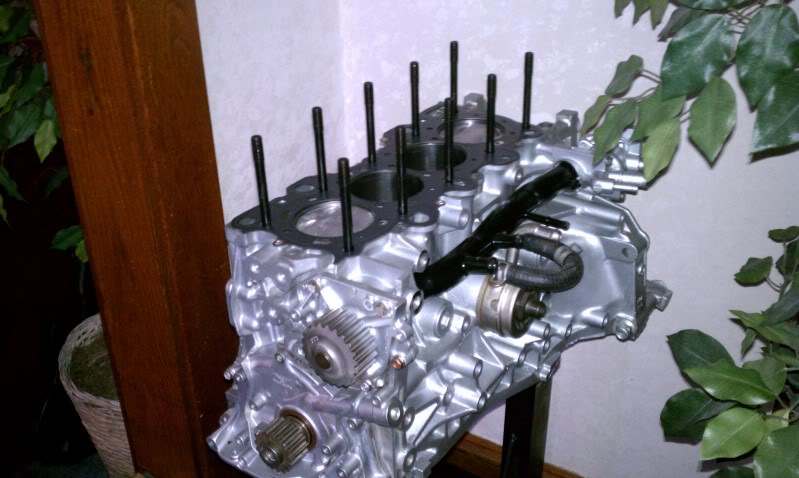

Installed the Water Pump!
Stay Tuned
UPDATED 14 JULY 08
Ok so I finally got time to install the oil pump
Installed the new rear main seal on the right side plate or what ever this is called
Windage tray and oil pick up installed still awaiting some parts to come in at work
Stay Tuned

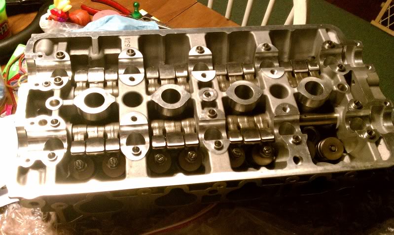

So on the 16th of July it was Officially 2 years and the Coupe is still not on the road! I wanted to get the engine done by the end of this month but certain things happened that I can not be sure and I really doubt It will be done this month.

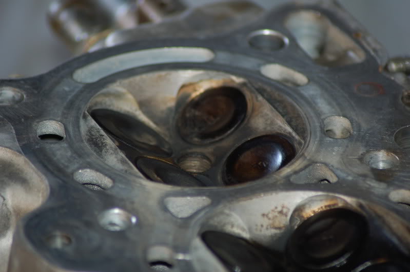

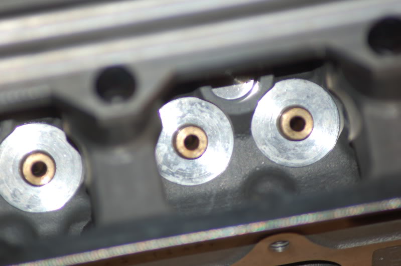

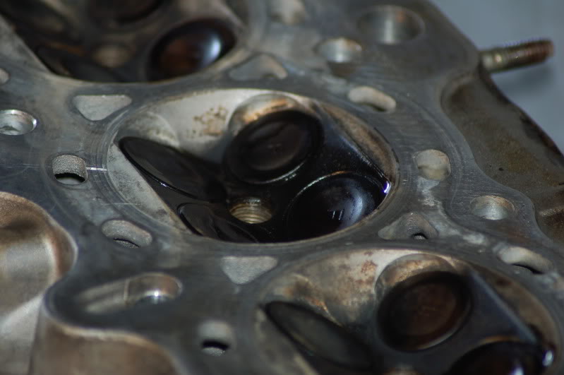

Small update I had the Head at work and I removed the valve seals and cleaned up the valves the Exhaust valves were very dirty I also with the help of a Co worker Mike aka wantacoupe Lapped all the valves so they would seat really well with the head.
These pics were taken with my cell phone from work and just at the end of installing everything as I was only able to work on this while I had no work at work
Intake valve seals installed and Valves back in
Exhaust valve seals installed and Valves back in

If your replacing the valves, you should replace the valve guides too. Your build is very cool though, it will def be a very nice JDM ride. And yes, that guy did an amazing job on cleaning the interior up- it looks brand new.

Updated 3 Sept 08
So this is my progress so far!
Stay Tuned!

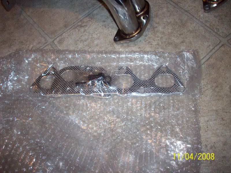

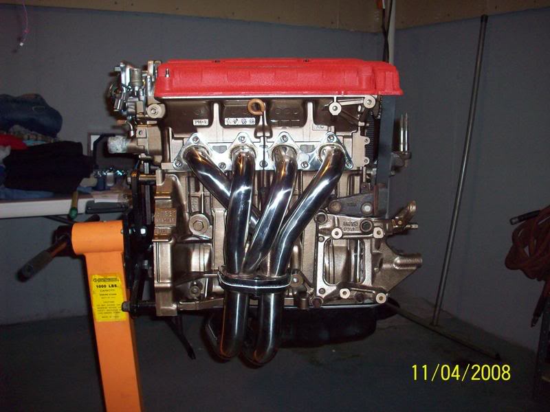

UPDATED 07 NOV 08
A lil update.

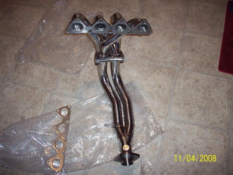

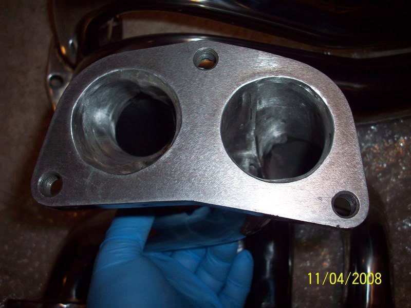

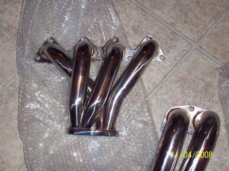

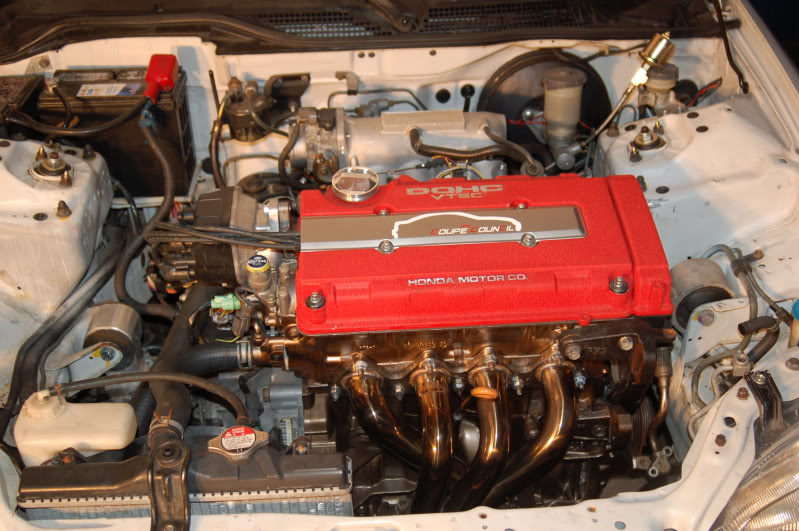

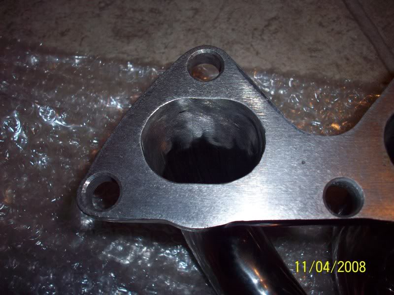

Chrissy got me a Early Christmas Present cause she thought the oem manifold was too rusted and ugly to have on this motor since we have put so much time and money into it.
Whats this?
To This!

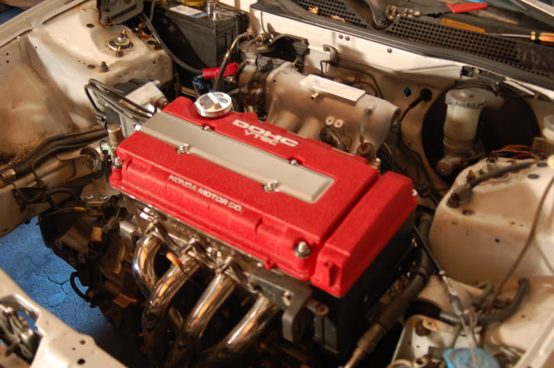

This is one of my Favorite shots of my Motor so far!
The Motor almost done!
STAY TUNED

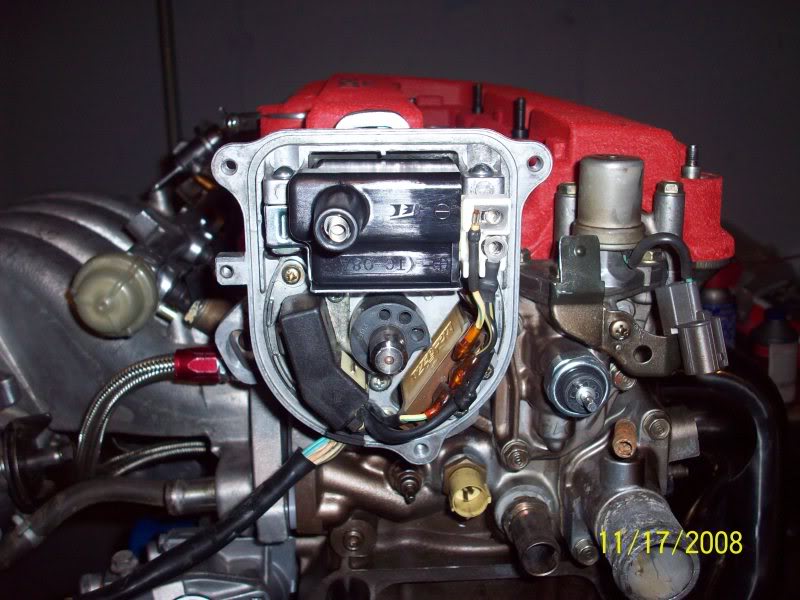

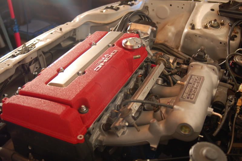

Updated 18 Nov 08
minor update found a few more pics I forgot to upload

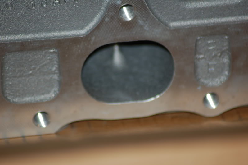

ARP Head studs Oem Head Gasket
Vtec Head installed
Another Shot of Glory

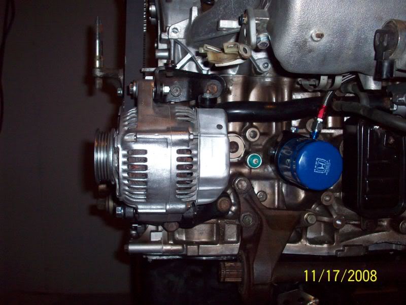

Ok so I cleaned up the Alt the brackets and painted them

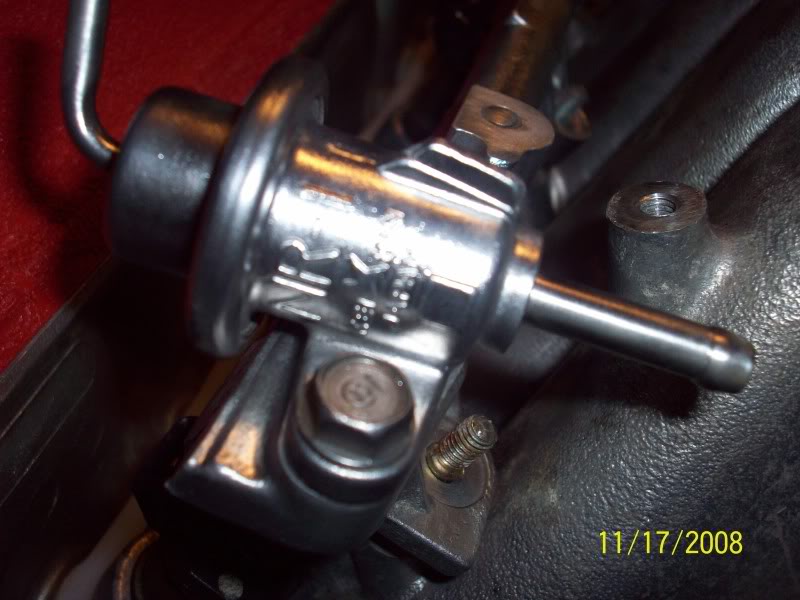

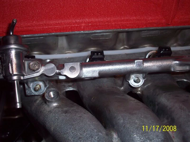

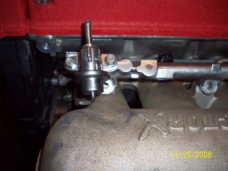

cleaned up the fuel rail and oem regulator
Installed my New OEM Coil
Now just awaiting the arrival of the Timing covers and the engine will be done!
Stay Tuned

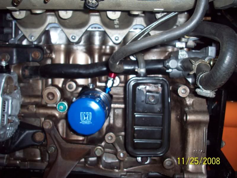

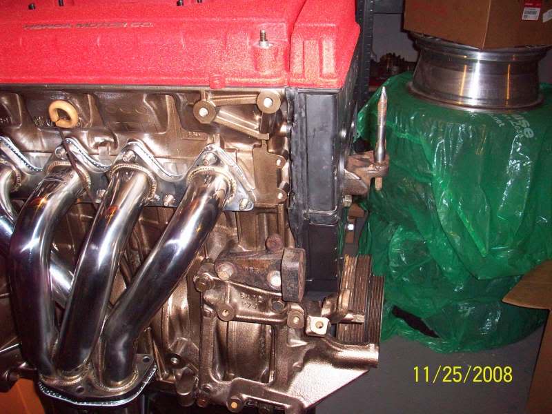

Updated 25 Nov 08

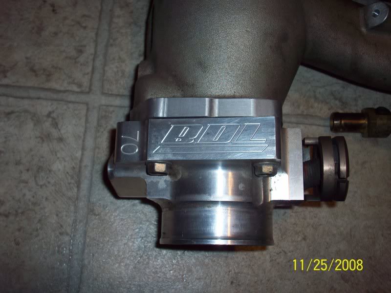

So today when I got home for work I found a box on my steps. Jason aka JLCoolman from jdmcivic.com hooked me up with this! For sure one of the best people I have ever met online! THANKS JASON!
Here it is!
Baby Ejay Helping to open it!
Chrissy and Ejay!
One more!
Tada!

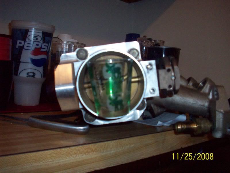

"Hmmm This looks interesting what is it?"
BDL Throttle Body 70mm FTW!!!
Standard sized shot glass!
Edelbrock Victor X
Test Fit!
Monstrous!
Viewing clearances!
Some more test fitting!
My Timing covers arrived on Friday! rear gasket and upper timing bolts arrived today!
Installed!
My new Favorite Shot so far!
Thanks again to Jason I could not have gotten this close without your help!
Stay Tuned!

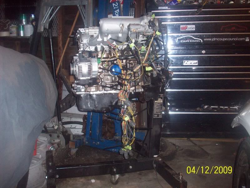

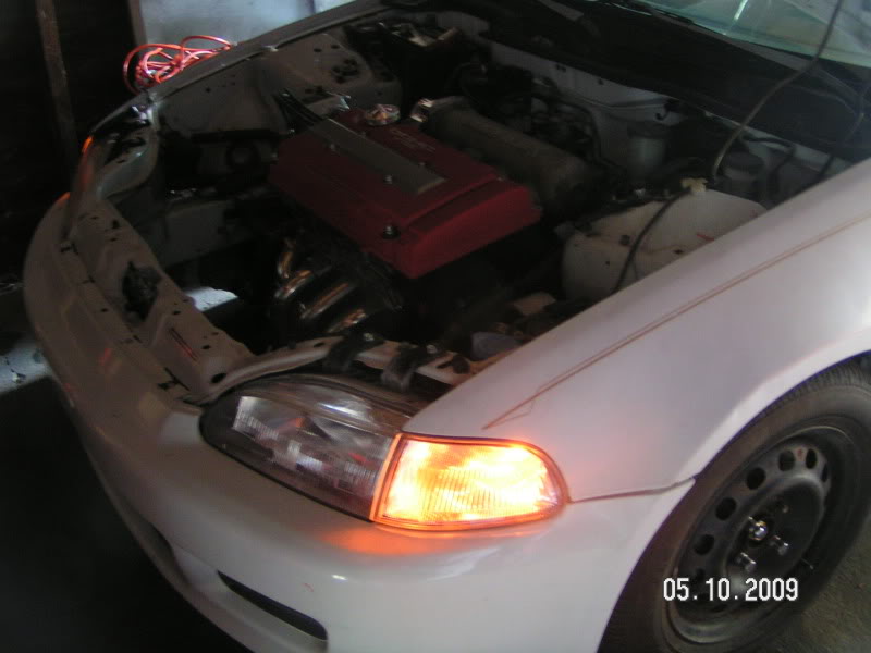

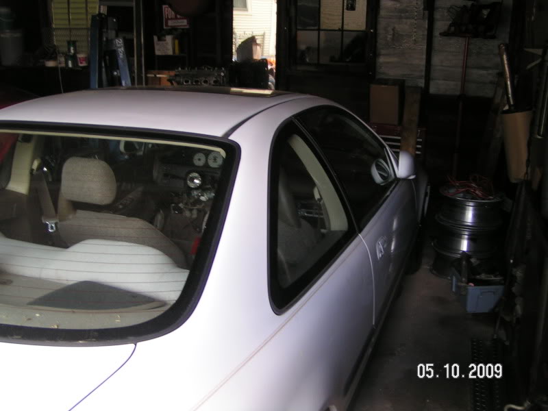

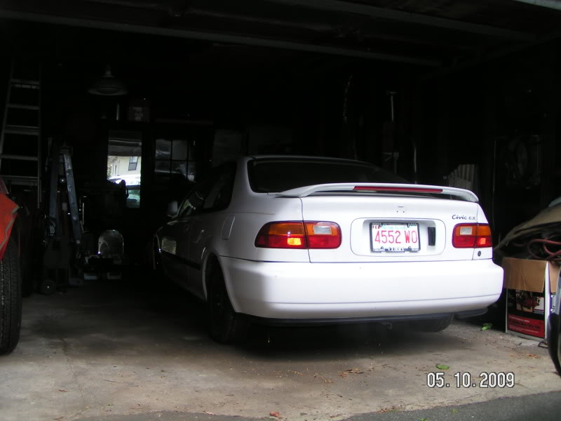

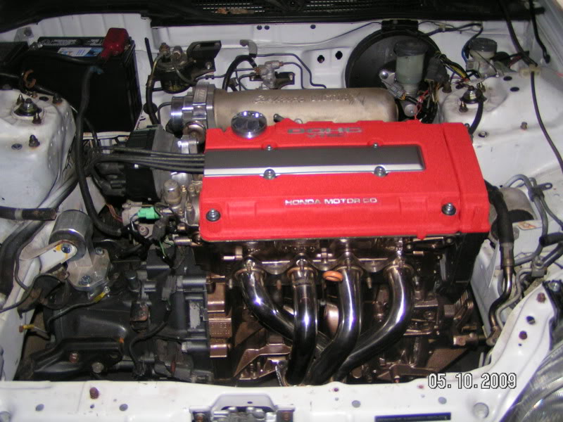

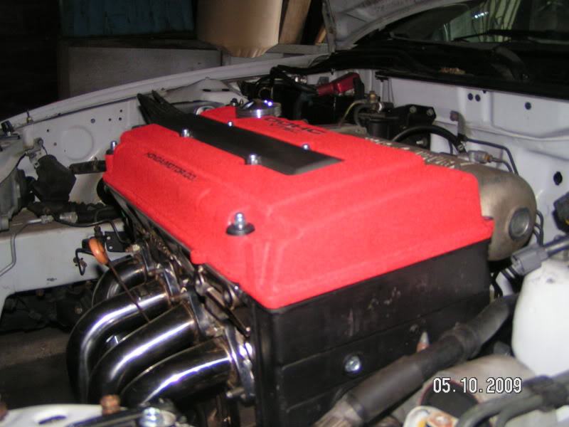

OK So today I was able to work in the garage and get it some what organized I still dont have electricity in there so until I get some extension cords or get an electrician to help me out I wont work on the coupe.
Here are some pics of the Coupe in the garage and some shots of the engine installed. The power windows are not working and the fuel pump is not working I think I missed connecting some plugs when I did the wiring harness I have to pull the dash yet again!
Stay Tuned!

So today I got some bad news from the Engine
uch:! Not gonna post it but I can say EjWone will not be out this year! :sadwavey:
STAY TUNED
Updated 31 Jan 2010
At 10:26 AM on 27 Jan 2010
I Did cylinder compression test and found cylinder 1 to have 200 psi cylinder 2 to have 190 psi cylinder 3 to have 225 psi and cylinder 4 to have 225 psi
I then Did cylinder leak down test and found cylinder 1 to have 25% leak cylinder 2 to have 9% leak cylinders 3 and 4 were at 0%
I believe after talking with Jason from Suja1, Lionel and some people at work that I have a Valve that is not sealing properly, a burnt valve, a worn valve guide, or a combination of all of that.

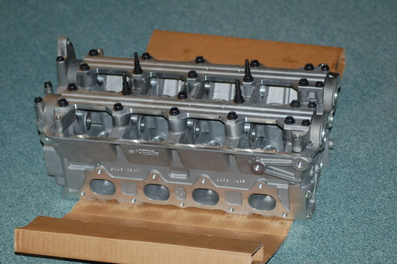

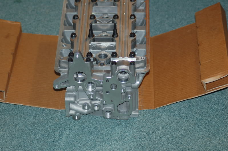

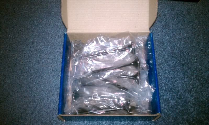

For that reason EjWone will not come out this year and I am contemplating whether or not I should continue this build or give up all together! Its really slow at work and I work by the job not the hour I have not made more than 33 hours in the last 3 weeks. Chrissy has been there for me from the get go and we have recently bought her a car as her project car. We have the Pilot and the S10 as daily drivers.
I priced out the valve, springs, retainers and the machine shop job for the head. It totaled out to more than 850 dollars. So as of now EjWone is on the back burner again until I figure out what I will do with it! :sad:
STAY TUNED

So due to the bad compression results in cylinder 1 and 2 as well as the bad leak down results in the same cylinder I removed the head yesterday. I have a set of used gsr valves springs and retainers I got from a buddy at work who is building a turbo gsr motor for his Ej1. So now I dont know if I should change just the valves in the old head or transfer it all over to the new head.
STAY TUNED
UPDATED 08 MARCH 2010
Well just checked on the motor in the coupe and found out that the top of the cylinders are scored up and down feels like its grooved with my finger nail! I will post a pic asap and I am upset so I know for a fact EjWone will not roll out this year!
STAY TUNED
UPDATED 09 MARCH 2010
SO here are the pics i dont know what i am gonna do now!
STAY TUNED
UPDATED 11 MARCH 2010
Just a minor update today I took the Block I am building now to work and stripped it of all the parts it had in it in order to take it to the first machine shop who is going to inspect the cylinders for me and I know they will be good enough just to hone and install the pistons and rods I am picking up from Adam aka Naman. With Chrissy's Help I am hoping to get it done within a month! I will transfer alot of the new parts I have on my ls block over to the GS-R block!
I will be building a GS-R for my EjWone!

SO the GS-R Block is at the machine shop all is good!
Cost of Inspection of block $10.00
Cost of Cleaning the block $50.00
Cost of Honing the block $25.00

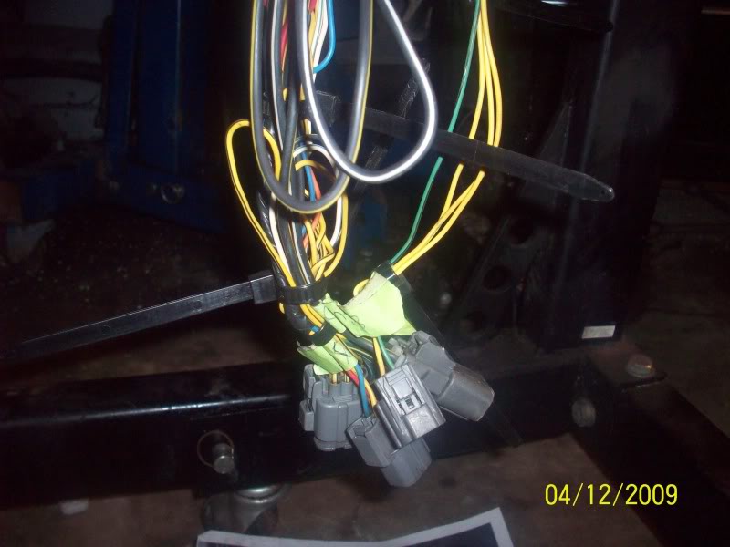

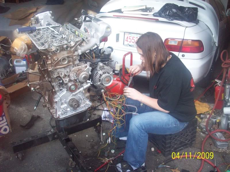

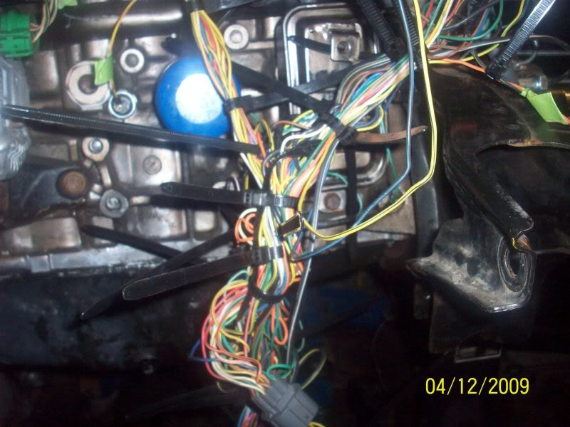

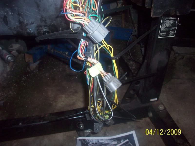

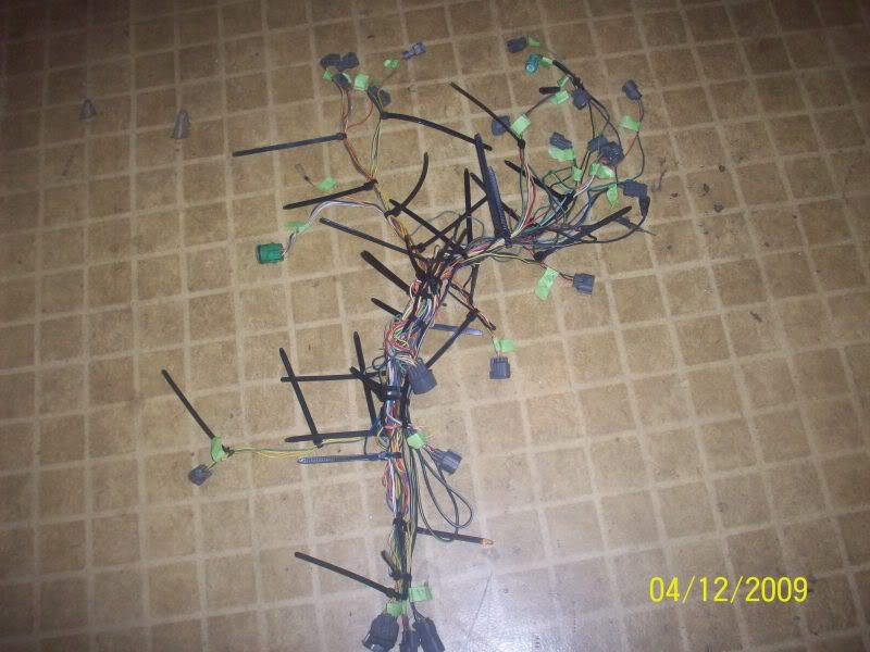

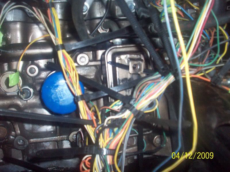

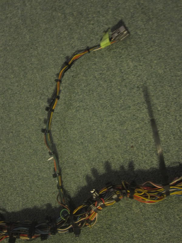

So I have been trying to do a full wire tuck for a while and since i pulled the engine out and am awaiting my GS-R I figured now would be a good time. Here are some of the pics from the start to now. Thanks go out to Chrissy and Brandon as they are helping me out a lot with this
not finished yet and I have to also loom it! Soon will be complete. I now know why they charge so much to do this!
STAY TUNED
UPDATED 17 APRIL 2010
So I didnt like how my wire tuck was coming so I worked on it today! made a lot of changes and now it gonna get sent out to be sleeved
Tomorrow gonna work on pulling in the main harness and making the hole out the firewall

UPDATED 24 MAY 2010
So today I started my Vacation from work I had planned to have the motor out the machine shop by now and have everything I needed to get the car rolling by the end of the week! As luck would have it I can not do it due to financial issues. Its been slow at work lately and My bills are not up to date as of now! Last week I got a call from the machine shop and was asked to call them back and touch base on them with what is going on! So I called them back and was told that I need to bring in the connecting rods so that they can install the pistons on them. I said ok that I would take them Today because I was gonna be out of work for the week.
So today about 930am I went to the garage and got my used pistons and connecting rods. I grabbed the SuperTech Piston rings I had bought because I heard bad things about the Top Line piston rings but the pistons were good as OEM as I read online everywhere. I also grabbed my crank as I asked the Machinist to check it and polish it for me. Hopped in my S10 and drove to the Machine shop which is like 10 min from my house. Got there and looked at my pistons and was in AWE! Top Line Pistons are Identical to OEM only bigger to meet peoples needs. Gave him the parts I had and he said to me "You wanna take the block with you"? I said well I dont have any money for you today and he said you already gave me 100 right? Take the block as I need space in my shop. I was stunned! He said I will mount the pistons on the rods and check balance and polish your crank. I will give you a call when its all set.
This is what happened.
GS-R Block bored .50 over and honed inspected and cleaned. In the S10 on the way home!
This is how it looked when I got it on the engine stand.
After a Few attempts with wire bushes
Etch Primed
High Heat Aluminum painted
Water pump, tensioner, and oil pump mocked up
I hope I can come up with what I still owe the machine shop so I can get even more motivated!

UPDATED 07 NOV 08
A lil update.
Whats this?
To This!
STAY TUNED
Here it is!
Chrissy and Ejay!
One more!
Tada!
Edelbrock Victor X
Test Fit!
Monstrous!
Viewing clearances!

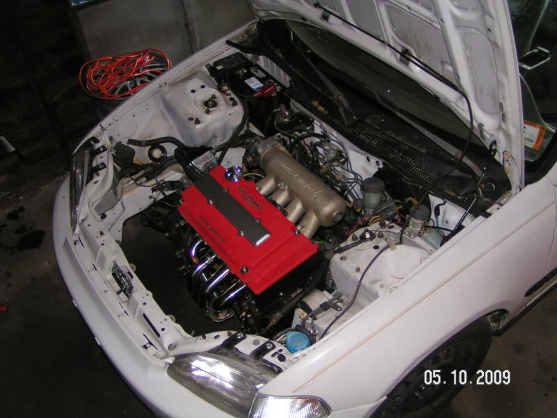

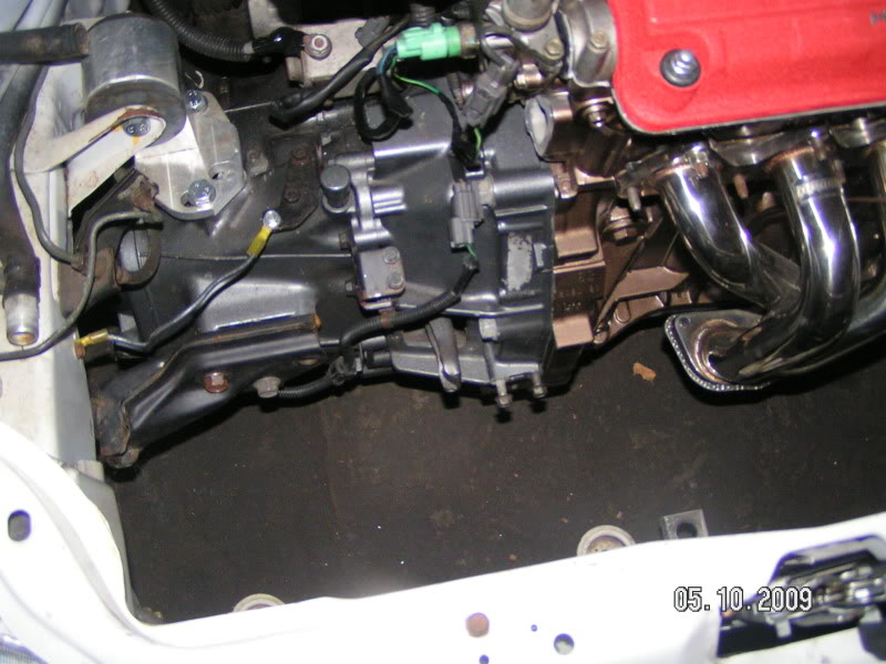

UPDATED 10 MAY 09
uch:! Not gonna post it but I can say EjWone will not be out this year! :sadwavey:STAY TUNED
Updated 31 Jan 2010
STAY TUNED
STAY TUNED

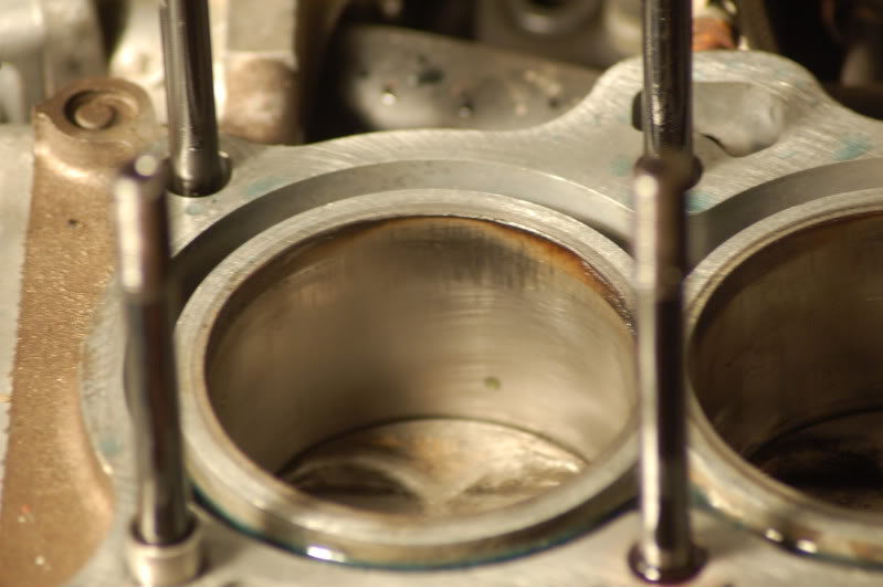

STAY TUNED
STAY TUNED

UPDATED 24 MAY 2010
Etch Primed

UPDATED 20 JUNE 2010
Went out today and took the dash out and the hvac stuff drilled a 2 1/2 hole for my engine harness to go inside the cabin with a EK harness plug I will post pics soon as my camera was dead.

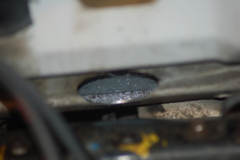

I bought a 2 1/2 in hole saw and made the hole for the wire tuck
Interior shot
engine bay shot
Got My Pistons out of the Machine shop!
USDM ITR Pistons 81.50mm
Stay Tuned!
Interior shot
engine bay shot

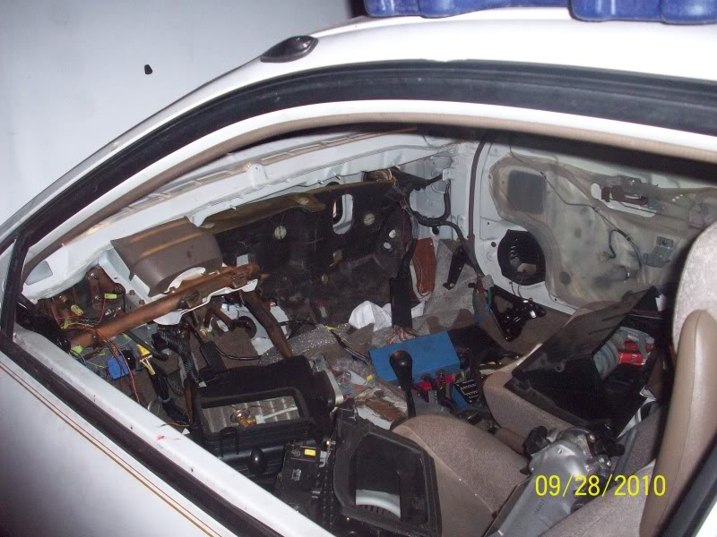

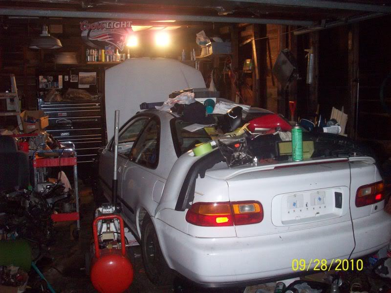

UPDATED 28 SEPT 2010
No real update since I got let go from work the 10th of this month and I have been working on Chrissy's Del Sol since we turned in the Pilot on the 20th of this month. Here are a few shots I just took of EjWone in its current state.
STAY TUNED!
STAY TUNED!

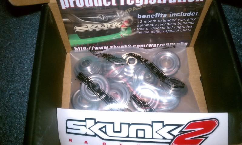

UPDATED Jan 2011
Got these from a friend on a crazy deal!
Stay Tuned

Assembling Engine in my Living room!
Head on Dining room table
Stay Tuned

UPDATED 11 April 2011
I sent the head to the machine shop cause I didnt want to do the work to it. Well after about 7 business days the head was still there cause the skunk2 retainers were making the OEM Keepers sit too low so they installed the OEM retainers but I had 3 of them still at home so I pick it up from them (Great shop by the way Springfield Auto Machine last know as Springfield Crankshaft, Tell Them Edwin sent ya if you use them).
So I picked it up and with the Help of Chrissy my wife, Illyana my oldest Daughter and Kenny one of my Best Friends we got the head together.
Installed the ARP GS-R head studs

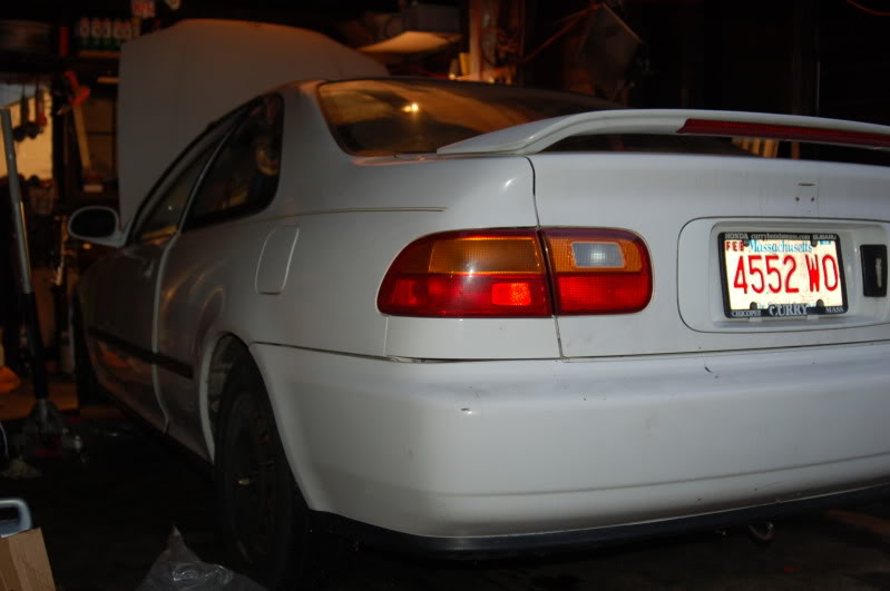

Small Update 29 April 11
EjWone out of Garage for first time in 2011 due to the garage door being replaced Tomorrow. Gonna clean up the garage really well and organize it Hope the Corvette leaves the garage tomorrow and I have it all to myself finally!
