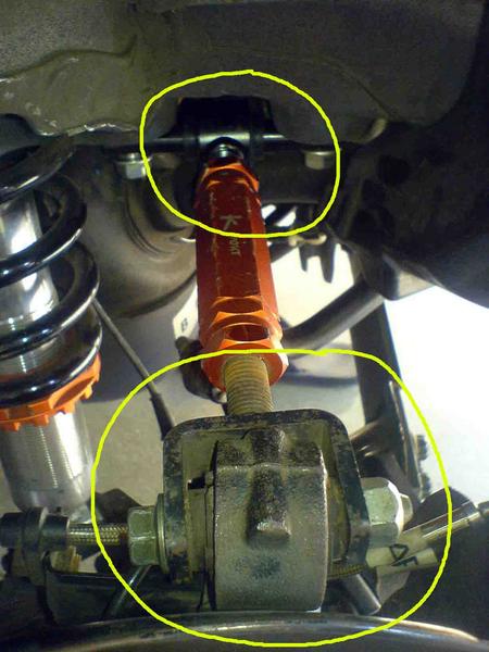

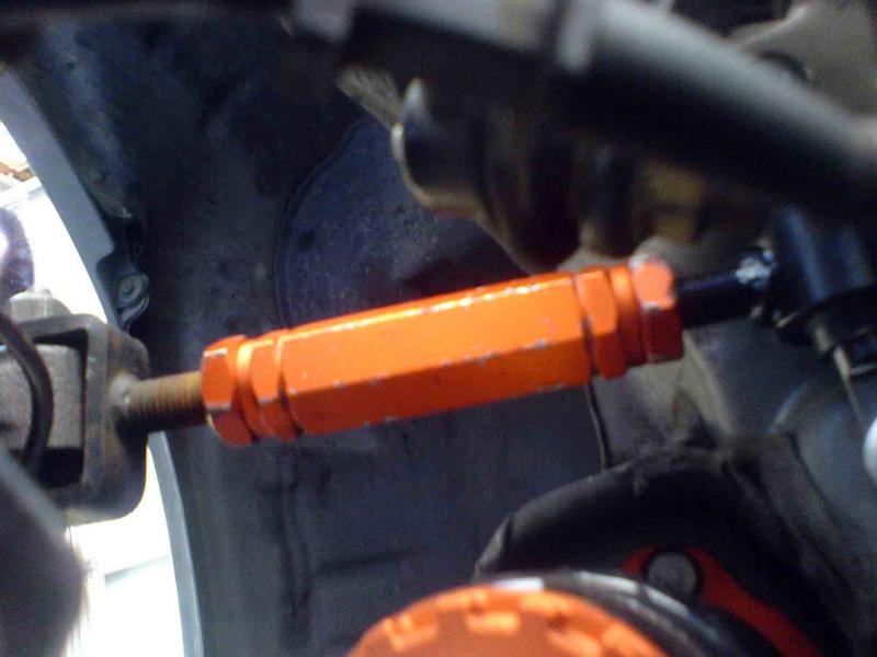

Anywayz, on to the camber arms. The camber kits I currently own are from 2005. Having said that, today I replaced the upper part of the camber kits. The section that holds the inner bushing that mounts to the car. For some odd reason the camber arms do not come straight out to the top of the knuckle. I don't know if this is because my camber kits are an "old revision" where the fitment was not as good as the current sets.
I'd also like to take a moment to say that their new upper inner bushings definitely look better. They are also visible smaller and of better quality.
I'll post pictures tomorrow, and give ksport support a call.

Ok here are the pictures of the camber kit. The first pic is above the camber kit. Notice how the location of the inner bushing(where it mounts to the chassis) is not in line with where the camber kit mounts to the knuckle(top of brake). This causes the camber arms to flex when mounted, notice where the camber kit mounts to the knuckle. It clearly is not sitting right at all. The second pictures if from below the camber kit, you can notice how it is tweak a bit.
