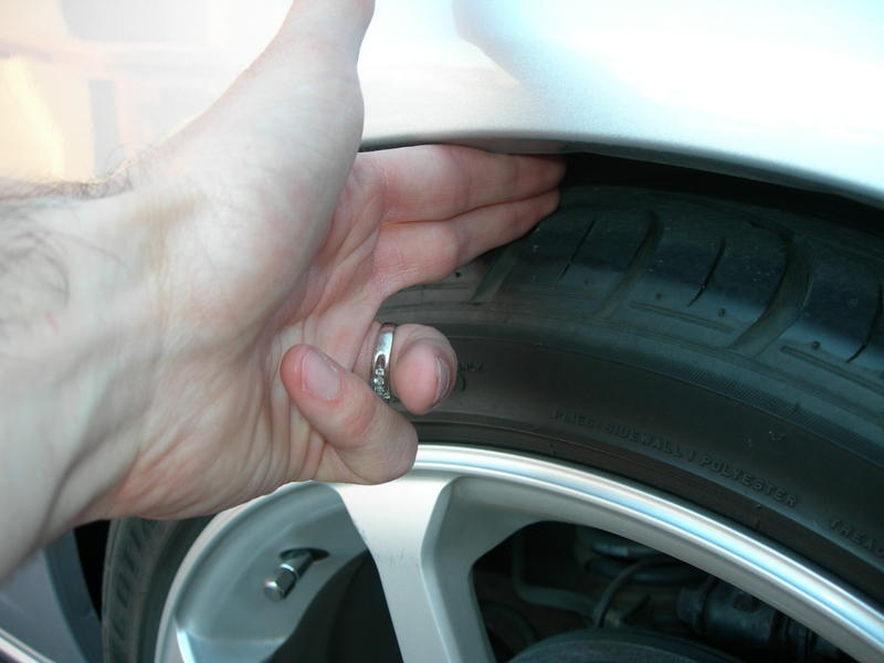

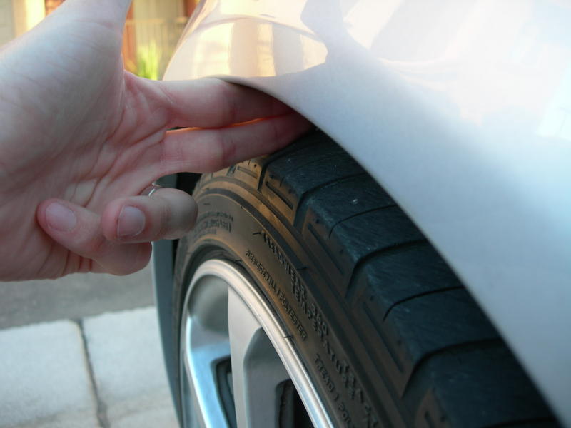

Here they are:
The first is the stance with the Eibach Pro kit and 18' Motegi MR-7's. 2nd pic is is back and the 3rd is the front. This setup never rubbed or hit (without camber).

yeah here's another vote on the ProKit, it's a good drop... it's about 1.3" drop and you can take your time getting all your components (camber kit and shocks) because you WILL need them eventually.
The Prokit is 1" drop and the Sportline's are 1.4"
I have a set of H&R's now and they're 1.3"
And yes, after 1 year of the Prokit my back tires were shot from the neg camber

^I think the 1" is just on paper... it seems like a general consensus when it all settles it's about 1.3"
yeah, my rear tires were shot too I need warm weather to put my SPC kit on!
