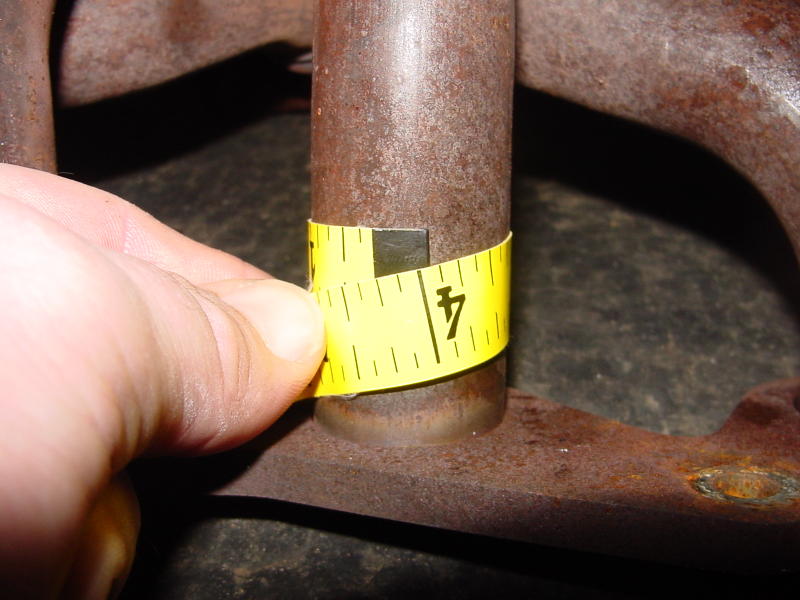

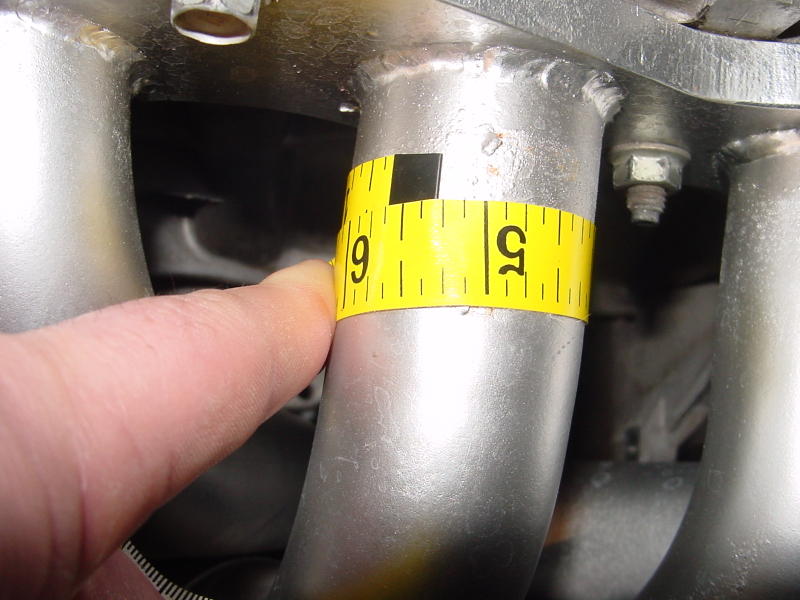

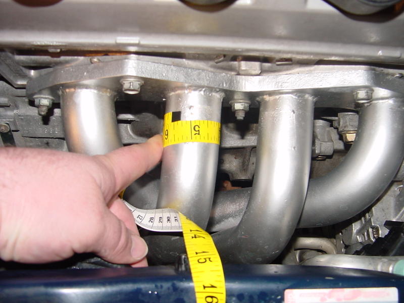

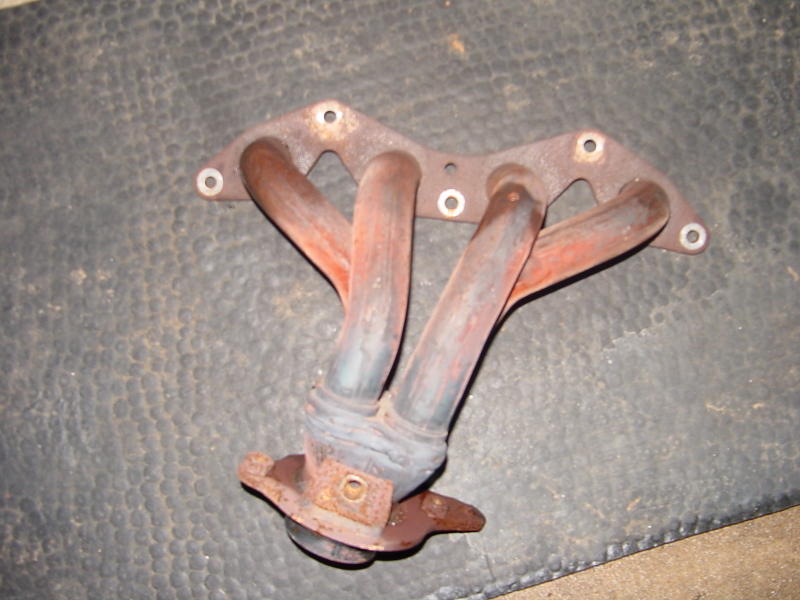

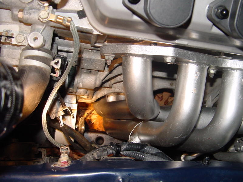

Well here you go finally the moment we have been waiting for. Pics of the OEM and HP headers. Now all we need is the DC guys to admit they bought a piece of crap and take some pics as proof.
I have included pics of the HP H26 this is a full 4-1 header and my old stock exhaust manifold. You will notice the long sweeping runners of the HP. This is an advantage over the Megan you will notice that the Megan looks a lot like the stocker. Yes the Megan may be a ½ in larger in diameter but the runners are a lot shorter . So where the pipes come together will be a restriction and with the Megan this restricion will hapen a lot sooner. The HP has longer pipes so they can hold more spent gasses before the collector. Now in conclusion. Longer runners make more ponies shorter pipes more TQ. This is your call. Both are better than stock. I took the HP badge off of my header whe I painted it. I can take a pic of it if needed for proof.

just to sum up what we have so far.
Stock: 4in.
Megan: 5.5in.
HP: 5.25in.
DC: still waiting on measurements..
