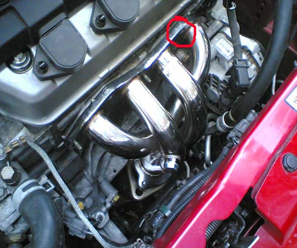

Post Megan Manifold
I have over tighten one of the top two bolts on
my MEGAN minifold and its now proper loose...
does any one... well there must be some one
knows or have any idea how to resolve this
problem......?
I wanted to use the same bolt if posible.....

I used a hard metal drill bit and an easy out. It is a tool the is used for pulling stuck screws and bolts. I bought both at sears for 9 dollers. the longers part was taking everything out of the way. removal of the stud took 5 min. room is limited so if you have a dremmel I would use that. I used an air drill cause its small size. Did not have to pull the head though
