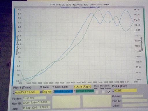

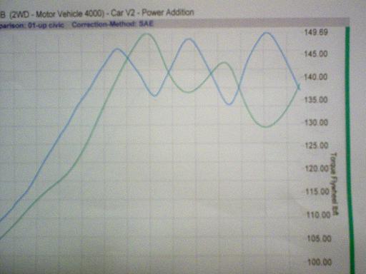

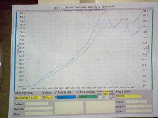

sup guys, i got out to a dyno today and made some pulls. i had some problems with the way the shop was making the pulls, and the car had a hard time spooling to anything more then 8.5 psi. also, i had some nasty surges with the boost in the upper RPMs as you can see in the pics. also i found out after the runs that a bolt came off my exhaust and i had a sick leak at the downpipe, so it wasent a very good day at the dyno, never the less, i pulled out 177 whp and 149 ft lbs of tourque at 8.5 psi

nice numbers but damn... that graph is all over the place. You need to do more pulls now that you fixed the problem.

hehe umm you should probley mess with the set gain on the boost controller. WHat is the max boost that you have the greddy profect set to? If the set gain is set to close to the max boost pressure you will get boost spikes in the higher rpms. I had the same problem.

i never touched the gain on the controller, i had no problems with spikes before when i was driving on the road. this was the first time ive seen this! the gain is at 0
