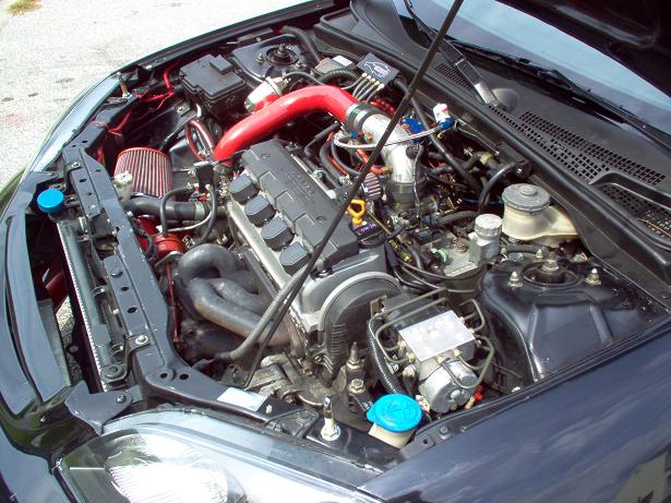

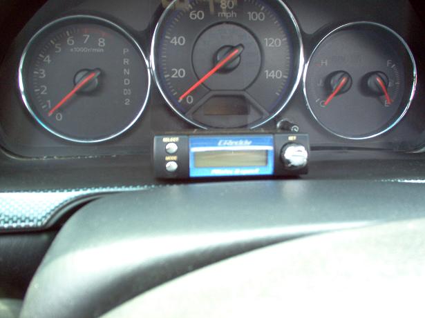

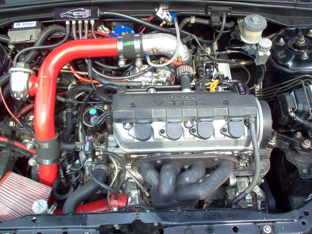

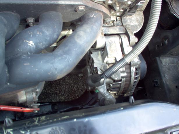

hey guys, finished the motor in my car this weekend, while i was in there i did the following:
removed AC and P/S pumps and all lines
installed Greddy Profec B boost controller
installed KMS intake manifold

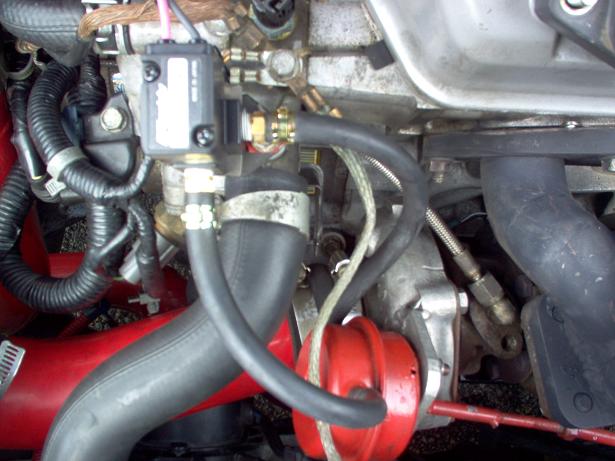

DIY throttle body heater hose bypass
lets see if i can answer all the questions before they are posted
1. no, the steering is not hard at all, if you do it right, like in the DIY that was posted on here about a week ago, the steering feels like a regular manual rack
2. yes, the intake manifold made a world of difference in the way that the car runs, its 100% better feel then the old plastic one. the boost is more precise and even. and it kicks in faster as well.
3. no i dont give a **** about the Air conditioner, i never used it anyway
4. the greddy profec B controller was 310$, and its **** in awesome
5. and the motor took a hour to get out, and a hour to put in.

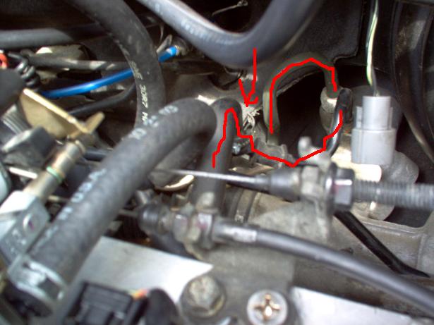

this is where i looped the power steering lines

i'm really interested in removing the power steering, how hard was it? pm me! hehe

Congrats on dumping the PS! I'd like to see what you did different than me with looping the lines.

Originally Posted by jttegx
auto turbo...nice
its not a auto, its a manual. that is a cluster swap from a sedan, i wanted to blue LEDs insted of the coupe's red and white. good observation tho
i followed what you had written in your DIY, insted i didnt use a resovoir, what i did was use the stock lines out of the rack ( i didnt feel like spending 50 bucks on fittings). so i cut the hard line from the front fitting, and cut the rubber line from the rear fitting, and sliped the rubber over the hard and hose clamped it. basically its breathing in that loop insted of the clutch fluid resovior. your right tho, its aint hard at all to steer, thanks for the idea.

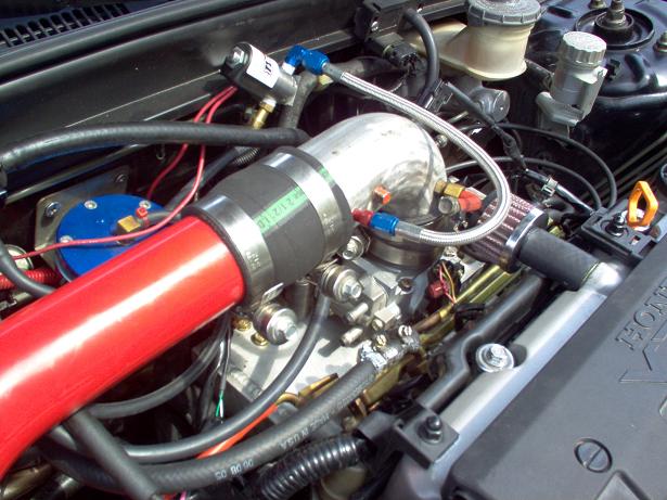

what is that braided hose going into your intake. you arent running nitrous and boost, are you?

the throttle body heater bypass might cause idle problems later. and it was shown to only decrease air intake temp by 1-2 degrees on an NA car.
Great idea! Enjoy the tighter feel, I know I do!

Originally Posted by MiamiUgen7
what is that braided hose going into your intake. you arent running nitrous and boost are you?
thats what i was going to ask
Old Aug 24, 2005
bOoStEd042dr's Avatar
Posts: 1,322
From: michigan
Rep Power: 273
bOoStEd042dr will become famous soon enoughbOoStEd042dr will become famous soon enough
looks like a nitrous line to me

wouldnt nitrous and boost blow up your engine?
that line is a fuel solonoid, i have some problems with running out of fuel sometimes. i can spray fuel into the intake if need be...
