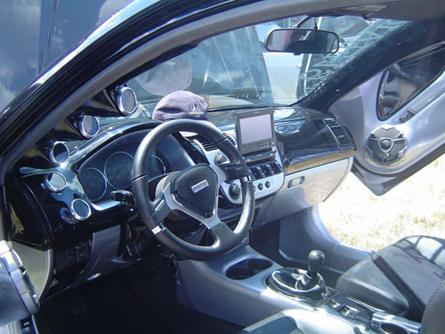

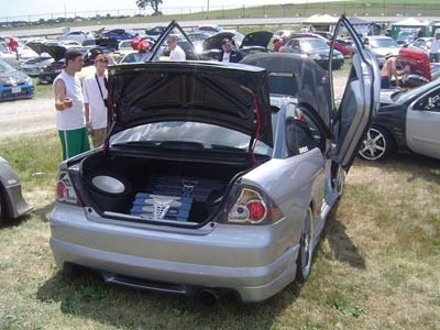

New interior pics!
here they are from a show this past weekend

Do you have any close up pics of the trunk? I will be starting on my trunk here within the next month, mine will be all fiberglassed and painted Rallye Red to house either a S12L7 or S15L7 with either a KX600.1 or KX1200.1 and the KX350.4 thats running my Kicker Components in the front and Kicker Coax's in the rear.

That dashboard and stearing wheel look offical.
I LIKE IT..

did u fiberglass ur dash or is that a cover?

I would like to know the same thing, I like how shiny it is and how the gauges are, very nice interior you have there.

That is not a dash cover... We completely stripped the interior of his car and all the panels and pieces were primer filled and painted.

The dash board was completely stripped, and filled with bondo that has a fiberglass base....then its layers of primer fill with sanding between each layer.
The doors are stretched cloth with fiberglass, bondo, and primer fill as well.
I shaved the power window switch and moved it into the middle.
I also have the Kicker amp control kit (same size as 1 DIN, so I moulded it into the pocket under the cig lighter (01-02 civics only)
The guages were moulded in where the air vent was (I don't use that one anyway)

Did you peel the padding off the dash before you did it? I'm in the process and just glassed over the pad but peeled the vinyl. Let me know. That seems like a lot of bondo

I took off both the pad and the vinyl

did you have to use a thicker layer of bondo to even it out or did you just use it like the rest? is it just plastic underneath?

Yeah that pad isn't THAT thick but it seems like a lot of bondo
