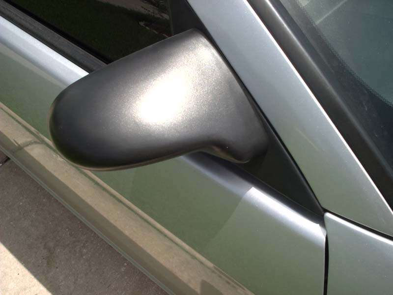

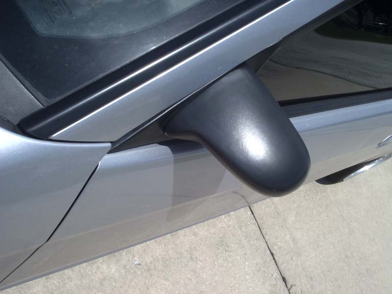

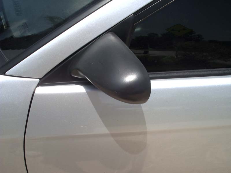

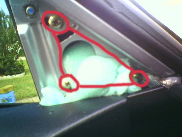

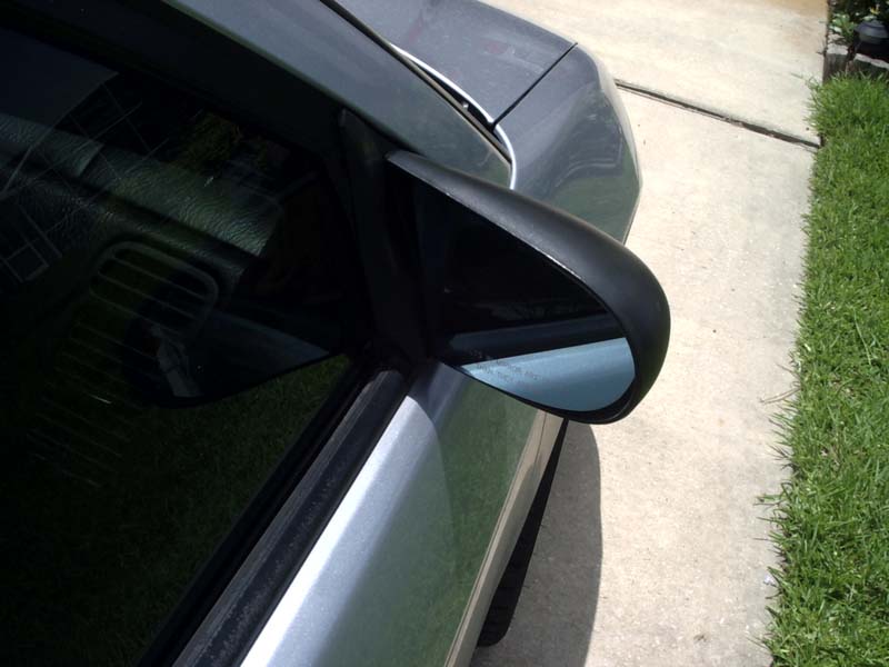

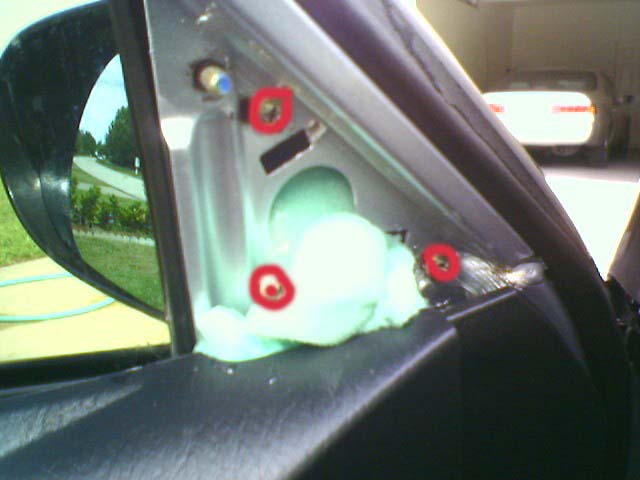

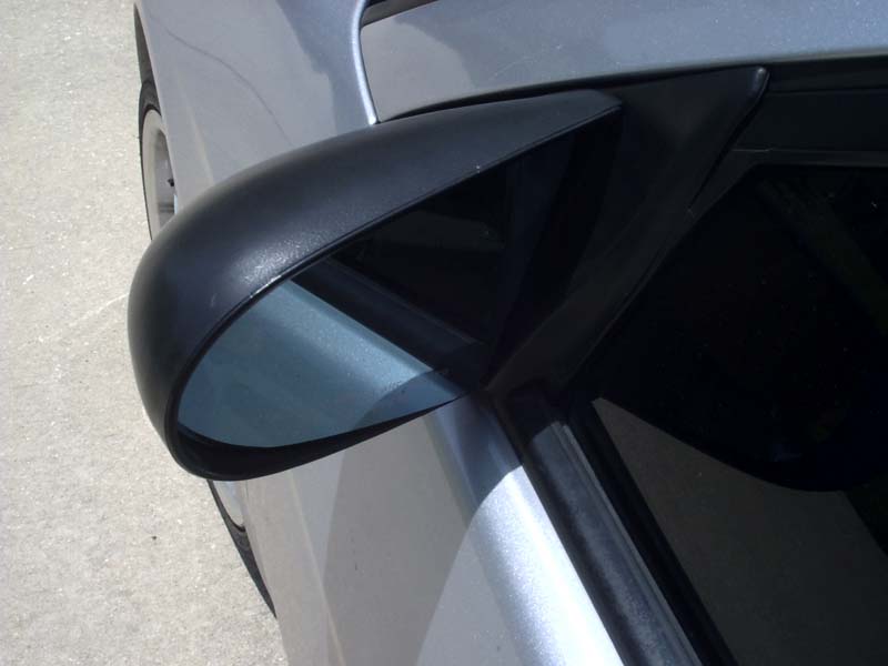

For those of you who want spoon mirrors for your 7thgen, you are going to have to custom fit another car's mirrors onto your car. you will have to drill new holes in order to hold the mirrors. These r the current pics I have and I will take more of the inside later today to show those where i put my holes. Nothing more than lining up the mirror, marking the holes and drilling them. 1 hr tops. enjoy....
** on another note, since some of you guys want folding/pwr folding mirrors try the integra folding mirrors. The integra spoon mirrors line up perfectly imho, but maybe the factory ones will work too...
** since the mirrors will never fit like factory, road noise will be a problem. My solution was to place foam in the holes between the mirror and the frame. I will have pics of that as well.

Which Integra years? Do they angle downward? Or are they level?
Thanks!!
Old Jul 5, 2005
HondaKorn's Avatar
Life is better with 5lug
iTrader: (18)
Posts: 2,357
From: Phobos/Orlando
94-01 and they look level to me...

try 92-95 civic hatch spoon cf mirrors...my friend did it on his car the same way by drilling holes and such

he got them from robear racing...he did some custom mounting im not too sure if it was a perfect fit but it looked pretty good...try the integra ones...like hondakorn said cuz i think those fit better...try robear for real cf ones...otherwise i dont know...heh
