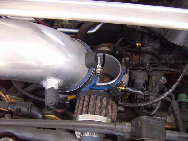

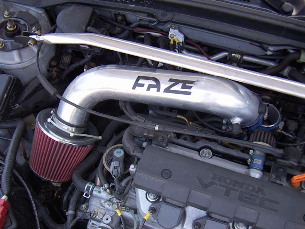

look what i saw.
good thing i caught this before anything got sucked in.

thas not supposed to be like that.. lol
quick fix tho..

^yeah. i put my stock intake back in for now. im going to try and get a V2.

Honestly what I would do is go to a hardware store and pick up a rubber coupling (it's black and it's used for drain piping)...I'm pretty sure they're only like $5 or $6 so it's a pretty cheap fix. I really don't think it's worth the time or money to get a new one.
BTW is that electrical tape covering up the hole that the PCV hose is supposed to plug into? There's a cleaner looking, better fix to that too....auto parts stores will have what are marked as vacuum caps that you can use to cover that up nicely and make sure it's not sucking in stuff.

yeah, i like the sound so im gonna keep the intake. would home depot have rubber couplings? and yes it was electical tape, i never really got around to putting a cap on it, but im going to do that when i get the coupling. thanks a lot.

Yup, Home depot would definately have them. I'm not sure what size you want to get though (they are made for different materials and I think they go on the inside diameter) so you should probably take a piece with you to match it up.

if u do fix it make sure the intake is no hittin the strut bar, it looks like that intake was rubbin the strut bar then jus cuzed undo stress on the rubber coupling then ripped.
U can see the rubbing marks by the "E" on top of the intake, remember the engine rocks back and forth from torque as u gas it.
I had a struct bar like that with my intake I end up replacein it with the neuspeed bar cuz it was hittin my intake and I didnt want it to hit a hole in my intake. U have to test the engine movement by pushin on the throttle cable to make sure nothing is hittin or rubbin after u install stuff

yeah it was rubbing, so i zip tied the end of the intake to make it lower and not hit. i was gonna find a better solution to the problem, but i never got around to it. what type of intake does everyone have?
