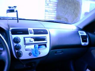

i was bored today so i decided to paint my dash.
looks good? sorry about the picture quality, but i only had my PDA to take pics.
door handles will be painted next week.

sweet dood, what kinda paint you use?

krylon white primer, krylon silver paint, and krylon clear acrylic for the clear coat.

did you remove the whole dash and ac vent pieces or did you just mask off the surrounding areas?

yeah, i removed EVERYTHING. the only thing i masked off was the pocket of the dash. i didn't wanna try and paint the inside of it and get the paint running.

looks nice. How long did it take

like 2 1/2 hours including taking everything apart and putting it back together.

wow...i let mine dry over night. in the pics ur dash looks white.
can you take closer shots of em...i wanna see what the clear coat looks like.

is it smooth like glass or would you recommend either buying or renting a spray gun?

Vinyl dye works good too, i sprayed mine and it really smooth and never peel or cracked.

i'll try and get some better pictures tomorow with the light hitting it. i think the only reason it look white is because its a light silver and my pda doesn't take the best pics in the world, but if you were to see it in person you wouldn't mistake it for being white.
the only reason i used the clear coat is to add a little protection from minor scratches. you can see it shine a little when the light hits it, but i really just wanted it to help protect the paint.

didn't wanna do because i think it makes everything look uneven. just a personal prefrence i guess...

i did it because 1. it was cheaper and 2. you don't have those huge black gaps between areas.

how did you take them off?

for the vents...they just pop off by using a screw driver...but use a clothe to put around the head. then...just unscrew the pieces of the vent.
for the console...take out the little sqare's next to your cigarette lighter plug and then look in side...you should see two bolts. unsrew those and a little bit of pushing here and a little bit up tugging there...you've got it out. then just unplug and unscrew everything.
