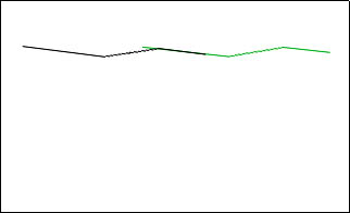

Originally Posted by vietstyLez
can u explain the "compensatiing for rotation" thing? sounds interesting..
that image is not of my projectors, but it displays what i meant by rotation. if you have the projectors aimed properly, it should look like this:
if you have some rotation off, it might look more like this:
over on the right side of the green pattern/step there might be children running around on the side of the road and may even run ON to the road. to compensate for rotation, (obviously it's not THAT dramatic on my car as depicted above) i aimed the projectors a little higher than normal, and the passenger side is aimed even higher (maybe 1" higher at 25 ft)

can't believe how good yourcutoff lines are

my cutoff isn't as good as the cutoff on the pic i just posted....
