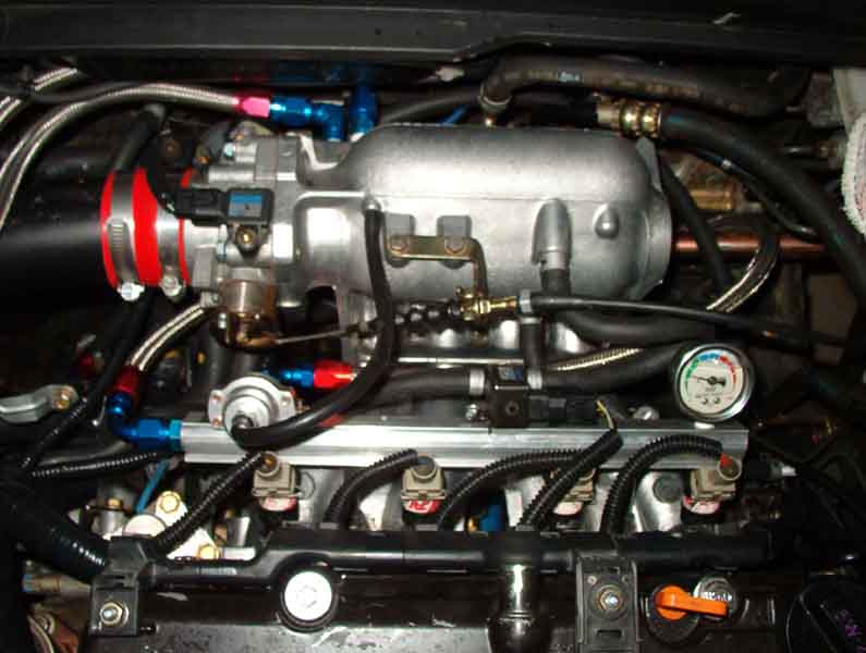

Yesterday my friends and I finished my car (Thanks to Brad and Morgan of Domestic Violence motorsports) To start, we got rid of the D17 manifold and put on a Honed port matched d16y8 manifold/TB, with a return fuel line, new fuel rail, adjustable fuel pressure regulator, fuel pressure gauge, Accel 255 fuel pump, and RC 550cc peak and hold injectors, injector resistor box. This was not an easy bolt on, Morgan had to make a remote idle air control valve/sensor, and brad needed to do a lot of new wiring. The new manifold pulls a lot harder in the higher RPM range (like 4000-7000) then the d17. Due to its shorter runners. Brad and Morgan say now we know what to do they would be willing to sell some on special request.

The d16y8 manifold stays fairly cold, I drove it around on a 65-degree day for an hour the y8 manifold wasn’t hot at all. Also people often believe that the d17 manifold is lighter. The d17 is 13.2 Lbs (with TB, Fuel rail, injectors) the y8 is only 11.7Lbs (with TB, fuel rail, and injectors)

very nice man... howz the difference.. get dynoed with the new mani... i want to see some numbers

**** - how much modification was required to the intake manifold flange?! wow....

Not much modification needed. This was more of a turbo mod because i really needed the return line and the big injectors. But i could see N/A people getting some gains from this.

Cool - there has been a lot of talk that things wouldn't fit because of different bolt patterns, etc. If its virtually a direct bolt up, man there may be a lot of folks making some real power now.....wow! Would love to see more pictures or info!

Well some of the modification is tricky. We had to make a remote idle air sensor because the D16Y8 and the D17 have different setups; also there was a good deal of change to the wiring. The map sensor had some stuff done to it also. Click on "see my ride" to see a video of when we first tested it.

I'll check it out - as far as the skunk2 or edlebrock manifold fitting - I don't think it will, only due to space limitations. here is a side by side of each:
http://www.tiora.net/~civicryda2k/in...nk2vsjg_01.jpg
It appears that the skunk2 and edlebrock are longer due to their runners. It also seems that the stock D16 manifold just barely fits!! Wow....

Yeah its a tight fit, but it works.
