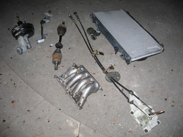

so i got some stuff for my vic...
a 02 radiator, 1 si axle lol... gatta find another one, a 6 speed shifter,, rsx S intake mani, rsx S brake booster, and clutch master cylinder

lol 1 axle. does the brake booster bolt up? or new holes/position?
been wondering about this myself
Old Oct 15, 2004
HondaLuver's Avatar
Its a celebration bitches!
Posts: 10,216
From: LA, CALi
Rep Power: 404
it bolts up to stock location, its more powerful than a civic booster

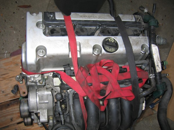

K24a1-Honda CRV comes in with 9.6:1 compression and 2.4 liters of displacement. The motor is rated at 160hp at 6000rpm and 162 at 3600 rpm. This motor does not use the conventional VTEC mechanism from the earlier B series motors but does have VTC. Instead it only has 2 cam lobes on the intake side and 1 on the exhaust lob. This motor has no VTEC mechanism on the exhaust cam and runs on 12 valves before 2200rpm with the other 4 slightly opening. It also has smaller ports than the Type S and Type R. The motor also comes with a 5 speed transmission instead of the 6 speed and has no LSD.
now we arn't going to worry about the crappy Vtec head(a2 cough cough) or the 5 speed tranny(6 cough)

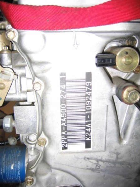

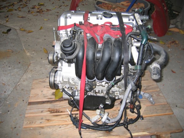

pics of the engine
Name:	front of engine.jpg
ID:	40995   Click image for larger version
ID:	40996   Click image for larger version
