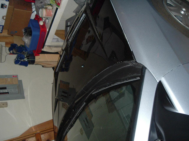

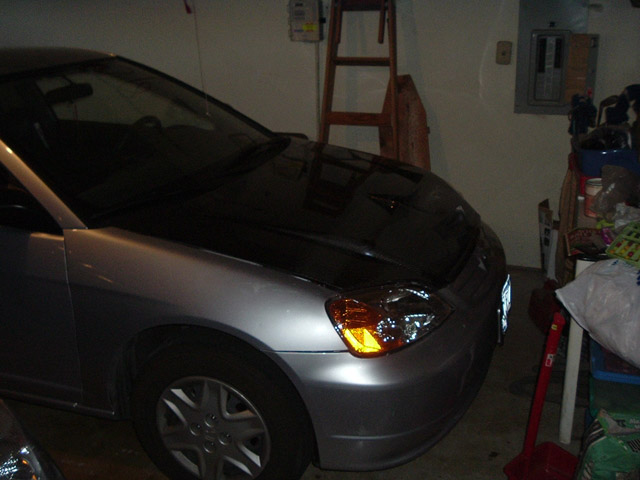

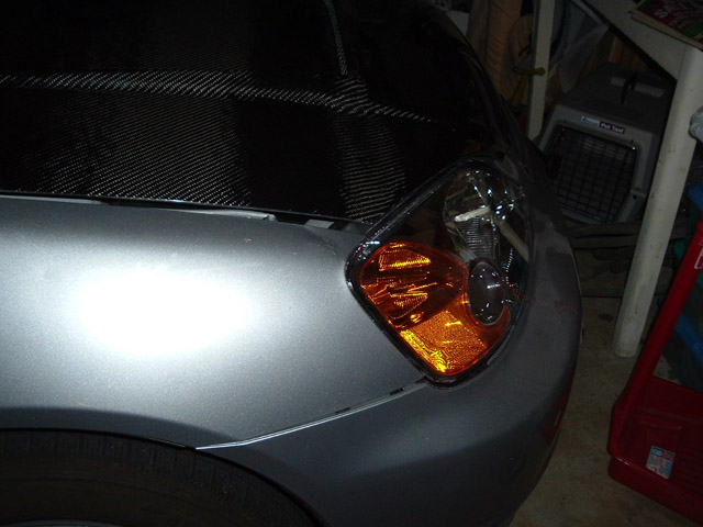

Now keep in mind there is some framework that needs to be done, and it'll get done in a short while.. so some of the front stuff will go away.. just look at the sides..
(no pics of before I got it fixed, but if you did see them, you'd be amazed)

have you lowered the bump stops so the hood sits lower?

well the bump stops you can do yourself, open your hood and find the little rubber things around the engine bay where the hood sits, i know most cars have them, though, i'm not in front of mine right now. You should be able to lower or raise them by turning them clockwise or counter-clockwise.

hmmm... you may have to take off the latch and relocate it a few inches lower?

It's not supposed to do that...you either have to adjust the latch, the bump stops, or the hinges. Or buy a better quality hood.
