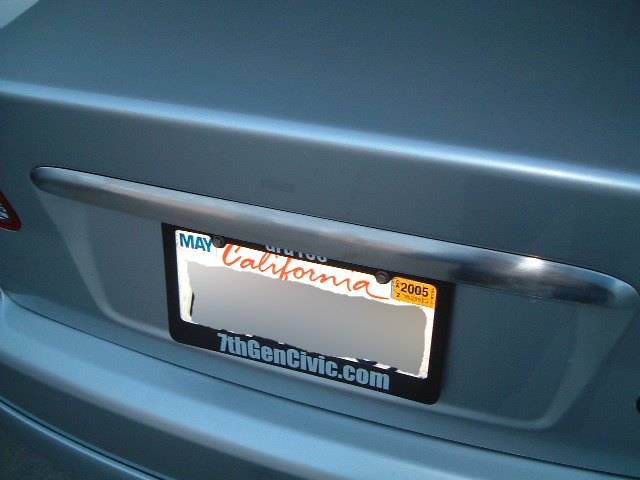

I sanded my chrome trim piece today. Im gonna have it painted at my work cuz my boss does body work. I was suprised how it looked after i wet sanded wit 400 grit sand paper. Should i paint or leave it like this? Kinda looks like stainless steel lol

i kinda like that... the brushed look

i like it and it looks good, but i still say get it painted.
btw, wouldnt it have been cheaper and alot easier to just buy a SSM one from honda? you can always have mine this summer if you want it when i shave my trunk

that looks nice dru...keep it.

Just get it painted. It will look much cleaner

Gotta quick question........When u got urs painted did they sand all the chrome part off till u saw the white plastic? Cuz right now its still really smooth and slick. Im afraid the paint wont stick. Oh hey that rhimes!! Haha

You need to sand all the chrome off for the paint to stick.

hmm, I didnt sand it down that much I sanded down till the gold part came out and primed about 4~5 times b4 painting
