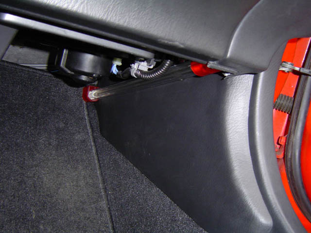

First pic.
this is where i installed the neon tube on the passenger side. I wedged it along the side so it's actually holding itself in. the panel above where the neon light is, is also where the convertible speed sensor wire is. I removed that so I can put the top up/down while moving. hehe

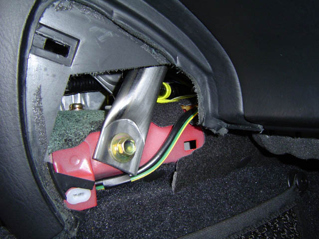

Next I ran the neon light wires through this right side radio panel with a coat hanger.

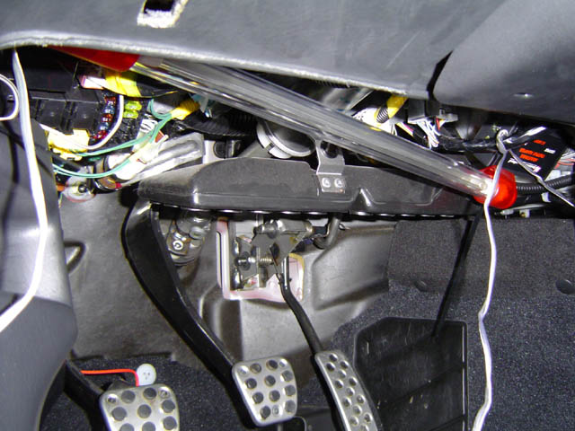

Here is the driver side neon. You an also see the wire coming from the right for the passenger neon. The driver side is held with zip ties to various wires/harnesses/framework under the steering column. Though it looks like I could hit it with my knee, that's just the camera angle. It's up there, believe me.

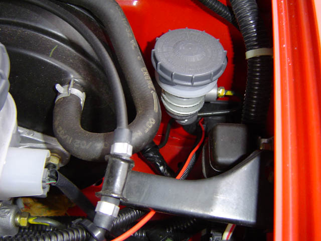

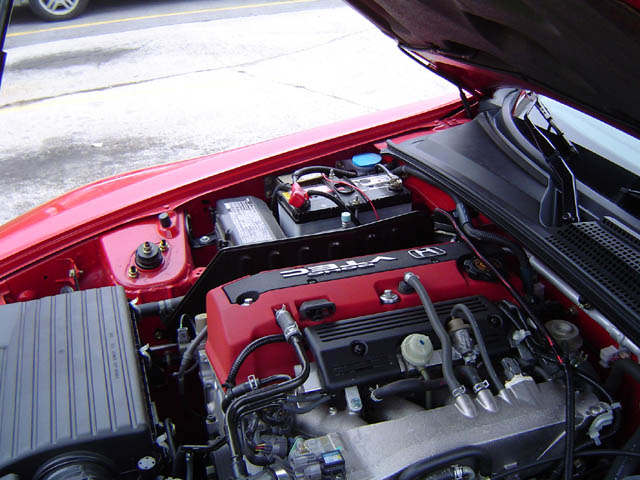

Here's the power wire going across the top from the engine bay. can't see much. but hey... the engine is cool.

I put the fuse connector wire right to the battery, then ran the wire to the driver side and through an existing hole in the firewall. If you use a hanger or have small hands, you can force the wire through since some wires already go through this spot on the firewall. I actually found it easier to do from the inside out.

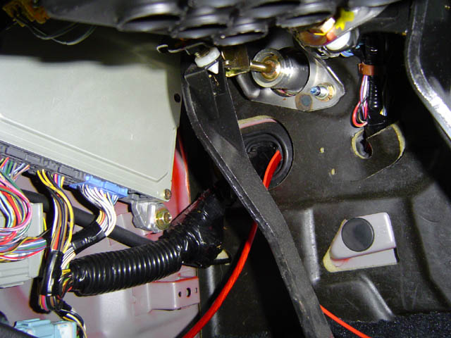

Here's the other side of the firewall where the wire comes in, right by the clutch pedal.

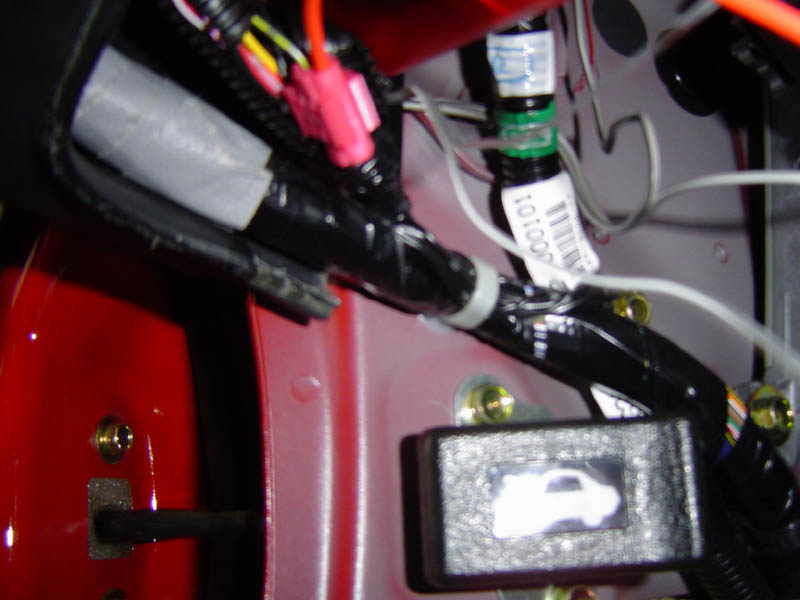

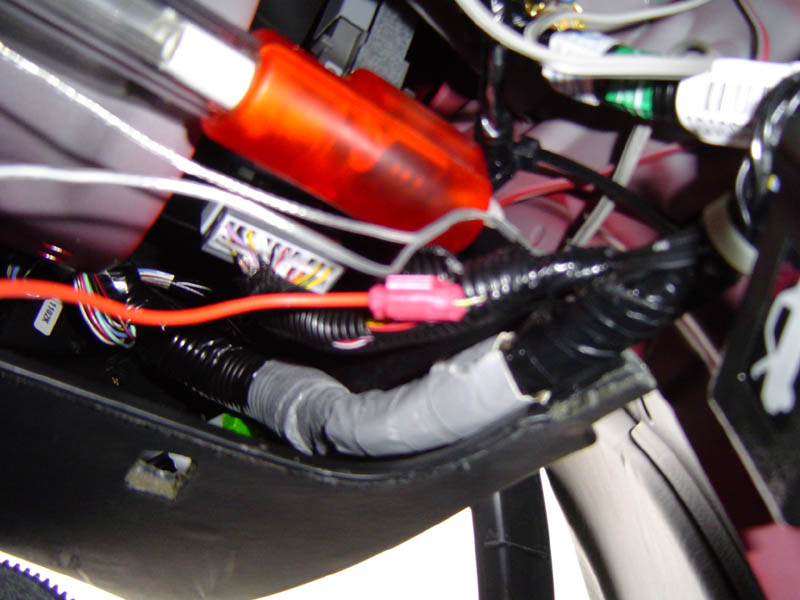

Now here's where the wire is for the keyless entry module that you want to use. this turns on the neons when the door opens or the dome light goes on when you unlock the car with the remote. The keyless entry module wires are just up and toward the door from the hood release. You can see my vampire tap on the top left (the maroon/red lookin thing)

Here's a better picture. This is from the floor kinda looking up under the steering column by the start button. You can see the harness in the middle actually plugging into the keyless entry module right about the center of the picture. Again you see my vampire tap. And you can see where this is in relation to the hood release. Use a flashlight if you're not sure, and the keyless entry module has a blue sticker on it, stating something to the effect of being the keyless entry module.

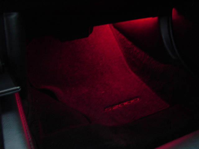

And the final result. It's still a bit light out, so it doesn't show up quite as good.
