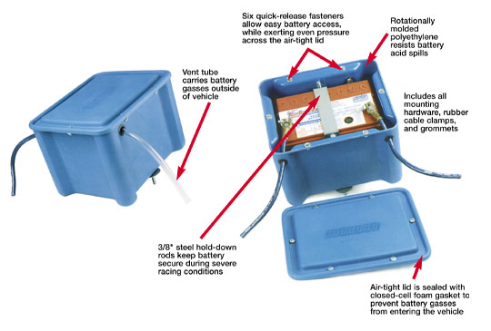

Is this what your battery relocation kit looks like?
You are correct man!
