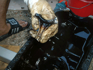

Originally posted by OsOBooSTeD
yo ur ****ing crazy or the person who told u was. theres no way ur stock rods are going to hold up.. lemmie SHOW u what i mean. heres my old engine. No Turbo, just I/H/E
GOOD LUCK WITH UR INTERNALS!
I feel your pain, i was lucky though all 4 bent I don't think i'd trust stock d17 rods over 10 for very long.
This didn't happen under boost, just shows a d17 rod gone wrong.
what YOU did will happen to any engine... notice the fact that theres no OIL in there.. hmm.. u hydro locked it dude... that has nothing to do with what rods or internals u have.
My engine had plenty of oil and no water inside and still snapped the rod like a pretzel.
yea i know it wasn't caused cuase of the interals, i was just showing a torn up d17 rod is all man, don't gotta get a deffensive. And there was OIL in there before i drained it out, i mean unless you can figure out a way to drop a OIL pan without draining the OIL
But at any rate, i wouldn't trust a d17, or any non turbo, turbo'd motor at over 10 psi without some block work done, its just not safe.
