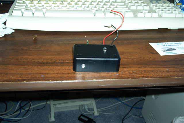

just got done putting it together.. im gonna wait a few days to see if my CEL shuts off before i put it in..

i had some help.. but yea.. its a DIY.. but again.. im gonna wait a few days to see if my CEL shuts off first then i will install it and see if it works.. basically all that is involved with the install is detaching the correct o2 sensor wire from the ecu.. and putting this one in so altho this one was designed for obd2 and for a supra.. i really hope this works for the ULEV ecu's if not.. ill sell it to my friend.. cause he wants one

im gonna install it probablly tonight or tomorrow night.. im sick of having that CEL on and starin me down... i just gotta figure out where i need to splice it into.. and yes, this unit does require me to disconnect my O2 Sensor wire

it isnt guarraunteed to work.. its originally designed to work for a supra.. cause i found the design off of www.mkiv.com so i know its supposed to work for obd2, but im not sure its gonna give out the proper readings

yay it works.. but i will let you know at the end of the week if my CEL turns on again.. hopefully it wont anymore

ok day one of testing.. so far the CEL is off, but that could be cause i unplugged the power from the ecu and it is trying to reset... i couldnt really push my car this morning because of the traffic, but its about 20-30 miles to school, and so far so good no signs of it turning on

well its installed in my car, and NO CHECK ENGINE LIGHT!!!!! so im gonna start to nail down a design and start pumping them out..
