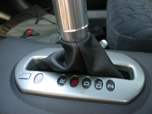

I have an auto and wanted a boot to make it look nicer with my new shift **** (razo ra89). So i installed the manual boot thingy and stuff and made it look like the wannabe manual. Well after about a DAY, i thought it looked dumb (i never liked it after I installed it) so I started thinking. So what I ended up doing was taking my auto thing (with the P R N etc.) and taking out the middle slider. I cut the 2 bars on each side and dremeled it down. I then cut the boot off the manual. I then put the manual boot inside the auto thing and zip tied it down (and made 2 extra holes to zip tie it into).

I took apart the center console and removed the thing that says "P R N D D3 2". I then removed the peice of plastic that slides when you move gears. I then dremeled the 2 bars that basically held that in (but they seemed useless). From there, I took the boot off the manual thing and removed it. I then cut the boot (which I probably shouldnt have done, lol) to make it shorter. I then took the boot and put it in the middle of the "P R N D D3 2" thing where the sliding piece of plastic used to be. I attached it by using zip ties, there were 2 holes to attach it to in the back but I had to drill 2 new holes to zip tie the front (I just made slits in the boot to put the zip ties through).
Hope that clears things up, just think of BMW or whatever cause thats what I got the idea. I should have pics in a few days.

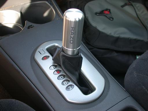

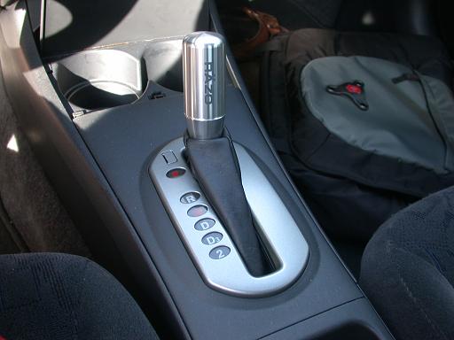

PICS!!! PICS!!! PICS!!!!
Civicvtecps1- look in the im scrubbing post i had, i just put up pics of my new tires and pics of the car.
heres my shift boot mod- THE PICS DOESNT DO IT JUSTICE! trust me, it looks better in person.
