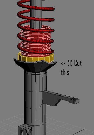

btw, I raised my car 2 thread on the front, I am still tuckin 17"s but i no longer rub or hit the road ! plus the shop I took it to taught me how to change springs and shocks all !
note: For those with sleves, have them cut the strut spring perch that way you can adjust your front easily. (I had that done today, now I can lower and raise the front as I please)

hey can someone PM me or IM me ( screen name : jdmwhiteteg )
about info on cutting the perch or whatever. im confused.

what do you mean spring perch are you talking about the dust cover, bumpstop, or what and for what springs, coilovers?

RE: ground controls @ front mod for stock strut
this what you need to cut (Stock spring perch) when you install sleves so you can reach and adjust them.

i never did, but i only adjusted my sleeves once, lol then i got the teins
