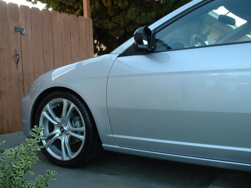

SDE is an unknown quantity at this point
Originally posted by DXPOWER
Does anyone have neuspeed race springs on their car? If so can you post pics?
Neuspeed Race (Front)

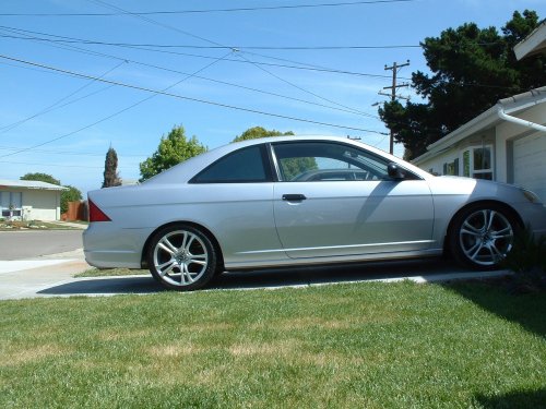

Old Apr 11, 2003
SDE's Avatar
SDE
Posts: 158
Neuspeed Race (Entire Vehicle). Sorry about the size but originally it was way too big of a file size to post
