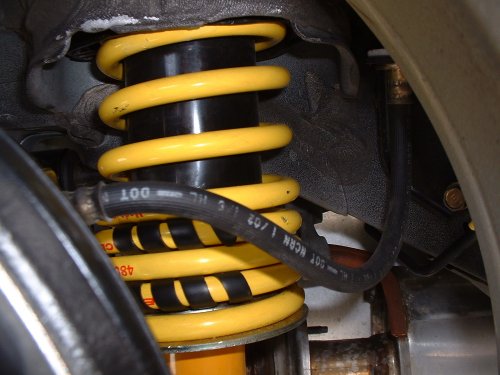

Originally posted by PunkingCivic
I agree that the issue with the level of noise has to deal with the dead coils touching. I'm on a few days with them on my ride and they only seem to make noise when I'm driving in the car for the first time of the day. I would also agree with using isolators. I was thinking of that and came across this thread. You could also go to a local hardware store and get a rubber non-skid adhesive striping and apply them between the dead coils.
And also, had neuspeed sports on my 89 CRX SI for 5 years. The best damn handling i have ever had. NO SAGGING. They stayed a firm as the day I bought them and also worked even better when i put them on some tokicos. Cornered on a dime.
Um there is a simple solution for this. It came supplied with my Neuspeed Race Springs instructions. It tells you to use Spiral Cable Wrap which you can get at radio shack. What you do is cut out 3" strips of it and install one strip on alternative inactive (dead) coils. Check the picture below if you don't understand. They are the black things wrapped around the springs.

Old Apr 8, 2003
NytRyder2k2's Avatar
Bay Area
Posts: 5,585
From: Yay Area 408
Neuspeed springs have served me well. ive had the sports for over a year now and no problems. im going with the race springs soon.
SDE thanks for the 411, looks like a good idea

VNlilMAN's Avatar
The Standard One
Posts: 11,659
Rep Power: 418
hm.. never thought about wrapping it around like that.. thanks
