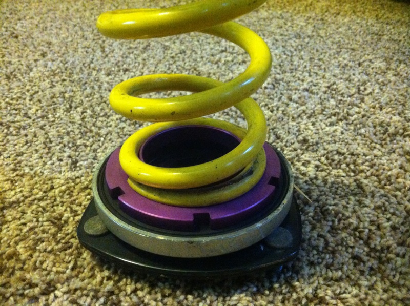

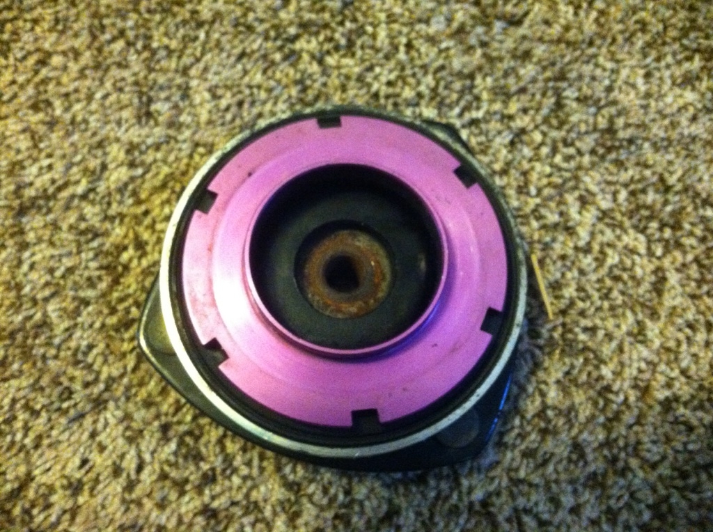

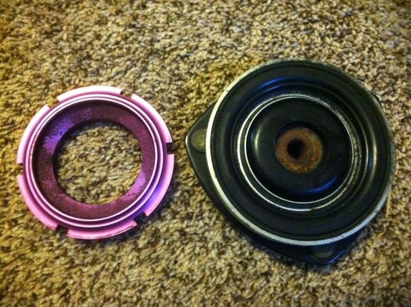

I think your issue is the mount bearing not spinning freely. If your strut mount is working properly it shouldn't need a thrust washer to help it spin freely. I took some pics of mine to see if yours is similar.
Top OEM mount with bearing installed and purple spring thing:
Purple spring thing installed onto mount. If I push on the purple part and twist it will spin freely:
Spring mounted. The bottom of the spring is flat, I guess to allow it to spin freely if it needs to:
