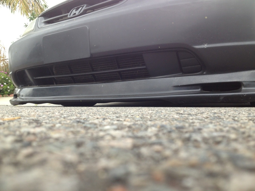

do you have a picture of your car slammed of 3.5 inch ?

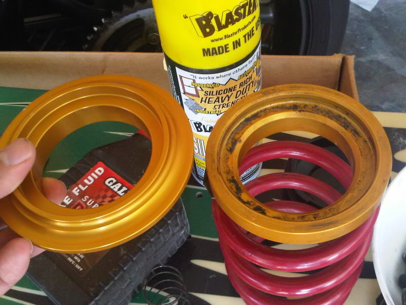

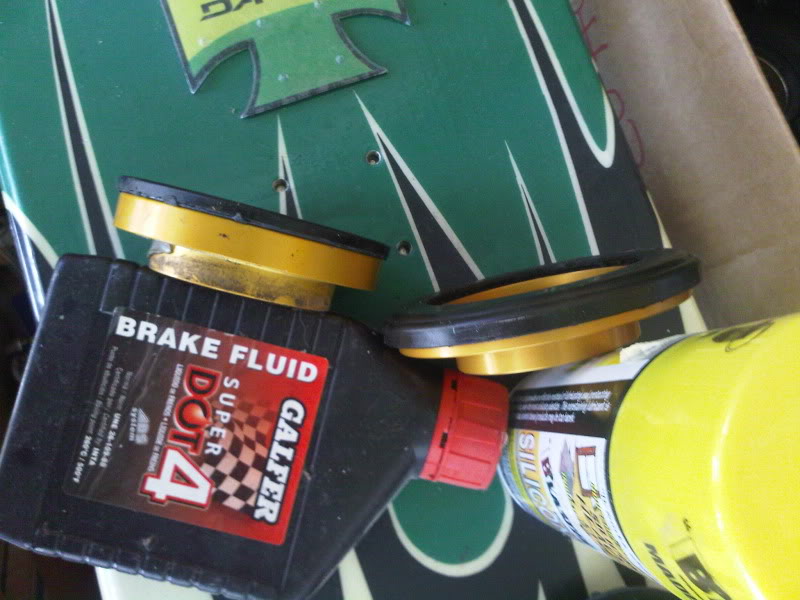

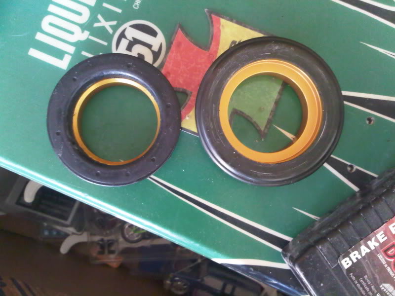

yes, i used stock top hats. i have an 01 so i had plastic bearings. they dont last long in general no matter what struts/springs you have. i upgraded to the 03+ top hats/bearings. they are bigger and better made.
stock 01 plastic bearings:
difference between 01-02 bearings and 03-05 (right) bearings
difference between the stop section of the groundcontrol (01/02 and 03-05). this mounts onto the bearings thats mounted onto the stock top hat

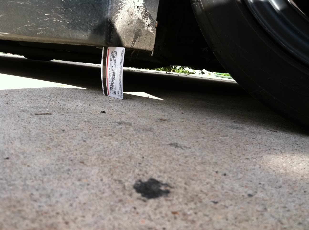

and 2.5" ? haha...im more along the lines of 3.5" (which is the minimal clearance i can get away with getting out of my drive way. id go lower but id rip my front off. and by no means do i have a steep driveway.
