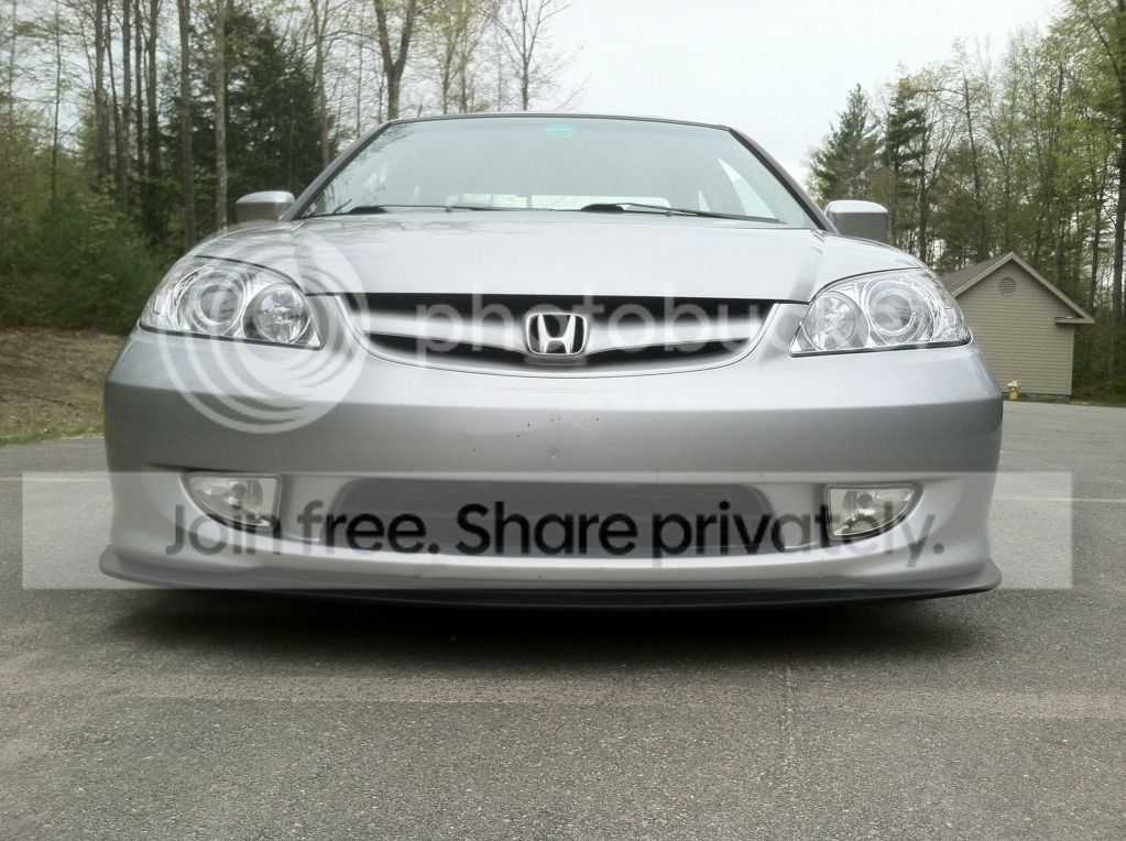

ok so I have a total of 3.25" drop in the front and may need some extra toe adjustment. I know that you can buy inverted tie rod ends really the only ones that I found are T1R and are $220
My question is that I have aftermarket rod ends.... can I just turn them upside down? Would that increase the stress on them and cause failure? Last thing I want to do is lose my steering. I have a decent angle on the tie rods however this would help decrease it by about an inch+ and give me more toe adjustment.

u linked us to a picture of ur car man. lol
