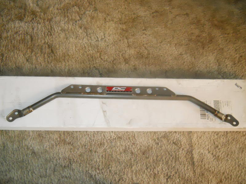

Here's a pic of the bar I'm thinking of mounting.

yes, i just read the thread. The OP is mistakenly calling a strut bar as sway bar. This seems to be a 3-point strut bar (can be found on the 3rd generation Miata as well. It is supposed to be stiffer than the normal 2-point strut bars, since it bolts to the firewall (however, it depends on how thick the firewall is...)
I am not sure if the mounting points are the same dimension, though. I know that installinga DC5 LCA will increase the track width in front by 15mm (might warrant a RSX front sway).

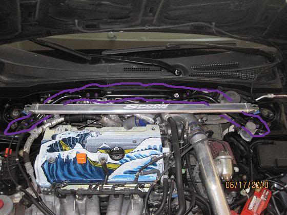

Anyway, this front Sway seems a very odd design... I suppose the part circled in red that the guy did cut out because he did not need it, well, that was actually the link to the spring? that was actually what it made it work as sway bar? Not sure how it would make it work as sway if it is tightly tied to the towers... I will need to take a deeper look at that... Seems very interesting concept - never did look at an RSX that closer... Always preffered the ol' integra...
Thanks, you have hooked this ol' fart... Mechanical engineer senses at full throttle. Very interesting . need to dig some underground japanese sites (if they are online, i mean...) Argh! your fault!

I would have two bars, basically the set-up in the pic except on my em2 instead of a dc5.
