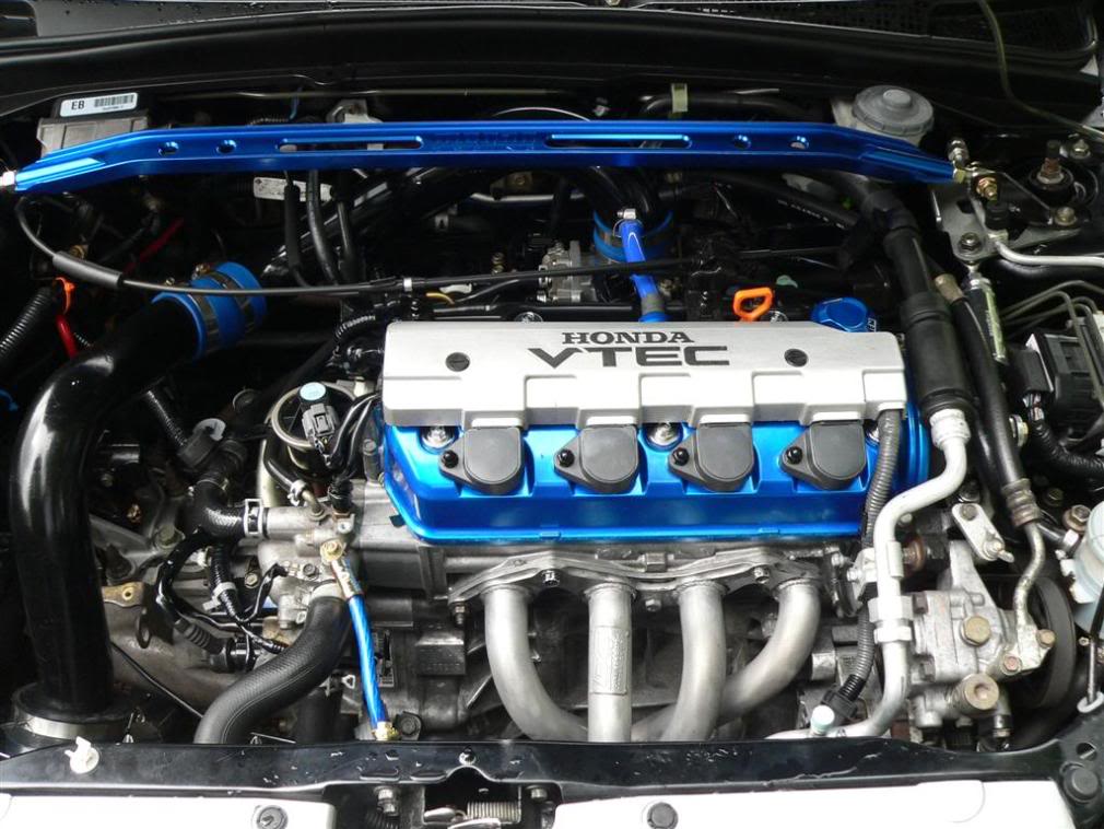

Well sure you could take it out if you were running an intake, but the idea is to be able to run both the intake and the strut bar. You can run that bar if you do a couple things.
Rotate the bar forward and use a hacksaw to trim a little bit off the intake pipe so it sits lower.
Like so:
