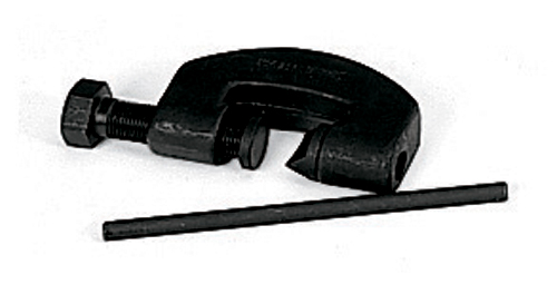

thanks guys....one question though.....what should i use to cut the nut off, is there a special tool or just use a hacksaw?...thanks

Re: Help need suggestions
Use a nut splitter....
