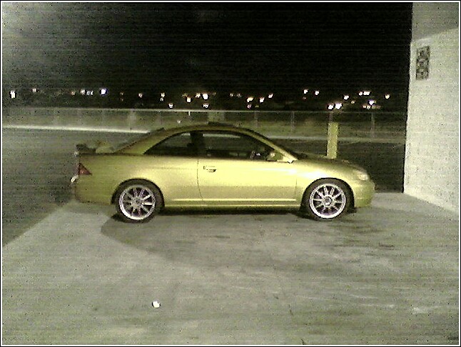

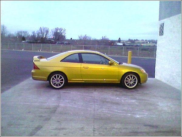

Update - I Got-R-Done this morning, took out for a test drive...Nice
I broke two ratchets trying to loosen the lower strut tower bolt on the Passenger's side...****
Took to get an alignment today, I did pretty good for eyeballing it
-1.2 both fronts
-1.5 DR -1.6 PR
After alignment, the fronts were -.4 and the rears were -.1
Had to roll the fenders...wenches were rubbin' hardcore. I'm taking it back in a couple days to fix it pulling to the right...and to dial more rear camber in
Before pic:
Name:	Civic before.jpg
After pic:
Name:	Civic lowered.jpg

When I got back from test driving it, my fiance was standing outside. I asked her if it looked good and she said "Honey, Not to be mean, but I can't tell the difference..." So I had her come and try to sit in the passenger's seat. When she went to get in, she was used to what height the seat was, and she hit her head...
"Okay, Now I can tell that it's lower..."
