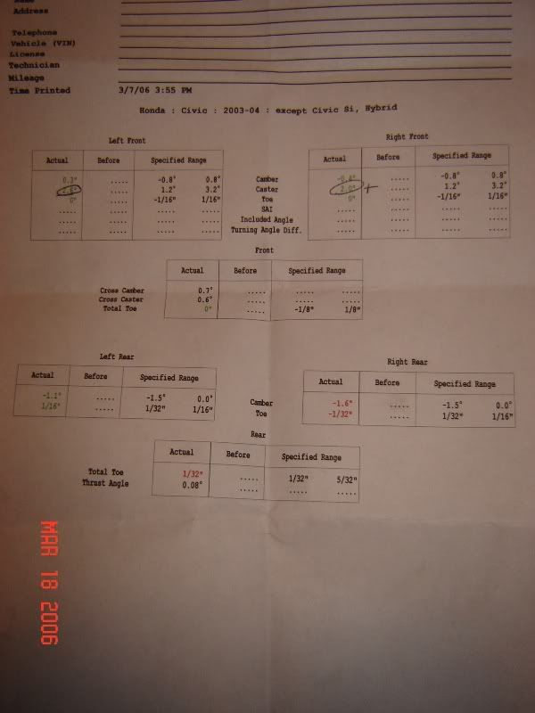

ummm bump guys...lol but i have the EXACT same problem as cubanmike 26...........heres my alignment specs..

If your problem is that its pulling right its most likely NOT the alignment causing it from your printout. You have a caster lead to the right and a camber lead to the left so it SHOULD drive pretty straight. And as far as Honda covering the alignment you have a snow ***** chance in hell of that happening. Alignments dont go out of spec because of a factory deffect. 99.99999999999% of the time its do to the driver/road conditions
