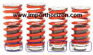

in the pic i attached, i marked with blue, you take the two spanner wrenches and twist them upward (so its moving right).
twisting it left - drops lower
right - raises higher
as soon your set on a ride height, you HAVE to tighten the 2 perches together. meaning you take one spanner wrench (which come with the coiloves) for the top perch and twist it LEFT, while taking the other spanner wrench for the bottom and twisting that RIGHT. so you're basically tightening them together so it sits still and wont slide. if you dont, it will eventually slide downward (get lower).
when/if you raise it, let me know how it rides. im not sure if i can feel any difference if i slam or drop a little. can someone clearify?

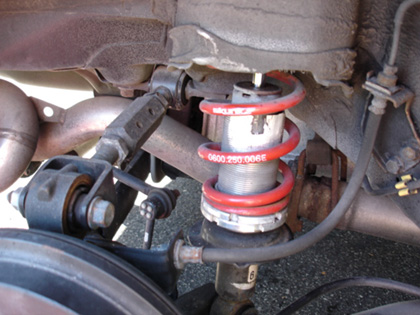

what does this mean then? and why are the threads stripped?
also, he said i need to have the bumpstops re installed, as he took them out for the last show. how expensive is that usually, and will it raise the car at all?
i really appreciate the help!

From the looks of your picture, the springs are on the lowest setting. You have to move those up to raise the height.
